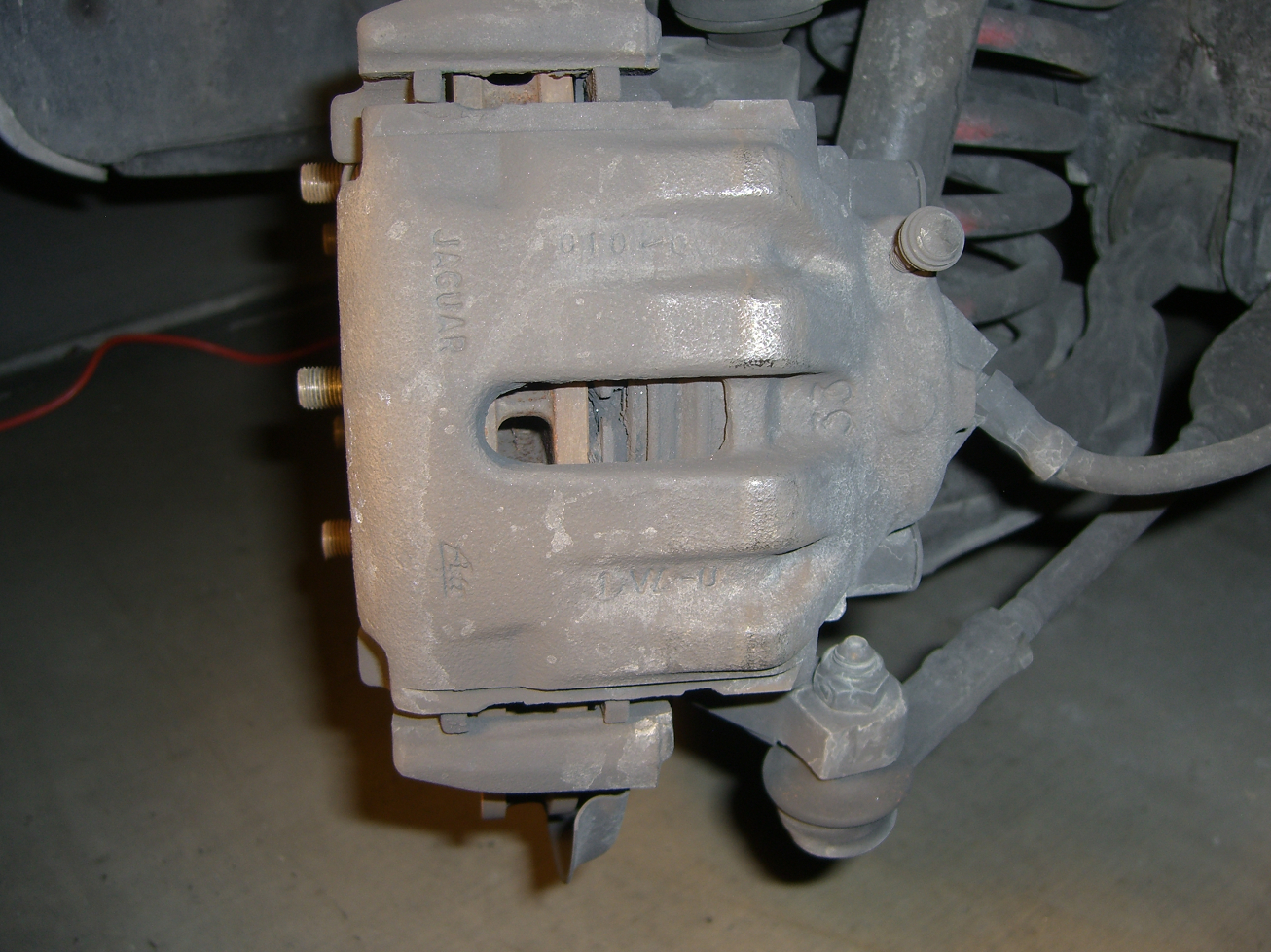

I say it oft, but most don't listen. Premature brake pad wear is contributed to caliper piston seals. A caliper seal replacement is the most overlooked, and most needful in any brake job done right. The purpose of this seal between the piston and caliper is to retract the piston, and sealing is the secondary purpose. The rubber is crushed and stretched every time you apply the brake pedal. There comes a point where it looses it's shape and no longer retracts the piston back rewards into the bore. Which means there is pressure against the pads to rotor at all times. Also, you should never collapse a piston back into it's bore without breaking the bleeder screw loose and allowing the contaminated fluid escape, especially if you have ABS. The contaminated fluid can cause ABS failure. Brake fluid is glycerin based and hygroscopic, (which means it takes on water) and should be replaced every two years by the maintenance schedule, and by reason of the vehicle being in the atmosphere, it takes on water. This is what causes rust in the caliper bore behind the piston. Never use brake fluid from a can that has been opened and the seal broken for some time. When you do a brake job properly, you rebuild the caliper, clean and lube the pins, replace the associated springs and retainers, replace any and all rubber parts as well as pads and rotor maintenance. It will include new fluid and a bleed. If you simply smash the piston back into the bore and slap pads in you have not done a brake job.

I Doubt Jaguar or most mechanics rebuild the calipers during most brake jobs. Wouldn’t that increase the cost by quite a bit? Years ago I had that done (to a company car) after repeated premature wear on just one side. Wouldn’t it be unusual for both L & R front brake pads to wear twice as fast due to hanging caliper on both sides? In any event, I will ask about caliper seal replacement when I go in Tuesday. (I’m guessing they would only replace the caliper seal as part of an expensive caliper rebuild.) I may have the brake fluid flushed & replaced since I don’t think they do that as part of routine Jag brake job (pads & rotors). Years ago, I was told by a mechanic that here in DRY Phoenix, AZ, brake fluid does not absorb water as it does virtually everywhere else so, changing the brake fluid every 2 years is a waste of money. I know the Jag manual says every 2 yrs. Regardless of mileage.

I decided to pull a wheel (LF) & take photos of the brake pad. Once again I can clearly see the pad is thiner than the backing plate (Although I do not know if it is really @ 1 mm, It surely needs replacement.) Looking through the “window” to see the inner pads, I’m not sure wtf I’m looking at. I s/b looking edge on @ the rotor, pad & backing plate. I think the black grime/dirt is throwing me off.
Here are the photos:
Bob,
I invite you to examine a seal from a rebuild pack and one taken out of a caliper with a few years service, and what you will find is that new one, is rather hard, sharp edged and not very resilient at all, and then the one taken out of the caliper, will be stretched, rubbery and much larger in diameter than the new one. It will feel like a rubber band. Why is that? Because of the tremendous pressures, heat and wear upon this one single critical moving part that retracts the piston. This should be part of every complete brake job.
I invite you to read the following... http://www.ucx.com/documents/squareseal.pdf

My concern is that rather than Front pads lasting 30K miles as they have done with this car & me as sole driver 2x b4, now last ~ 50% & not sure why.
Brakes are done although car still in shop awaiting A/C part (drier) I had them flush/replace brake fluid. Afterwards, they told me old brake fluid was somewhat clumpy so that maybe it contributed to premature front pad wear. (I’m not at all sure that could be the case but, brake fluid needed changing anyway.) (Looking at brake fluid in the reservoir, it had looked clean & translucent to me.) He assured me that Jaguar Service techs clean & lubricate calipers very thoroughly & than mine are fine, better than new (Whatever THAT means) I don’t want to rebuild/replace calipers ($$$$) unless I know they are the problem & it does not look as if that is so. I will ck pad thickness when I rotate tires probably 12-2015.
@ Box, thanks for the interesting article & your comments. While it may well be a good idea to replace or at least rebuild brake calipers every time you change the pads, the source you cite is a company that sells calipers so, not exactly unbiased
Maybe some others that read this thread but have not commented can weigh in on replacing or rebuilding calipers rather than just cleaning & lubricating them every time pads are changed. I suspect that those few who may do this, do the brake job themselves rather than pay mechanics to do it for them as I do. I assume if there are tangible signs of a problem with the calipers such as one side wearing faster or inner vs. outer wear not even, or when examining calipers seeing other issue then a rebuild or replacement is done. But, if everything seems fine except the pads wear much faster than b4 (& are the same OEM Jaguar pads) then how many would just replace or rebuild calipers?

David,
I was not accusing YOU of trying to sell me anything. I appreciate your comments & the info you provided & thanked you for it. You’re right, UCX (sells calipers) did not do this study but, just listed the results & cited 7-1997 Brake & Front End Magazine. I don’t know who did the study. However, sometimes people/companies selectively report studies & other info that benefits them. Study states 62% shorter pad life when pads only replaced vs, replacing pads + calipers. Then the rest of the article (which answers the “WHY?”) is , I assume written by UCX.
You may well be right although I question the 62% shorter life. Will virtually every car experience more than double the pad life if calipers are replaced? If so, since the vast majority of people do NOT do this & most mechanics do not recommend this, I would expect most people to have drastically shorter pad life on the 2nd brake job vs. The 1st. Since the 1st starts with new calipers, new everything since car is new.
Why don’t we hear about people getting 50K b4 need pads & then they merely replace pads & turn rotors & then in 25K miles need pads once again?
Or get 30k & next time only 15k or worse 20k & then 10k?
In no way is Jaguar Service either fast or cheap.
Lets hear from other mechanics. Do you always recommend replacing calipers every time pads worn down even if worn evenly & no evidence of any caliper issue? Or do you just clean & lubricate calipers a part of std., pad only brake job?
What is the cost/benefit analysis? Maybe that holds the key to why it is rarely recommended. Probably very dependent on which car, more for Jaguars, BMWs, Porsches, etc.
Rip-Off #1: Buying calipers when you don’t need them

I searched quite a bit & other than you & the link you provided I cannot find anything else recommending replacing calipers with every pad change.
For my Jag, I got 30K from factory new brakes, I also got 30K from 1st front brake job; pads & rotor. Only with my current 3rd brake job did I get much less pad life. I pick up car today. Tech claims he cleaned & lubed calipers & they are better than new. We’ll see.

I'm not new to the industry, and was in the Parts and Service Division of a major auto manufacturer for well over a decade, been in the industry since the 70's and trained technicians for Ford, Toyota, Subaru, Chrysler, GM and numerous independent owners.
I can lead a horse to water, but sadly, can't make it drink. What amazes me, really, is you ask what is causing your problem, I tell you, and then you want to argue the issue. All I can say at this point is good luck..

Hi David,
I think we are basically repeating ourselves.
However, the study YOU cited & linked states “Caliper Replacement” (I.E. Complete brake job.)
It does NOT talk abut rebuilding the calipers or replacing the seal. However, you have discussed replacing the seal. So, you can re-read all my previous comments re replacing the calipers as also meaning rebuilding the calipers.
Most mechanics do NOT recommend this unless they see a specific problem. Jaguar does NOT recommend this. No mechanic has ever recommended this to me for many decades of driving many cars. (Except once when calipers were hanging & one side wore much faster than the other.)
Yes, I asked the forum a question about why my pads wore 2x as fast.
No, you did NOT tell me what is causing my problem. You guessed. Perhaps an educated guess but, Jaguar service disagrees with you. In no way, shape or form have you proven you are correct & that every single brake job should include replacing the seal/rebuilding the calipers. Repeating your “horse to water” analogy does not make you correct.
Too bad no other Forum members are commenting on whether or not they rebuild their calipers or replace their caliper seals every single time they replace pads.

Read in what you want, but my comment to you from the first was, and I quote, "A caliper seal replacement is the most overlooked, and most needful in any brake job done right. The purpose of this seal between the piston and caliper is to retract the piston, and sealing is the secondary purpose."
In about 2 years you'll remember this thread. Have a great day.
