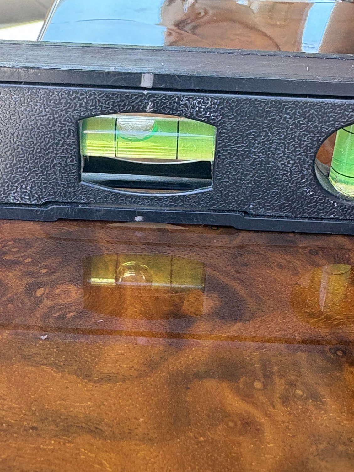

Yes, that seemed to help although unless I move the seat back vertically STRAIGHT, It’s still not “level” and the ground is.

You were correct. However, as I mentioned to @Randy S, unless I adjust the seat perfectly vertical, they are still not level. I don’t sit vertical. I admit I have a little gangsta’ lean when I drive the sedan. The 911…. Well, different angle of attack.

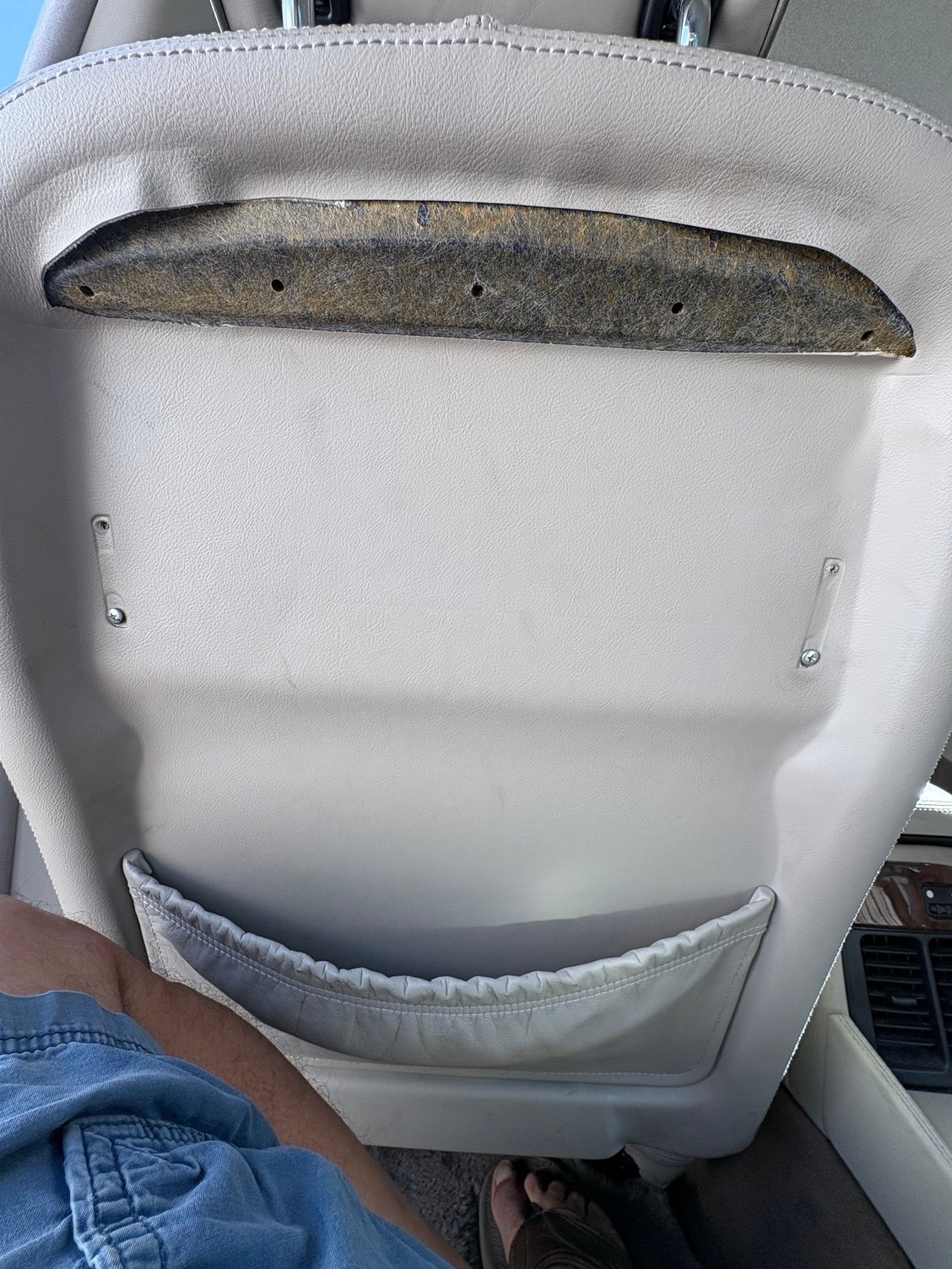

BEFORE Picture: The previous owner had installed VDP seatbacks but, the trays were missing. I removed and reinstalled the trays from another set of seatbacks. The trim color on the lower tray didn't match but I can have that professionally shot with matching paint. I couldn't find trays with Oatmeal trim.

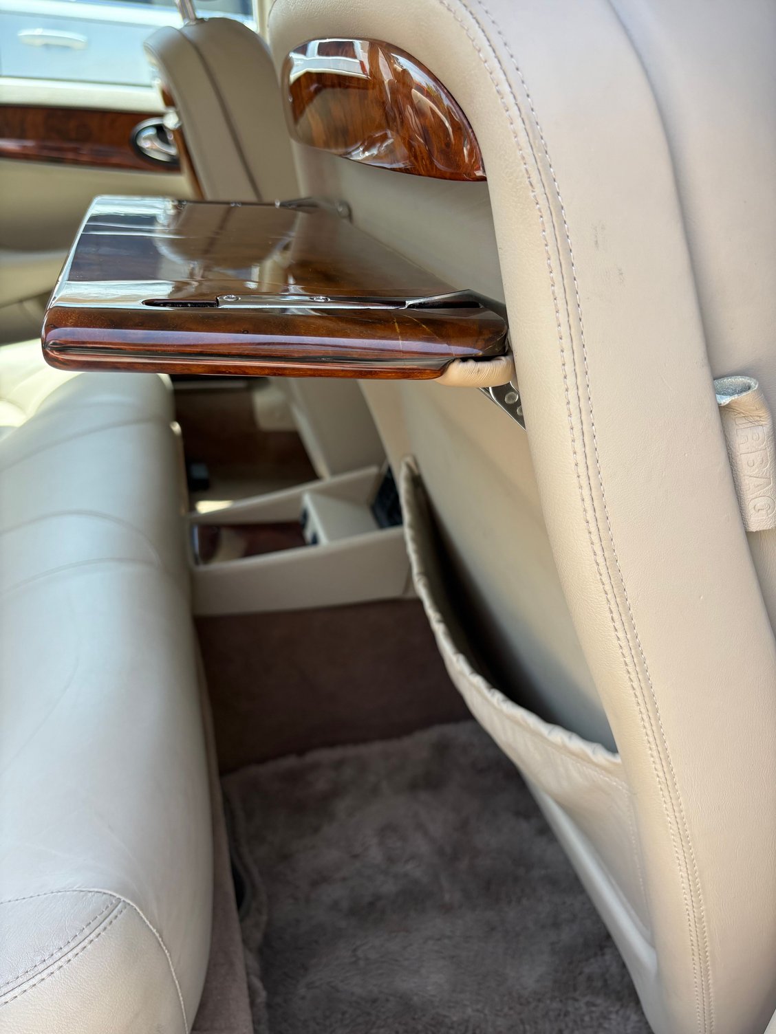

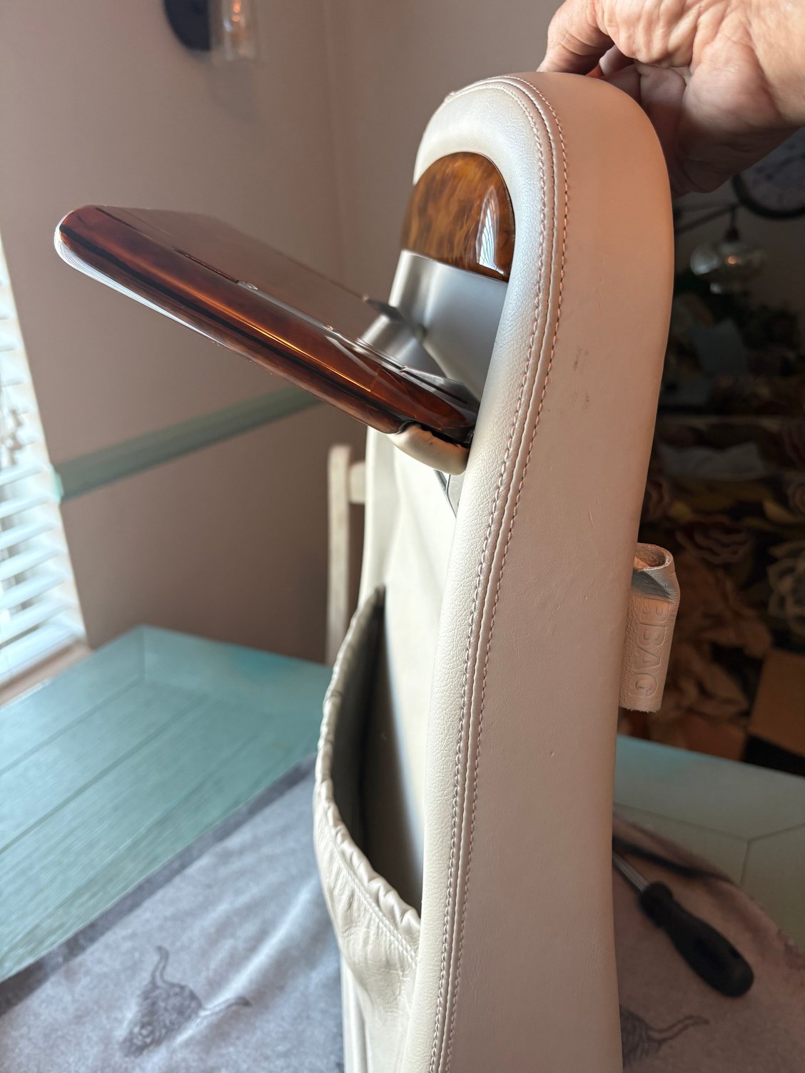

The hinges are NOT out of whack but tray still angles
The hinges are NOT out of whack but tray still angles "up"

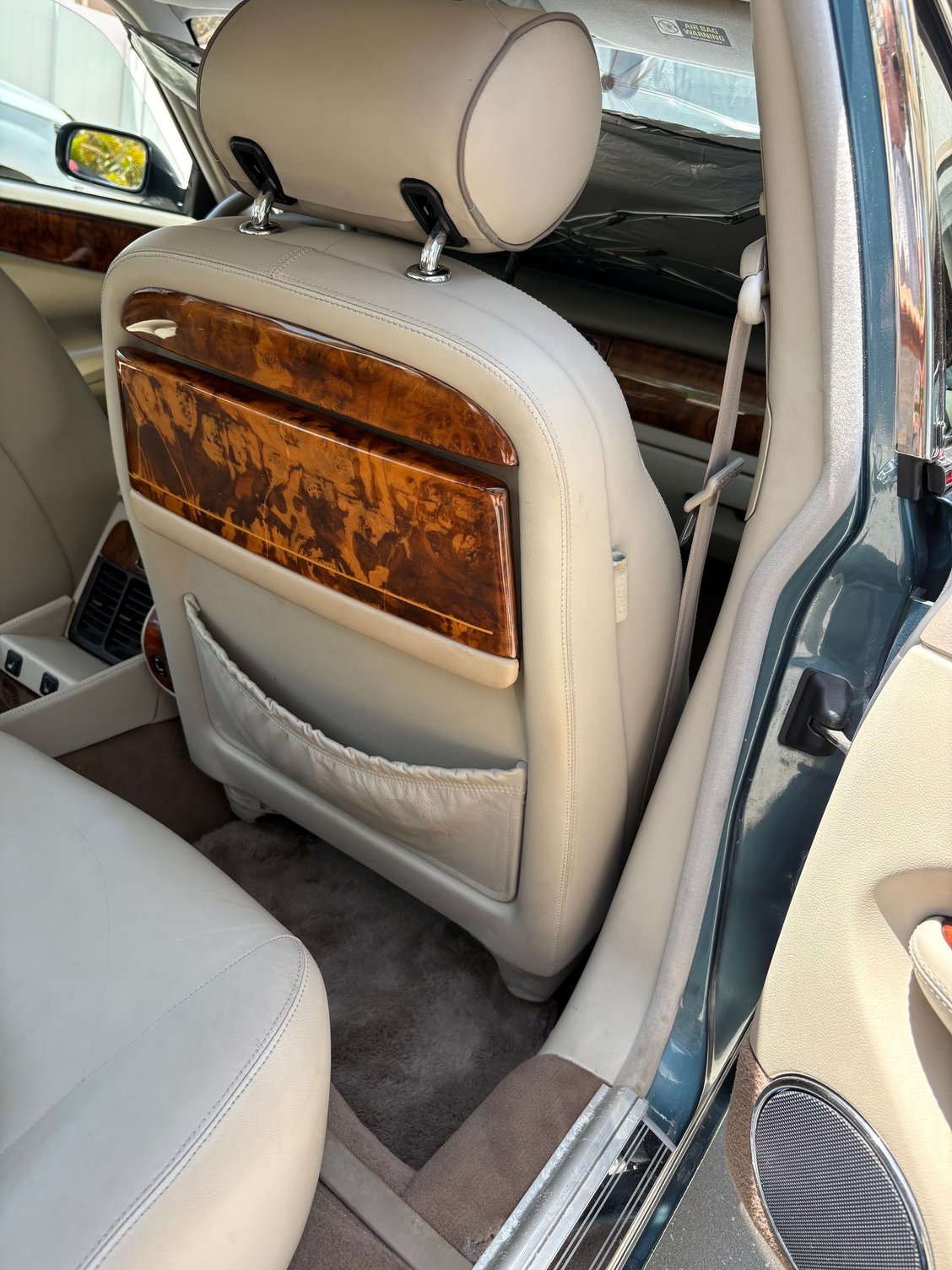

OCD clearly visible.
