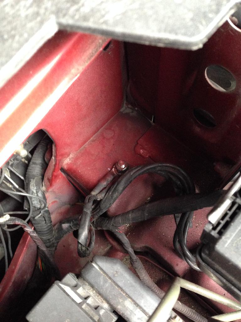

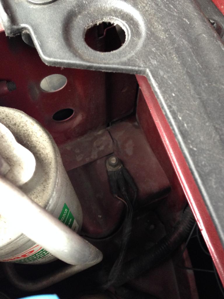

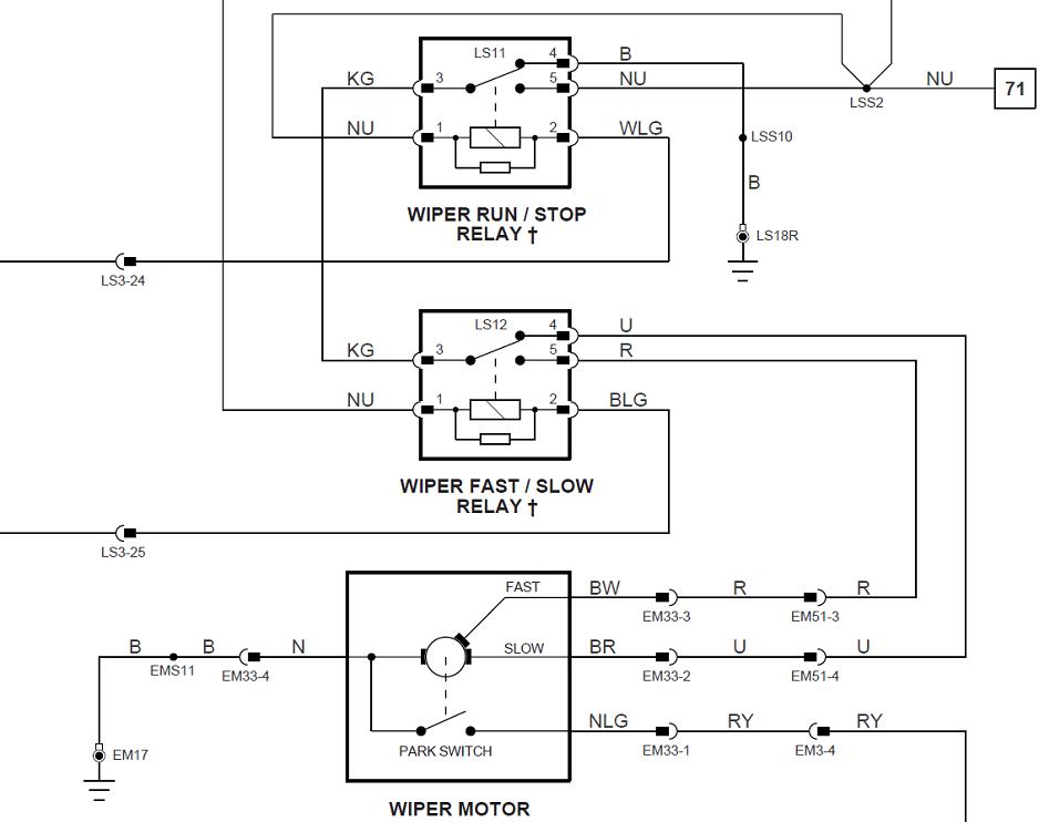

OK, I think I may have it. The wiper circuit shares a ground stud with the headlight circuit.
The lug number is LS18, and it lives in the left front corner under the hood. If that ground is poor, what happens is the headlights are trying to find a ground through the wiper motor.
Check out these pictures.
http://i336.photobucket.com/albums/n...ps7b13044c.jpg
http://i336.photobucket.com/albums/n...ps56c4a260.jpg
http://i336.photobucket.com/albums/n...ps3bffe050.jpg
With the car turned off, remove and clean up the grounds with steel wool or sandpaper. Let me know if this helps.

No, I don't think so. I think the ground for the start stop relay is bad, and since it shares the ground with the lights, you are getting power to the wiper through the relay.
[IMG][/IMG]
Chase after the grounds, and trying using jumper cables like I said to ensure those wires are truly grounded.

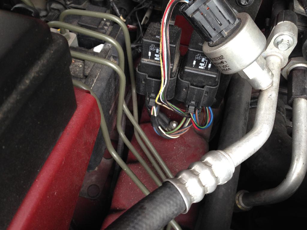

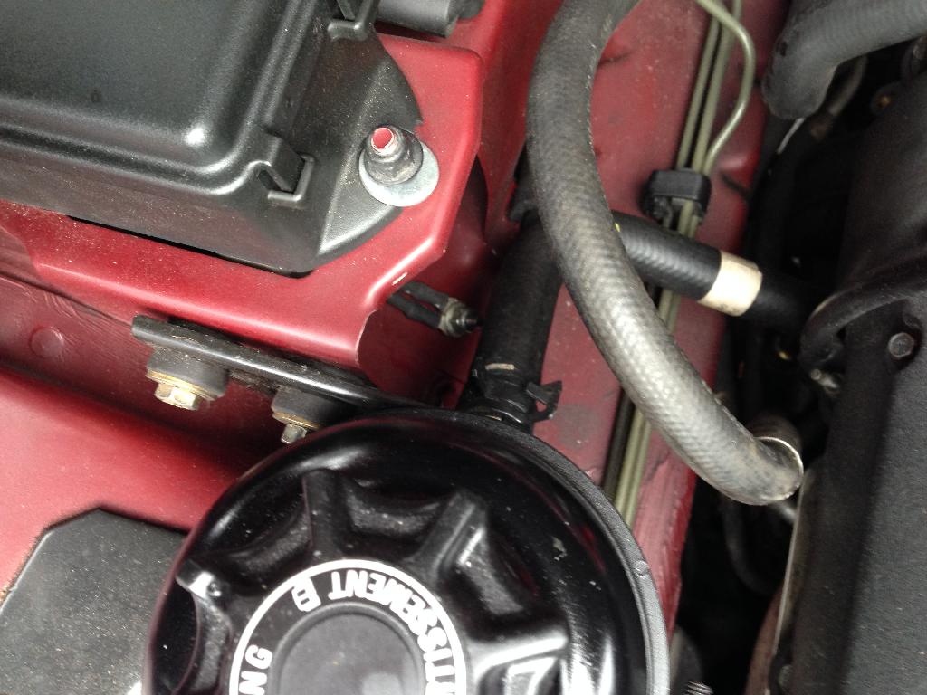

Here's some shots of the grounds on my XJR.
The left side in the the first 3 shots:
[IMG][/IMG]
[IMG][/IMG]
[IMG][/IMG]
And the right side:
[IMG][/IMG]
Attached Thumbnails Wiper turning on when lights and fog lights on HELP-c805b550-90b3-4f0f-be0f-2d4c8176eea1_zpsoak5zu4c.jpg   Wiper turning on when lights and fog lights on HELP-feb37cef-e254-4288-853a-b233c824e31f_zpsdaabfgk2.jpg   Wiper turning on when lights and fog lights on HELP-3a635cd9-475d-4fdf-86b2-17a308425e8a_zpsseuyyiqg.jpg   Wiper turning on when lights and fog lights on HELP-a5974cb6-6e6d-40c3-a8c0-89896d89fe16_zpss3nfxip1.jpg
