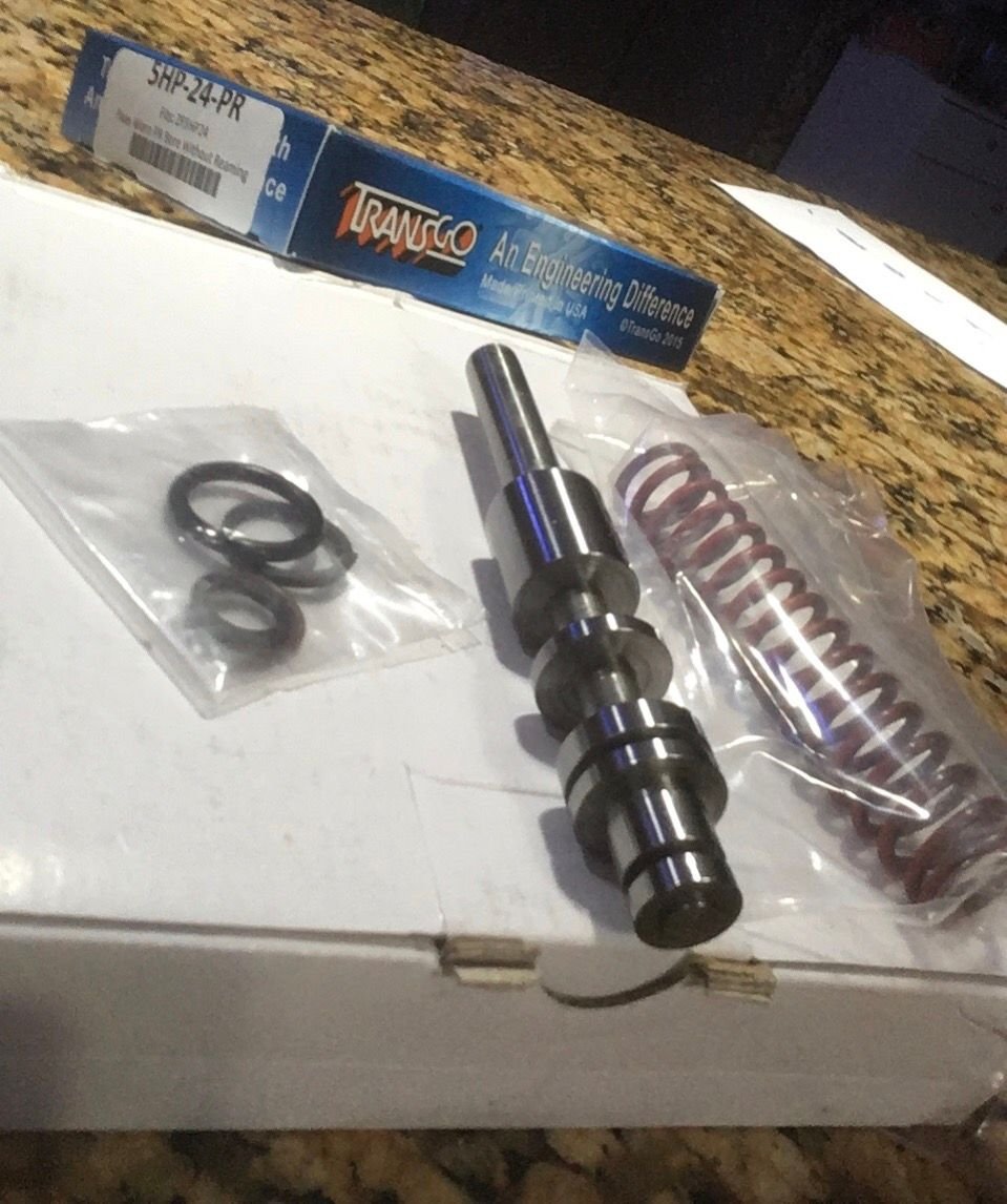

The flush will take care of the noise you have when the TC locks up. If they have the machine there, it’s actually called a transmission fluid exchange. “Flush” vs “exchange” both have the same set goals, to replace 100% of the fluid but with different methods to replacing them.
Having them replace the PRV is most definitely a preventative and a serious piece of mind in protection against A drum failure.
On a properly operating transmission, you should see about a 500 engine rpm drop when the TC locks up in OD above 45 mph. If you’re seeing more like 200 rpm’s, it’s likely that your TC clutch is slipping and causing that noise you hear.
This is the PRV from Transgo that will go in my wife’s low mileage 00’ XJ8 very soon.
