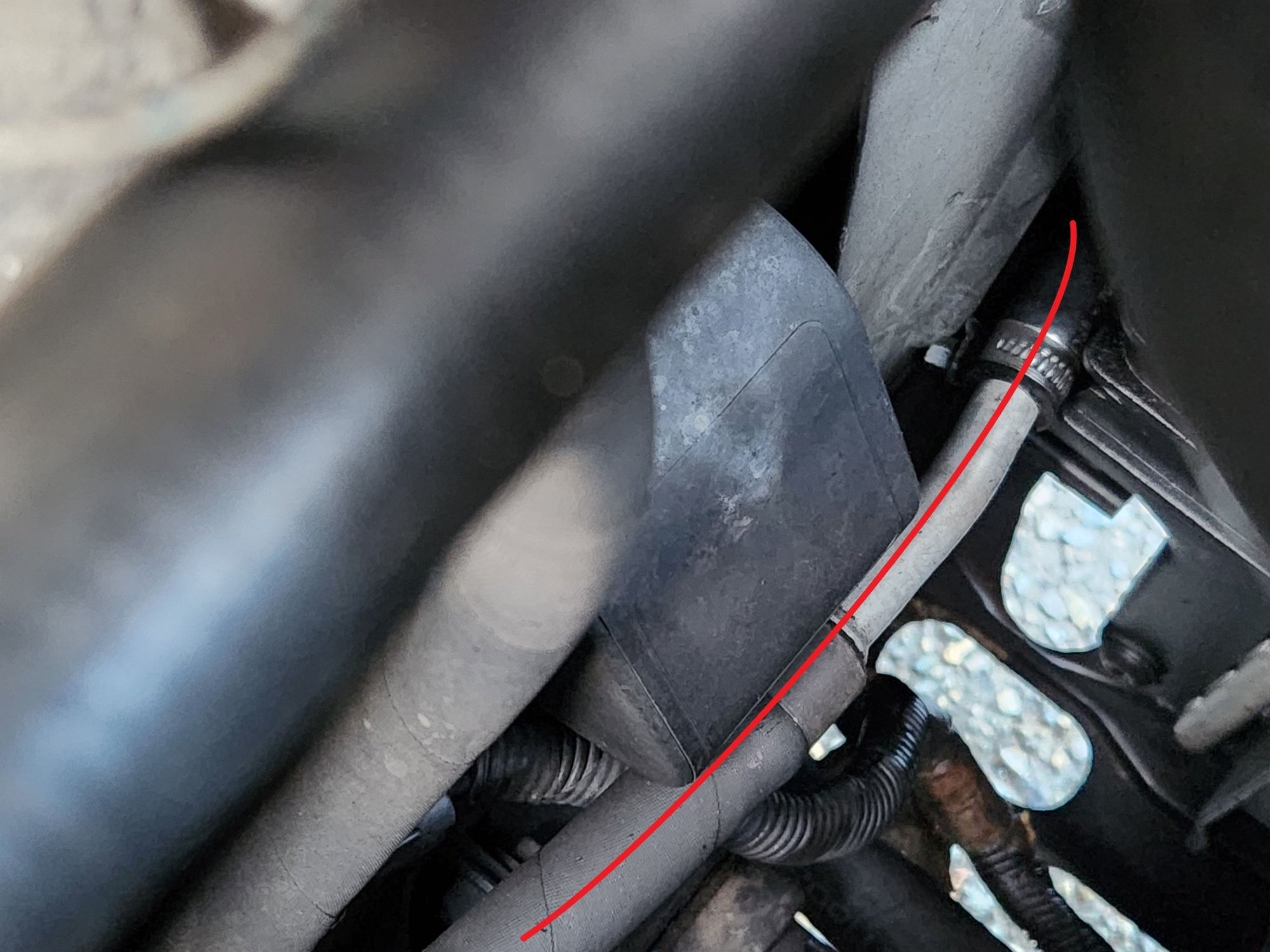

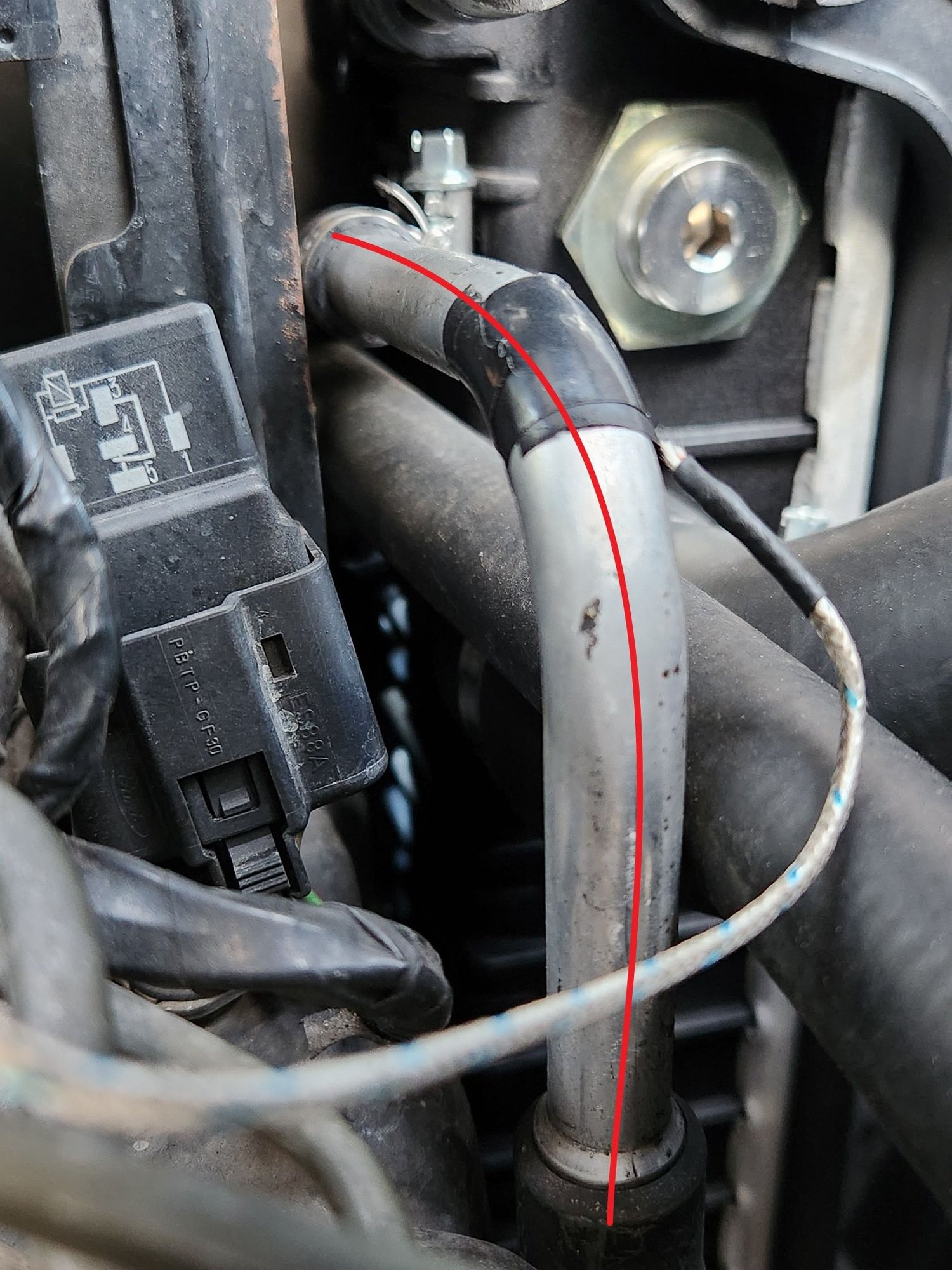

The mechanic was going to put an inline cooler in place, just after the return from the radiator, but we agreed to bypass the radiator entirely because the initial problem is caused by the radiator itself (not due to flow though).
The both the in and return pipes were cut and hose clamps were used to secure the hoses to the external cooler (as you suggested)
This is the return transmission oil cooler line. Just in case you're wondering there is a thermocouple attached to the pipe to get a temperature reading.

This is the in transmission oil cooler line.
