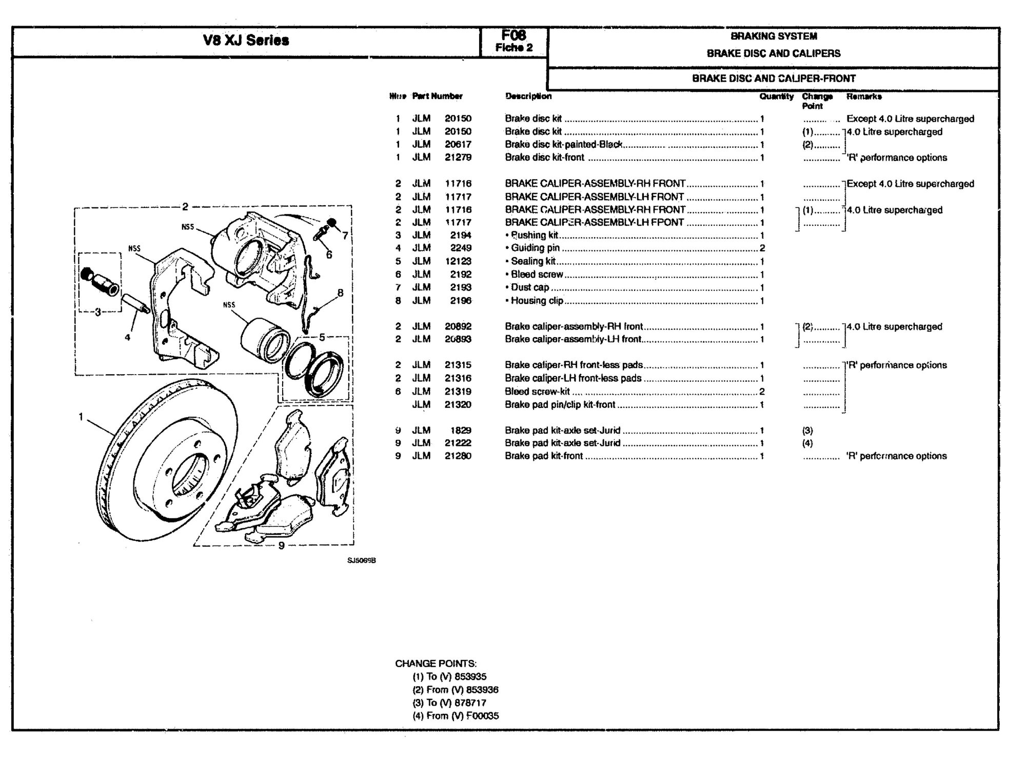

On the non Brembo equipped R's, do the sports and R's have the same brakes?
Old Sep 10, 2019 | 02:35 AM
M. Stojanovic's Avatar
Joined: May 2017
Posts: 1,699
Likes: 898

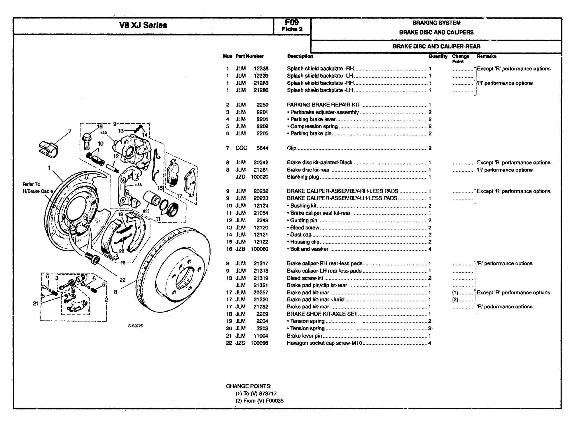

I understand that with "R" you mean XJR and not the 'R' performance option of the brakes. You can check it out on the parts diagrams:
