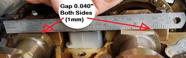

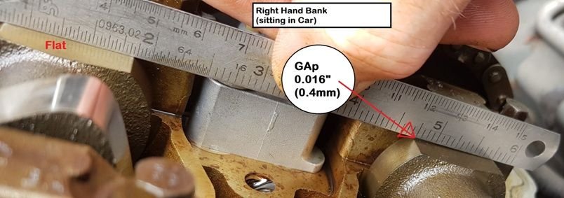

Right, removed Cam Covers and this is what I have found, this is the right bank lined up on one side!
There seems to be a bit of follow on and Backlash on the tensioners, but that might be to do with the car not being run properly, so the tensioners are not hydraulically primed.

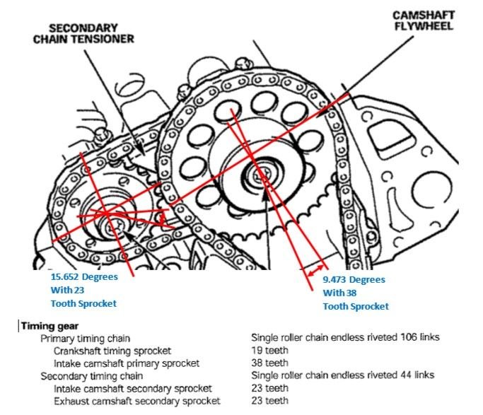

I also looked at the Sprocket setup on the Camshaft Flywheel Sprocket and Secondary Chain Tensioner Sprocket, best picture I could find!
So, the amount of gap that is on each bank of camshafts is definitely not 15.652 degrees out, I dont think its jumped a tooth, what do you think ?

Turn the left bank 2* and it is flat! Right looks just fine. For now, I think you can rule out timing.
