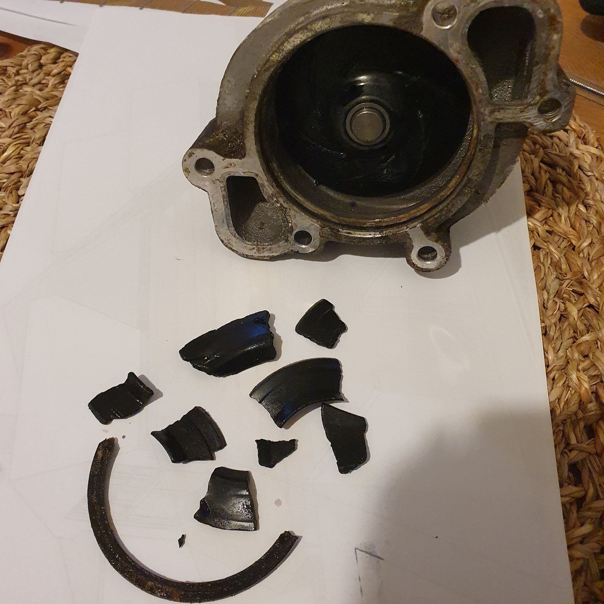

Last week I was out driving, been on the road about an hour, speed about 70 mph, suddenly after speeding up, revs about 2500/3000, the revs wouldn't drop back down. First thought was what's wrong with my Autobox, so I tried to speed up hoping it would kick in and drop back to where it should be, no joy. I then looked at the temp gauge and it was at the top Red mark - overheated. I pulled over onto the hard shoulder, waited for pick up.
Yesterday I put my OBD on, no codes visable. Turned on engine, ok, then waited for warm up, both fans kicked in. After 15/30 minutes car warmed up, temp gauge at normal position, never moved.
I did notice the in out/in pipes going to the radiator were not both hot. Right pipe( sitting in car) boiling hot, Left pipe luke warm.
Is this a thermostat problem, which case I'll do a new stat, water pump ally upgrade as its still plastic, or something else. Is there an additional Auto Box problem due to the revs issue.
Thanks for any advice

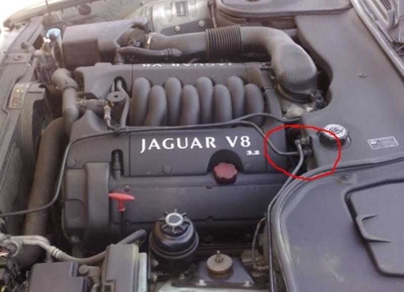

Yep aj-v8 is the v8 engine on Jags. When thermostat is housed and hosed to the top hose it releases the hot coolant to the radiator.Then lower hose is somewhat cooler becauset radiator is in between.

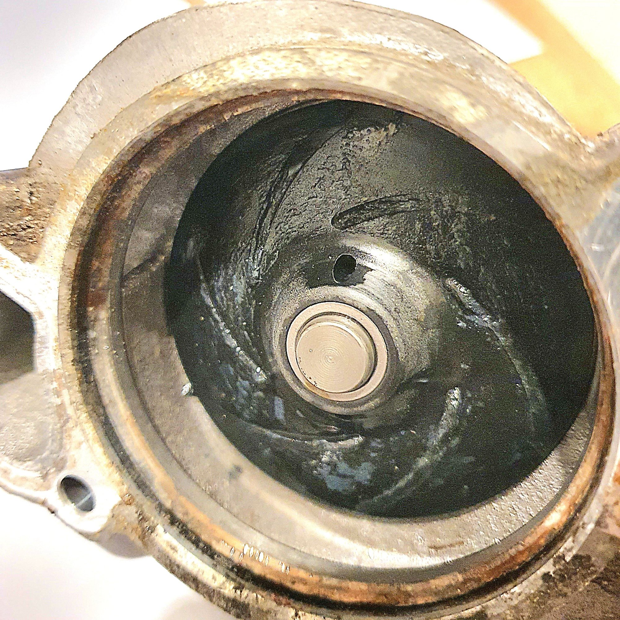

Your owners manual would have specified a Jaguar part number for a coolant that was either Dow D542 (colored yellow) or Dow D985 (colored blue/green). But in 1999, Jaguar revised its coolant specification to Extended Life Organic Acid Technology (OAT) coolant meeting Ford specification WSS-M97B44-D (colored orange). See the attached TSB. The most commonly-available OAT coolant that meets this specification is GM DexCool, available at most auto parts stores, Walmart, etc. Prestone, Zerex and others make DexCool equivalents.
One published limitation of OAT anti-freeze is that it does not protect metal water pump impellers from electrolysis or cavitagion erosion. This is the reason that Jaguar and other automakers began using plastic impellers. The last time I checked, Jaguar was still selling plastic-impeller water pumps as replacement parts (these pumps were made by Ford OEM Airtex).
Many of our members have used water pumps with aluminum alloy impellers, and so far, I don't recall anyone reporting a failure due to a lack of protection from the OAT coolant. So it may not be the big deal the automakers thought it was going to be when OAT coolants were introduced.
The one really important thing to be aware of is that OAT coolant should never be mixed with any other type of coolant (conventional green IAT or the modern Hybrid OATs (HOAT) and other variations) due to adverse reactions between the additive packages that can negate properties such as corrosion resistance and can lead to the formation of a precipitate or gel that will clog the heater core and other small passages and will coat the radiator heat exchange surfaces and reduce thermal efficiency.

Old Feb 9, 2026 | 07:34 AM
Jagger98's Avatar
Joined: May 2019
Posts: 80
Likes: 15
From: Hertfordshire, England
Old Feb 9, 2026 | 10:05 AM
