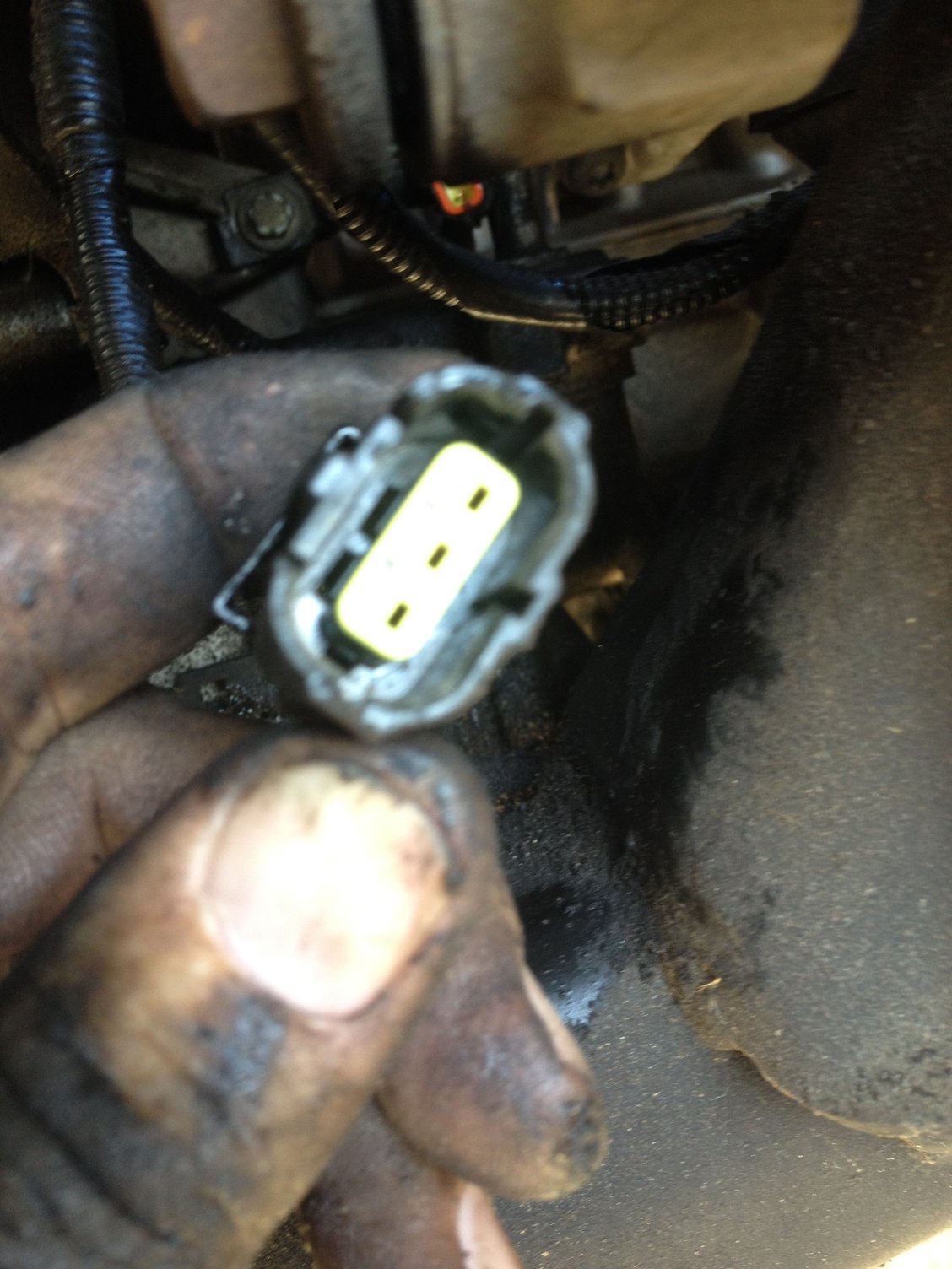

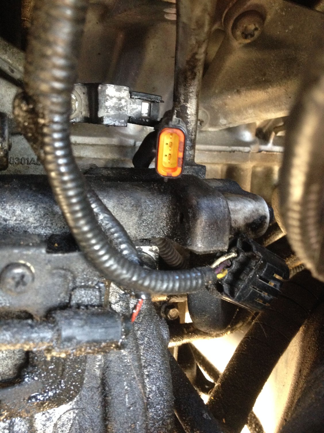

This is the sensor plug looks great
This is the sensor that has been removed
lots of oil & grease this engine needs to come out one day but let's get it going first

That connector does not look like it is for the crank sensor. The crank sensor has a 2-pin connector on my 1999 car. Or, if it is the early type of crank sensor, it may have 3-pin connector (I have not seen one of these).

P.S I did wonder about the 3 wires as only 2 are used at the sensor

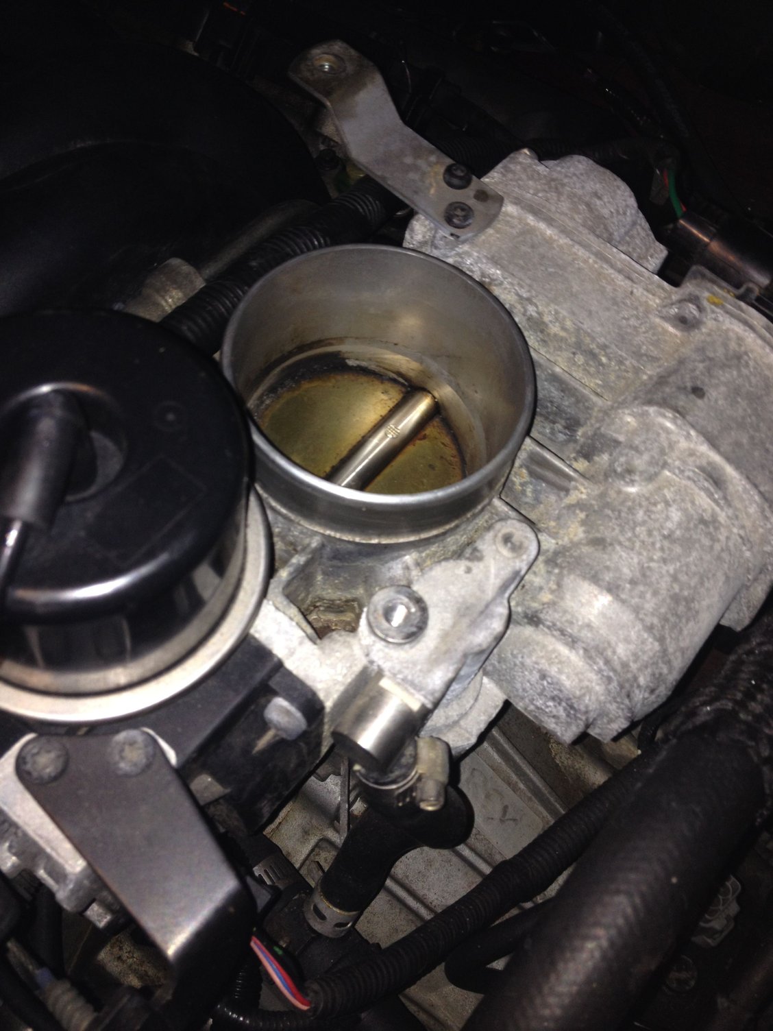

Ok Guys it has a cable see photos and a vacuum piece on top I thought the electrical servo was something to do with cruise control but I'm out of my league here
so what I know is that the butterfly does not open WOT ing pos II or any pos for that matter, which makes me wonder how is a WOT going to make a difference to air flow on start? or is a vacuum created on startup and the servo quickly responds
which brings me to the next question
if I connect the MAF and leave the air supply off the carby should I see some movement when I get the courage to crank again?
one last thing I could push it open a week ago but now it seems stuck does it open towards the firewall?
Dutchy
no movement on cranking
see the cable?

The black cylinder is the cruise control. The butterfly and the throttle body looks horribly dirty, maybe that is contributing to the problem. If it's not moving at all on the accelorator pedal, I think you have now found the problem. Can you move it manually or is it completely stuck?

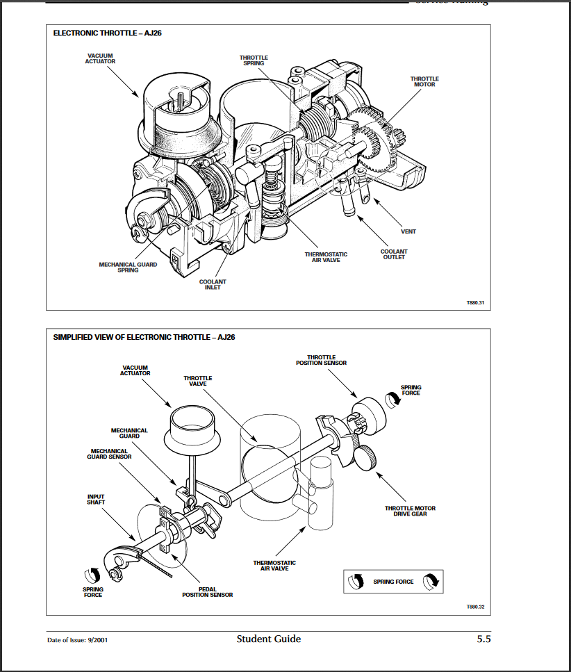

These diagrams may help. They're for the AJ27 - I'll see if I can find the AJ26.

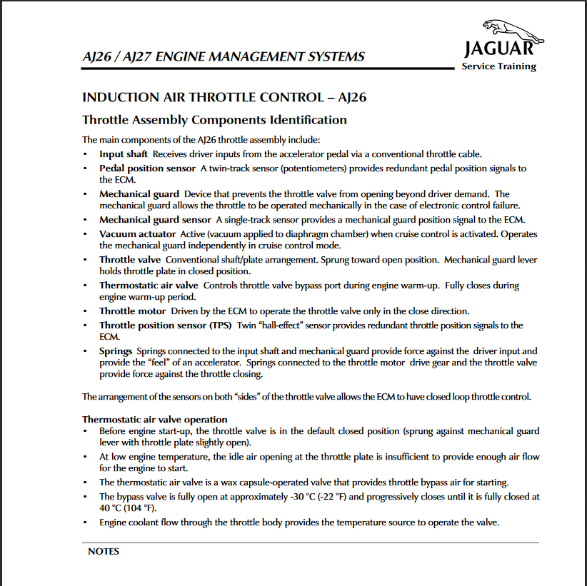

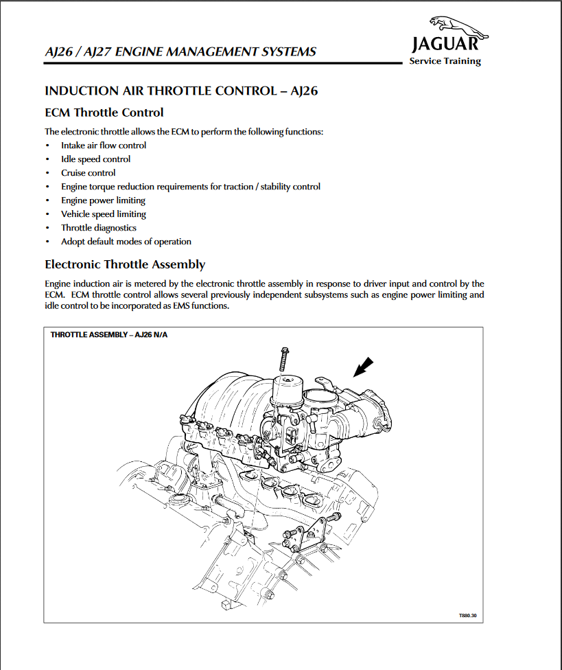

For engine management components applications, check this pdf (you'll probably want to start on pg 41)... http://www.jagrepair.com/images/Trai...ual-9-5-01.pdf
These are from that pdf (pgs 41-43)....

Thanks for the input will do what I can with the TB
I know that 2 to 3 weeks ago I did manually push open the butterfly and tried the aero start spray down the body.
and also Xjack asked for the readings open and closing the accelerator all was well then I give it a little tap to see if its stuck because no air no go!
Dutchy

I suppose that the day i asked you for TP reading and it responded to pedal press it was still in working order, so maybe the spray you used dialoged some crud and stuck the butterfly?
Does the input shaft rotate at pedal pressure? if no than it is binding somewhere before if it does move but butterfly not, than you could try few drops of lubricating oil on butterfly shaft
