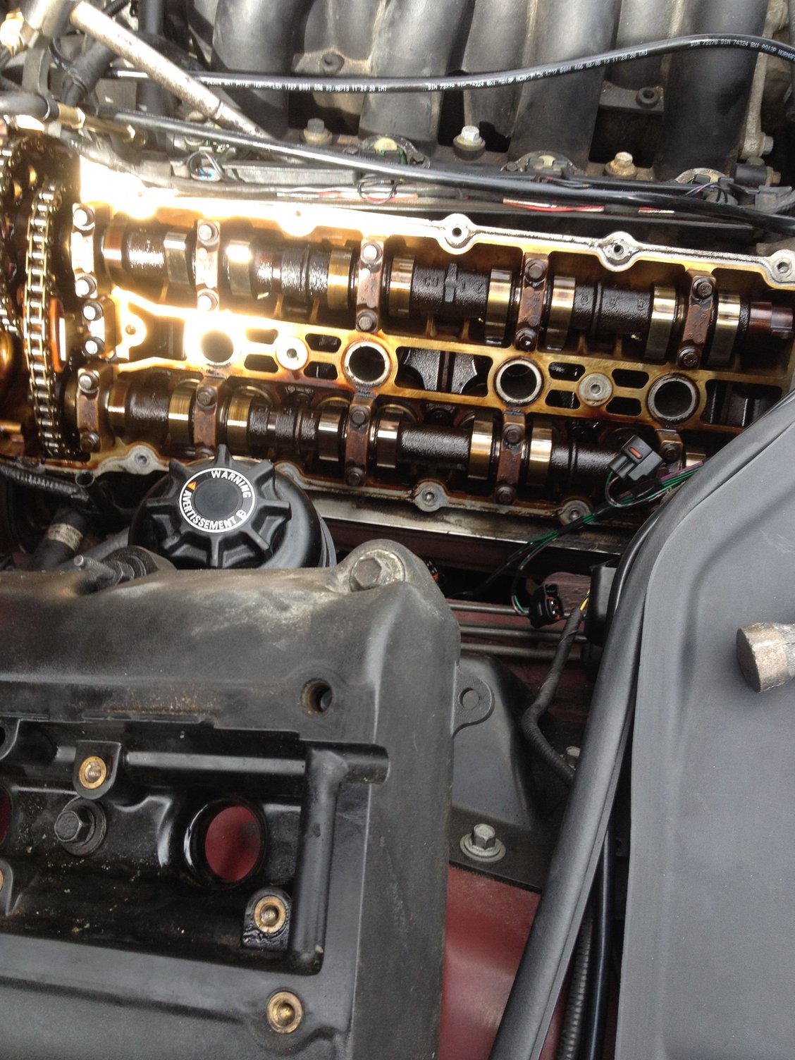

M.S I don't want to go down the road of timing covers and chains ect I really don't see why there should be a problem with that as it drove into the driveway
I did a post about the reason I took the car to the transmission shop.
A chain could have skipped on the first attempt to start the engine after it was sitting in your driveway. It is not difficult to check the cam timing. Remove both cam covers, rotate the engine slowly by hand and see whether all the flats at the fronts of the camshafts align at certain position of the crankshaft. The flats at each bank should align parallel and facing exactly up in relation to the plane of each head.
If you find any flat out of the described position, you should do a compression test to see whether you have any bent valves (or you can do a compression test first).

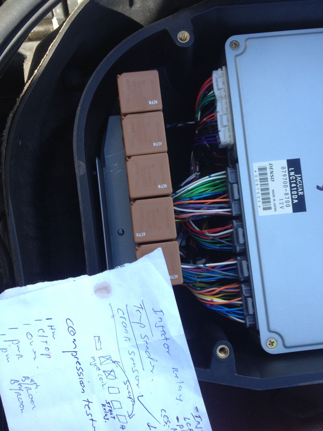

so where is the other relay in my diagram? it is not important at the moment any way? so i am swaping the ac and start relay and the ign and coil relay not that it will make a difference

A strong smell of fuel every time I try to start now
have a listen to this with 3 plus removed to make it easier on the starter
https://drive.google.com/file/d/1UKh...ew?usp=sharing
that's it timing why its out from coming home I don't know but will open up the cam covers so you guys can see

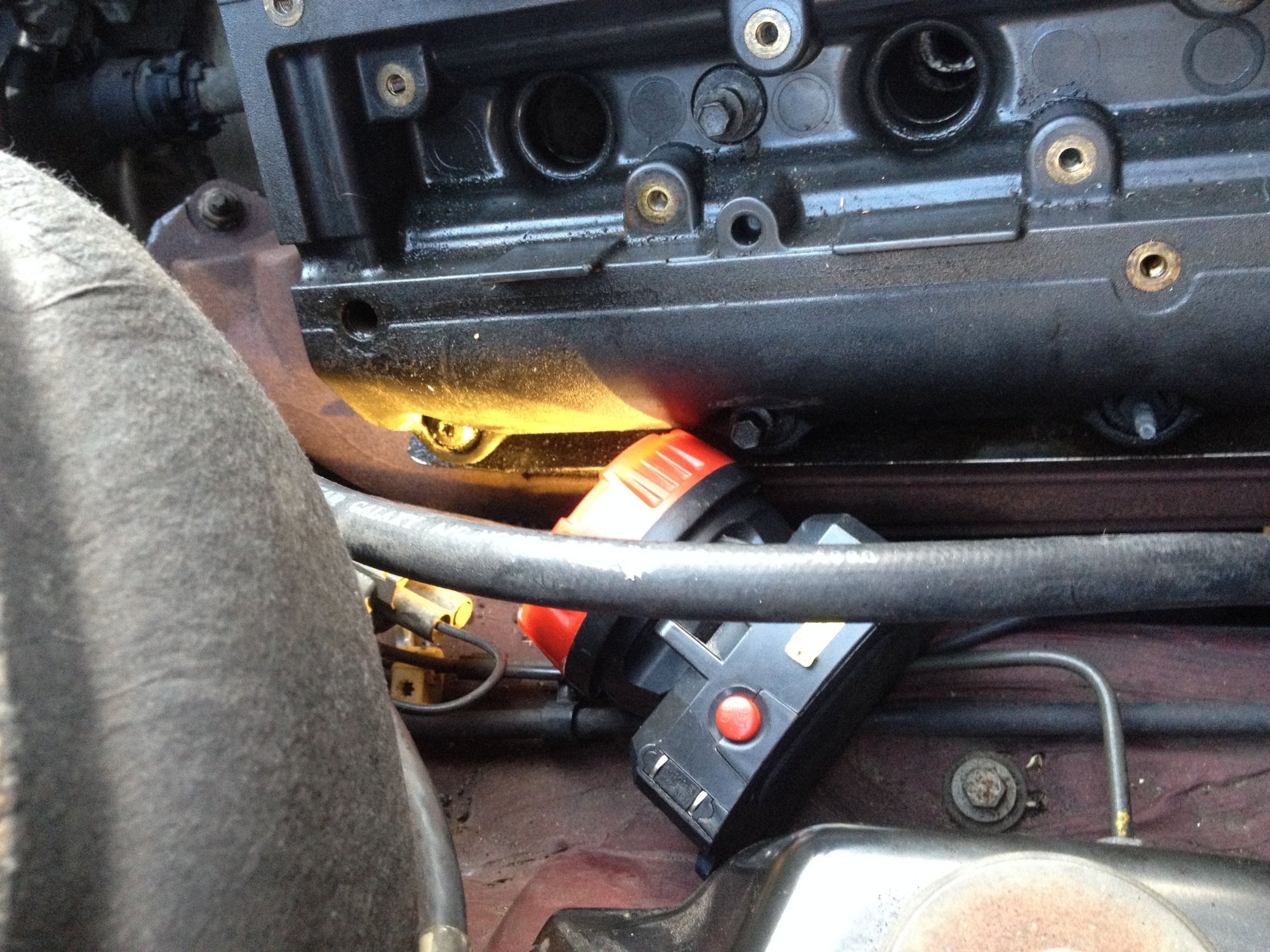

that bolt near the dip stick and the rear one near the firewall a person needs a 10 mm or 3/8 deep socket a ring spanner is hard work

one philips screw to get out drivers side crazy place for a philips head
real job to get this out
