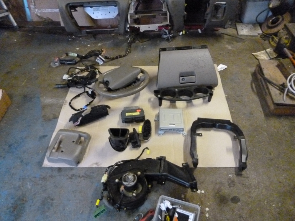

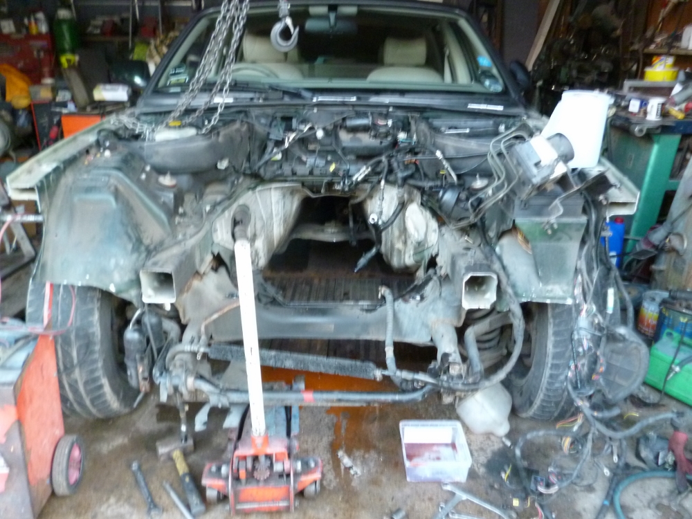

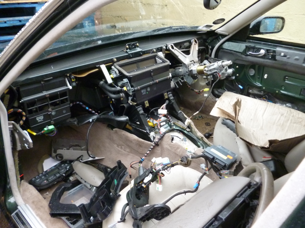

hi all, my name is barrie, I am located in S.Wales U.K. I have just started project to try and run motor/transmission from 1998 3.2 xj8 out of car with intentions of fitting same into another vehicle other than jaguar. the car I am dismantling is an M.O.T. failure which I acquired for a reasonable price. the biggest obvious challenge is going to be getting motor to run, I am removing all electrical systems loom by loom. once I have secured engine/trans. on a base in my garage I will attempt to identify and reconnect all electrics which I intent to mount on some sort of temporary board. if there is anyone here able to help with anything that is imperative to achieve this I will be most grateful, will try and post some photos, any way thanks for taking the time to read this, (new to this forum, please feel free to point out anything I am doing wrong)

more photos

put simply, it won't run.
You're better off finding an aftermarket ignition system. Try xkracer a member on here for info about running these engines with custom engine management.
The reason it won't run, is the can-bus, it needs handshakes from all the door locks, boot lock brake pedal, gear selector mech speedo cluster or IPK etc etc etc, you miss just one of these modules, it wont run.

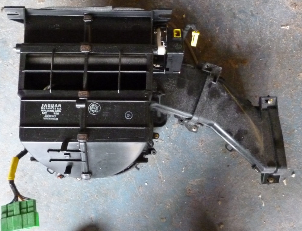

What is that "box" behind the glovebox on your firewall? Do you see a code on it?

xj8 blowers
is this what you need?

Hi, I wanted the pictures of the 'under the dash' place with the fans mounted.
I found some pictures on the internet,it's Ok!
