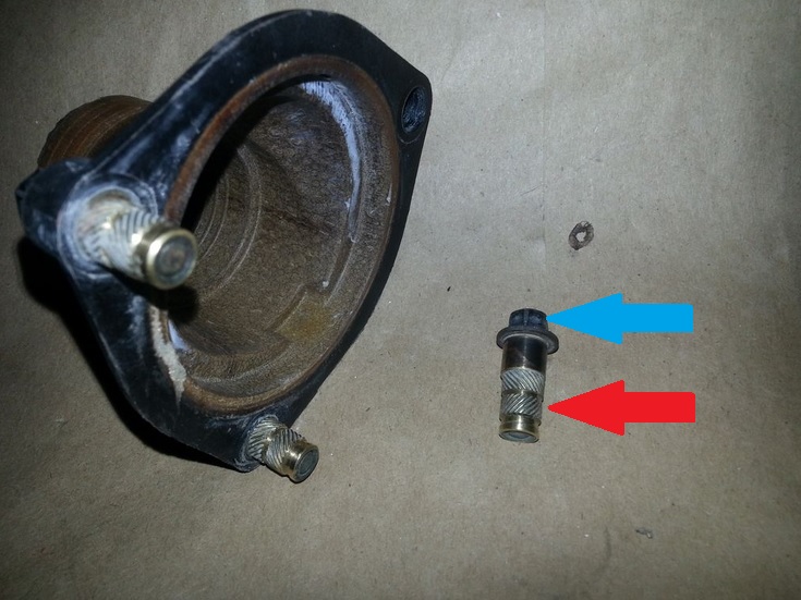

Has anyone had any trouble with these weird bolts that connect the radiator house plate to the thermostat housing? They don't seem to be screwing on (or off) correctly - is it because they're threaded in two directions? Are these the right bolts for this connection?
the plate connected to the radiator hose
https://www.dropbox.com/s/mlw9s8bszr...2000.15.38.jpg
the bolt close-up
https://www.dropbox.com/s/1uo2bojzxe...2000.07.43.jpg
Connecting to this plate, which holds the thermostat
https://www.dropbox.com/s/ctaw3j32jh...2000.08.51.jpg
Old Jul 12, 2013 | 04:08 AM
Likes: 17,016
The whole fitting has pulled out there - not just the hex bolt.
The knurled section (arrowed in red) should stay in the housing and the hex bolt (arrowed in blue) unscrews from it:
The hex bolts must be in VERY tight to strip out the fitting. The correct torque for thermostat cover bolts is only 8 - 10 Nm.
You may be able to repair by first separating the bolt from the knurled section and gluing the knurled section back into the housing.

I ran into this issue- replaced the housing.
