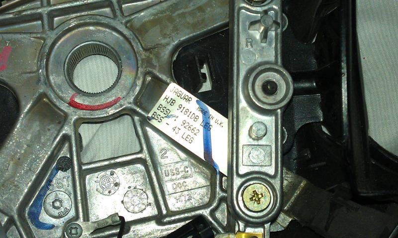

All steering wheels originally came with stickers attached identifying the color code. Here are two AEK's and one LEG.
Edit: The steering wheel color code won't necessarily match the interior color code listed on the door jamb. For instance, my SDZ (cashmere) interior uses an AEK (sable) steering wheel.

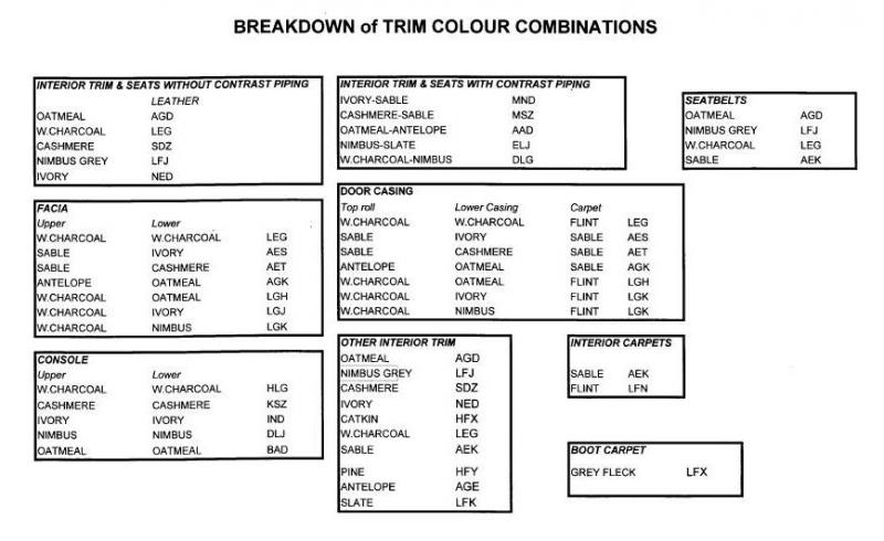

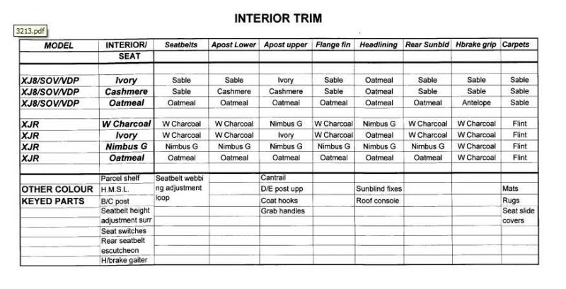

I just found a trim guide online which lists colors for the various trim codes. The steering wheel wrap color should match the upper facia color.

Thanks. I have googled my heart out and couldn't find that.

Just bought a steering wheel from eBay, thank you DavidB for posting those "thumbnails" they really helped me confirm the colour I required.
