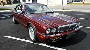

I recently purchased the below 2002 Xj8 Vanden
The car has sat since 2010 in a parking garage.
I had the car towed to garage where we had all fluids changed, tires replaced, o2 sensors changed and battery. The car was taken to jag to have programming done..
Did I mention the car just turned 30K miles...
THis is the first week of gently driving the car and little failures keep popping up:
O2 sensors, bad fuel cap, bad evaporator pump, and now HVAC only cools when driving and not when at a light.
