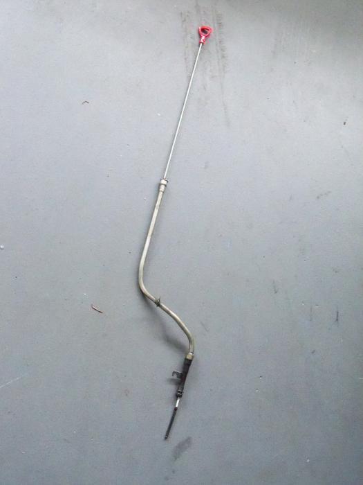

One of the mysteries of owning a XJR is how to properly measure the transmission fluid level without having to purchase the expensive Jag Tool. I purchased one of the dipstick tools sold on ebay, but I found that the Ebay tool is about 2 feet longer than normal. I could not get an accurate reading with the dipstick due to it's length so I took another approach. During the removal of the locking sleeve on the trans that so many others have dealt with, I decided to remove the dipstick tube to get an accurate measurement to ensure I could find the appropriate fluid level.
1. I removed the tube and inserted the Ebay stick until the graduation marker stuck through the end.
2. I then measured from the top of the dipstick tube plane opening to the bottom of the trans pan.
3. I then inserted a thin rod though the tube opening until it touched the bottom of the pan. Marking the rod at the top of the tube opening
4. I used the rod marking to adjust the new dipstick so that the correct length of the marker was sticking out of the bottom of the tube.
5. I then painted a band on the Ebay dipstick at the top of the tube opening so I would know how far to insert the stick into the tube for an accurate reading.
I apologize for the length of the procedure, but I can now inform those needing this info the the correct length is 27 5/8". Remembering though that the level will be about 2.5" from the bottom of the pan. Hope this helps.

The Jag tool is 74.5cm from cold level marker to top - 29 5/16" does that match your cold level?

No, not even close to the same. From my physical measurements I would be at 27.5" for cold. Did Jaguar ever increase their capacity specs?

No I don't think so - from memory there is a gap, I'll measure it and report back tomorrow, if it's the near 2" difference your spot on.

Is the gap located between the top of the tube opening and the bottom of the tool handle?

There is a stop on the dipstick, I have marked that with the red arrow. From there you need to measure (ie the green arrows).

Argh!!! I didn't notice the stop until you pointed it out. Sure enough it's on my stick. Does that actually prevent the stick from going all the way into the tube hole?
I think it does .
I remember reading somewhere that the dipstick is not touching the pan while
measuring.
It feels and sound that way , but that is the stop hitting something.

There is a ring in the gearbox where the mentioned thicker part of the dipstick will stop. It never touches the bottom pan of the box.

On Mercedes cars, I know that stop doesnt work and it will go all the way in the transmission, collapse, and lay down on the bottom of the pan. This in turn gives you an overfilled reading, even though it is not overfilled. If the stop actually worked, the transmission services wouldn't be a pain at all. I am glad to see this isnt a problem on the XJR though.

The length of the dipstick does not matter because it is inserted until it hits the bottom of the gearbox pan. It is somewhat longer than really required and quite a bit of it sticks out of the dipstick tube when it hits the bottom.
You don't need to remove the dipstick tube or do any measurements, just have to be sure that the dipstick has hit the bottom when checking the fluid level. Insertion of the dipstick is a bit tricky because the tube has bends and the dipstick will have resistance at a few points on the way down, the last one being just a couple of inches before hitting the bottom. You will have to wiggle/rotate it to go pass the resistances. What I did was: I inserted the dipstick (for the first time) before I poured in new fluid. In this way, I could listen to the sound from the (empty) pan when the dipstick hits it. After I heard the "hit" the first time, I pulled the dipstick back about an inch and pushed it down again a few times, listening to the "bonk" to make sure I have really hit the bottom. Then I put a red paint mark on the dipstick corresponding to the top of the dipstick tube.
In my case, the mark is at 704 mm measured from the tip of the dipstick.
