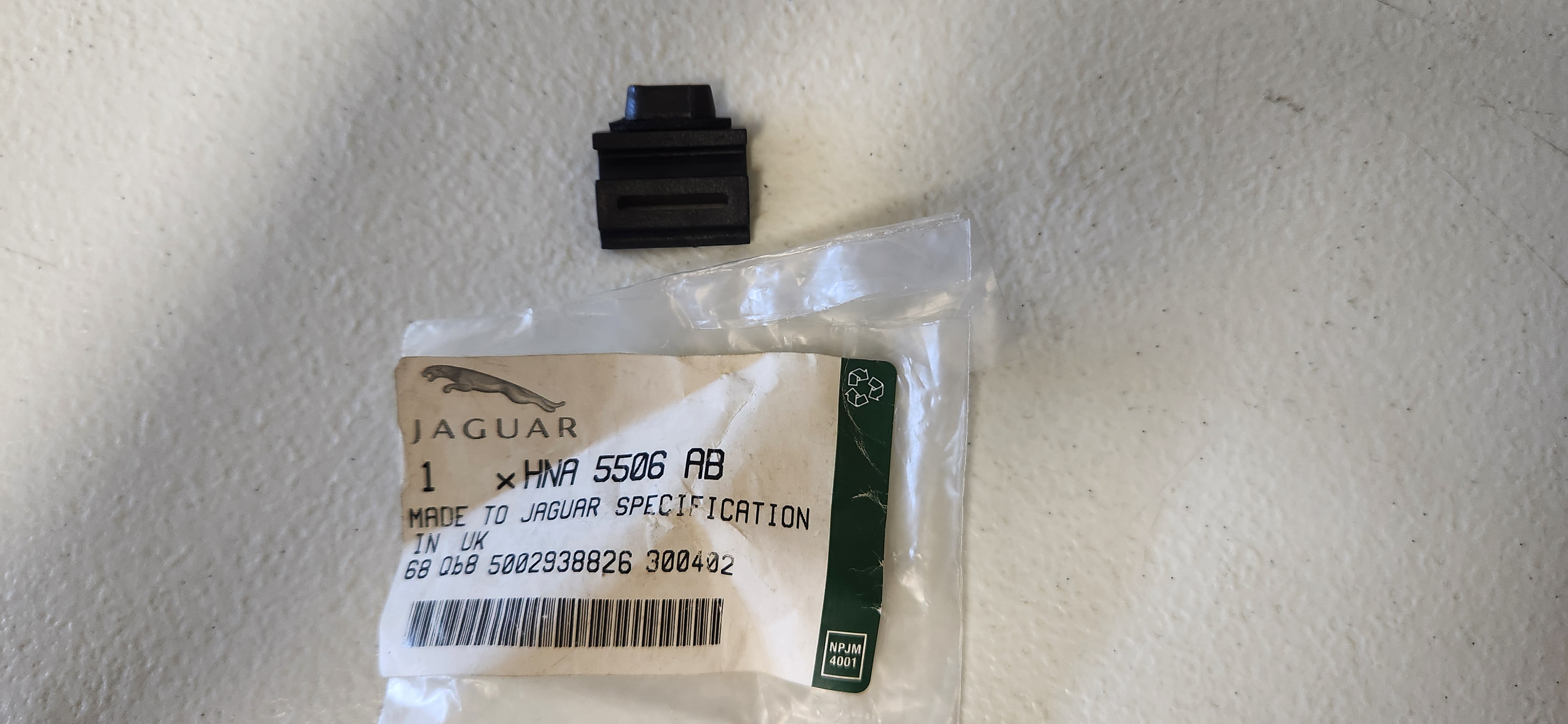

I must be going crazy. I have all the parts I thought I needed, but these HNA5506AB insert clips do not make any sense for the 2000 XJR mesh grille.
I even put my vin in to be sure and asked the parts guy to confirm but he didn't follow up and sent them.
Is it possible my car has the wrong bezel? It is paint matched and appears original to the car. The screws are loose in the tabs that are there, so I thought the catalogue was right and there are clips which are missing. If the answer is, those tabs are all that's required and they're just worn, I will try some plastic epoxy or weld to repair them.
Photos below of everything I have. If anyone can help me figure out what's correct and not would be helpful.
Thanks.

I believe those parts either go inside here or on the bottom of your grill?? I seem to recall seeing those go on the earlier X300’s though.

Thank you, I think you're right about the clips being for the x300. They definitely do not go on my car. The two bottom tabs on the mesh grille I have go into those slots just fine. Based on what I see in the sng catalog, I thought there were clips for the screws on top to go into, but I don't think there is. The screw just go into the 4 plastic tabs on top of the outer bezel. The holes were just worn on mine. I epoxyed them over night. They should hold much better now once I drill the holes back out.
Now I just have to deal with returning $90 clips I have no use for. I did ask for confirmation from their sales who reached out to me and didn't get it. I even provided the Vin they requested.
