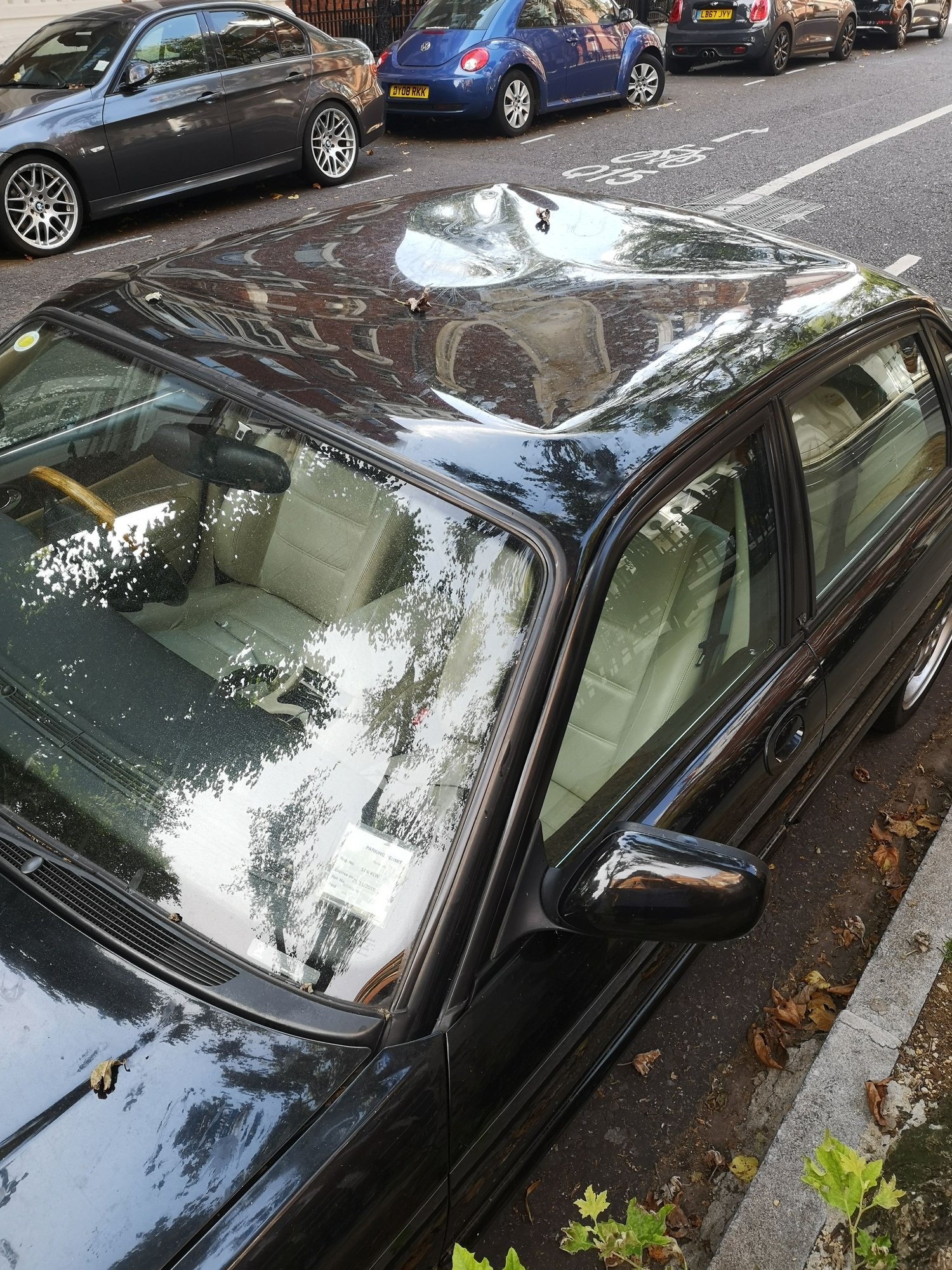

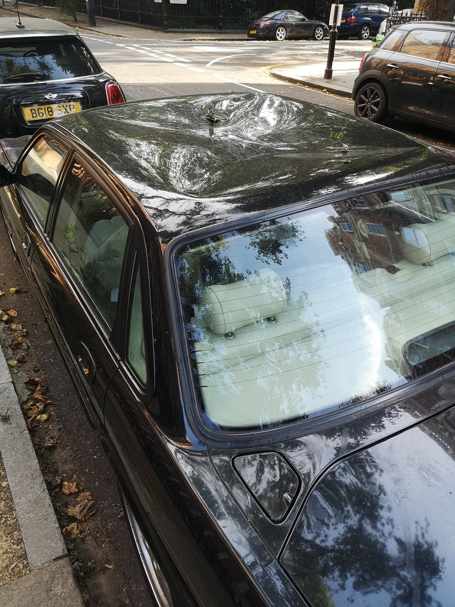

Some *******s have jumped on the roof of my 1999 XJR. You can hopefully see the extent of the damage in the attached photographs. The insurance company have called it a write off. Replacing the roof would be very expensive, and replacement roofs are no longer manufactured. I have found someone who thinks that he can repair the damage using paintless dent removal at a cost of £2,200. Does anyone have any experience of this type of issue, and whether or not the repair would be successful? Would trying to pop it out be a stupid idea?

I've seen those dent specialists do some amazing work, but not on an area so large and brutally beat. Its worth a shot nonetheless....

Regarding the paintless dent removal I've had some work done on my VDP (small door dings etc) and was pleasantly surprised how well it came out, I think the problem would be the creases, the paint will be cracked there so I don't believe the process would be "paintless" but I'm pretty sure it could be pulled out to a point where you could get it painted, especially as there's no sun-roof to mess with. Again I'm sorry you're a victim of this mindless vandalism.

iv'e delt with salvage cars before,and highhorse is right.as long as car can be totaled out and aloud to be put back on the road { local state laws } then push roof back up and go from there,pull headliner first,it may reused it if good before damage.the upside is no sunroof.years ago I cut off and replaced roof on a 96 xj6 and drove it for 8 years,steve.

Today’s paints can be uncreased, to a degree without cracking at the dent line. A good pdr tech can provide astonishing results.
i would pursue that option. Shop around, get referrals.
