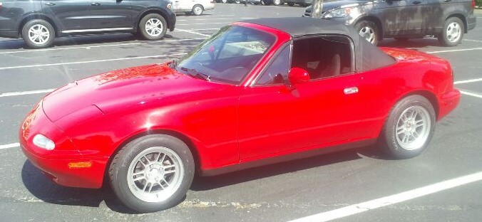

For fun toys I just picked up this little RED roller skate, a 1992 OBD1 (read easily modified and still smog legal) Mazda Miata. Just finishing up adding the super charger (cute little M45 eaton that just about fits in the palm of your hand) with 9.5 psi boost, water/meth injection, fully adjustable suspension, Carbotech XP10/8 racing brakes, etc.
As fast as my XJR was, this little go cart would push the XJR all around the race track, except maybe in the long straights. I bought a little 2.5 Nitrous bottle for it, but frankly at the 160-170 whp now @ 2200 lbs it is more than fast enough...for now. The parts for the Miatas are ridiculously cheap. Example: I needed to buy a larger set of injectors for the Supercharger and they were, from ebay, $45 for all 4 delivered and they were already cleaned! Yes, just $11.25 each! Those little 14" wheels are only 8.6 lbs each.
This little car is a lot faster than it looks. The grip is unreal and the handling is so forgiving at the limits of traction.
