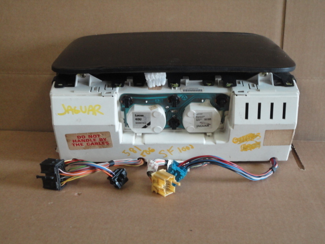

I bought a 1990 Instrument Pack (IP) from eBay for $40 + shipping. I found another locally for $10. I also found two more mal-functioning 1988-89 IPs for another $10 each.
found eBay pic of the back of a 1988-89 XJ40 VFD IP showing harness connectors
You are going to need a junk 1988-89 vfd IP in order to cut several of the connector plugs from it. There are four. You may want to use your faulty one ... or get another for a donor.
You are also going to need the two plugs that fit into the back of the 1990 IP. I found my 1990 plugs for $10. They came with lots of wire because I clipped them myself from a junk car. You will need at least the parts labeled 1 and 2 (and prob 2a) found in the above pic.

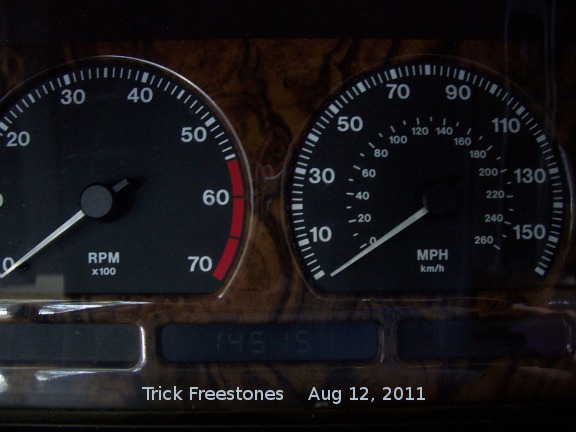

Here is a picture of the IP just after I switched the ignition key to the RUN position.
IP display just after ignition switch was turned to RUN position, engine is not running
NOTE:
NOTE:
- the ammeter gauge is showing discharge, as it should with the engine not running
- I have just under a quarter tank of gas
- I have an odometer reading in the LCD! This IP shows 145,151 miles.
- only three of the seven lamps in the AMBER secondary warnings on the left are lit. I know the bottom one is missing.
- all seven RED primary warnings (hazard/fault condition) on the right are lit and
- the remaining eight lower lamps are a mixture of status and warning lamps and all are lit.

After a few seconds, I heard the µ-processor "kick on" and this happened.
I know you guys with these Instrument Packs are familiar with this behavior but this
was news to me.
key in RUN position, secs later when IP µ-processor "kicks on"
Most of the lamps turned off. Odometer reading stayed ON!

I started the engine and released the key from the START to the RUN position.
Allowing the engine to run for a few minutes, I took this picture.
Instrument Pack display with the engine running and warm
Notice:
1. the ammeter gauge is showing "charge" condition, the needle is on division 14
2. tachometer needle is on 1100 rpm
3. the lamps, ignition light & battery alternator fault and low oil level pressure fault, have gone "out"
4. oil pressure gauge is on the 7 mark and
5. coolant temperature is on "N"
It appears the engine is being monitored again.

into the 4 connectors of the VFD.
If you change your mind someday, you always want to easily put things
back to factory spec.
My only problem with the VFD is I could find no schematics in order to
troubleshoot it - aside looking for starved solder joints. There are many pc
boards to fool with. However, if I ever locate a functioning (and cheap)
VFD type, I can still easily plug it into my car's harness by just removing
this sub-harness.
Why? It may add to the vehicle's worth someday when that time comes to
sell her. From a reliability point of view, I would still run the car with the
90+ IC.
~~~~~ continuing
This is a pic of the sub-harness to date.
visual of pha#1c
