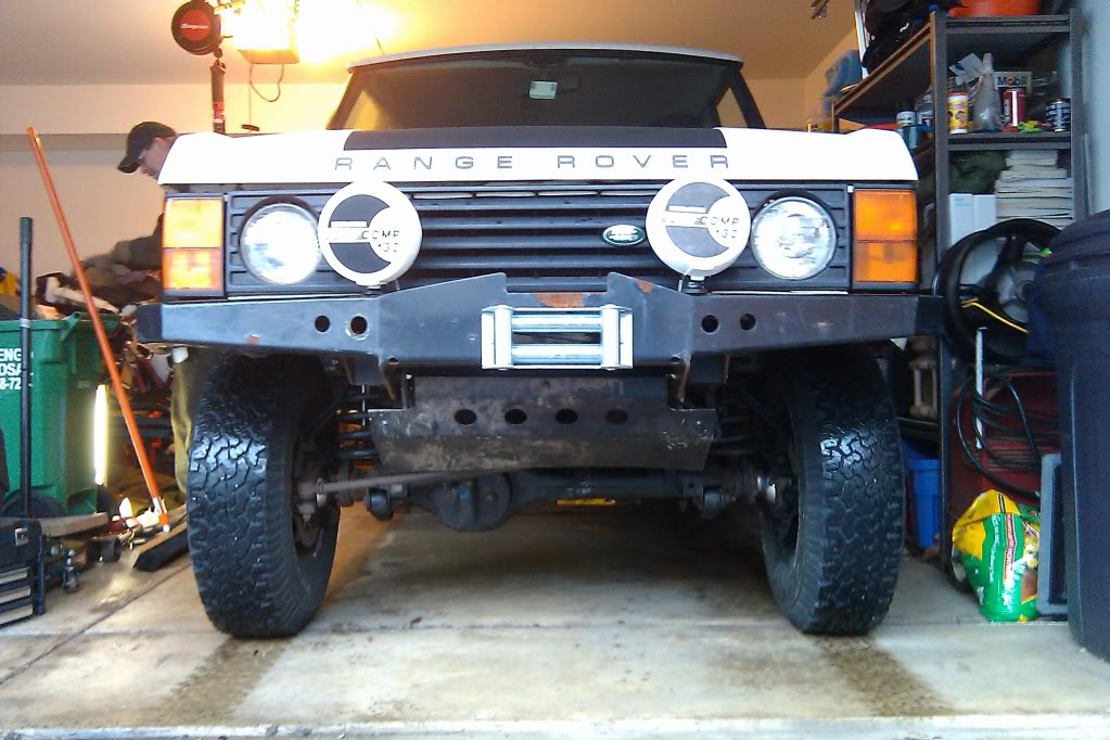

So I have lost pressure on the brake system. Luckily I have the Range Rover to drive for the time being but I would like to get the Jag back up for non snow days for the gas mileage lol. Ok I'm pretty happy with the way the Rangie has been coming along so here's a picture

(Rangy is looking good)

Oh and thanks on the Rangie

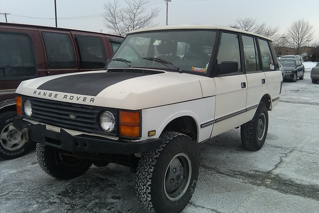

of course Range Rover love pics

My RRC sitting next to a stock Discovery G4 edition it looks so short compared to mine...
