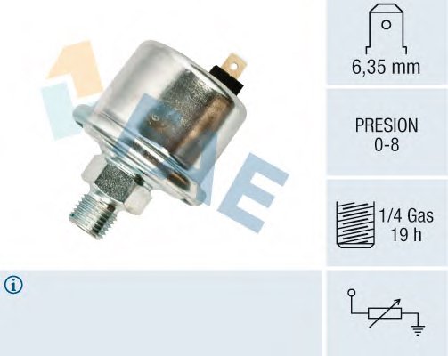

The oil pressure sender that doesn't change the gauge reading is one that is either on or off depending on the pressure. A gauge needs one that has a variable resister that allows a different voltage flow through it depending on the oil pressure, this varying flow is what changes the gauges reading.
Up to vin594575 the senders part number is DBC4418. From vin594576 to engine number 103370 the part number is DBC5513. From engine number 103370 on the part number is DAC7879.
An optional part with number LMD5640AB was introduced to stop the oil pressure gauge from "fluctuating", this one is the one that just reads an unchanging pressure unless you get low pressure then it drops to zero, on/off only.
Picture on the left is LMD5640AB. Picture on the right is DBC4418, all the senders that vary the gauge reading look basically the same.
Hope this helps, and to anyone else that wonders why there gauge never changes. It's the sender not the gauge.
