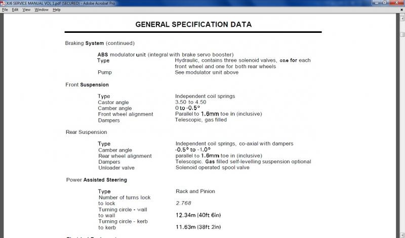

Hi Can anyone tell me the toe in dimention in degrees or actual measure front of tyre to back. I have had pro wheel alignment done the car seem to be handling worse than ever now . I would like to check or go back to the *********** and watch that the correct info is input to the machine , some of these dealers put the apprentice on it and they don`t give a s##t if its right or wrong thanks Bill

Jags up 'til the V8's had to be aligned in what they call a mid-laden position. Lots of align guys, especially the younger set, have no concept of such a thing. Attached are the specs and illustrations of the tools necessary.
Good luck!
