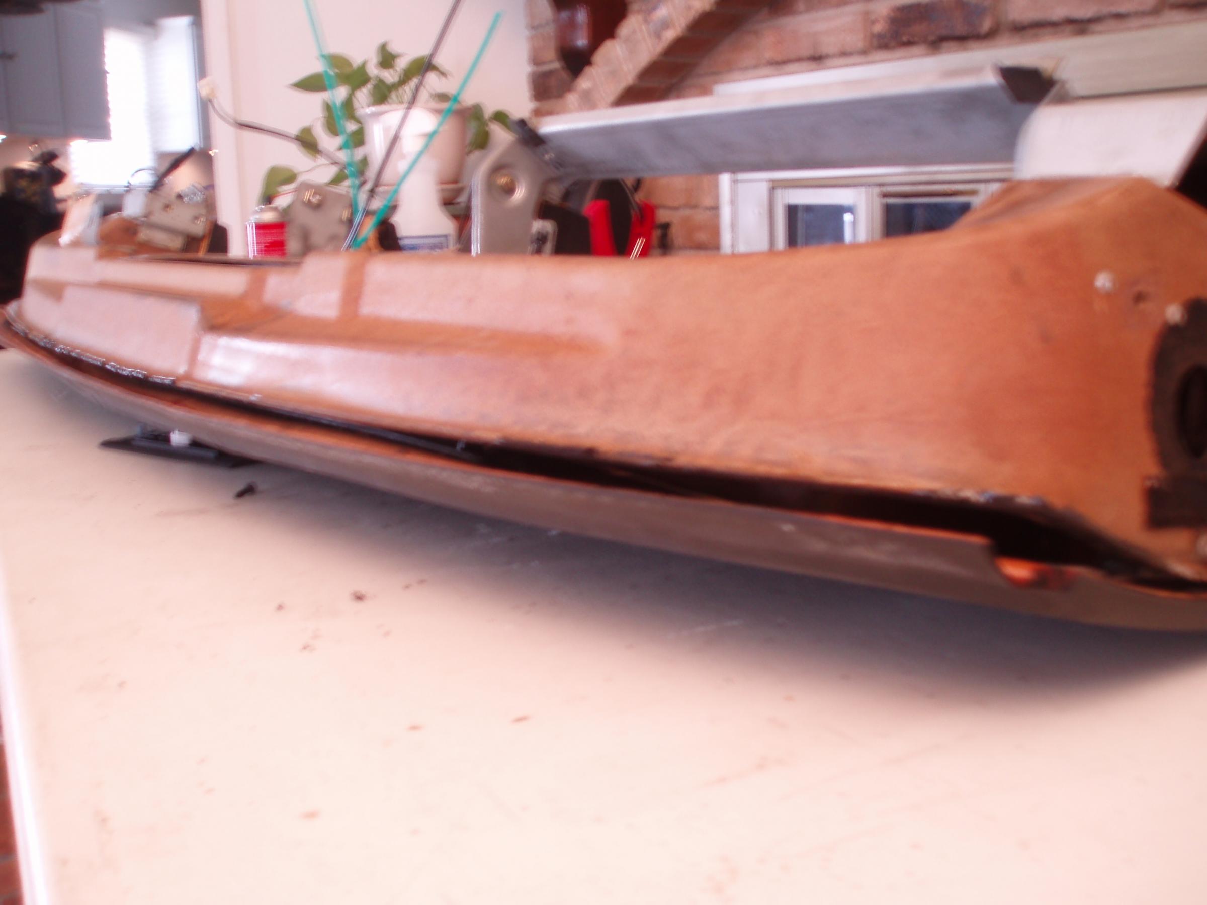

Hello All, I m Ben, Im Having A Hard time troubleshooting the A/C in my Wifes 94 XJ6. It was working (kinda)It blew Cold air in the Dash Area &NOT out of the Vents. so NOW it doesnt do "anything". No Blower, No Compressor, No Lights on the Face of the Control, No Nothing. I Checked all of the fuses, Checked the Relay & I Even bypassed the relay with a jumper wire just to find out that it DOES work (the clutch engages). so can i get some professional advice ? its HOT Here in Arizona ...... Thank You

Another issue you may have (My vehicle was in Tempe for five years) is a separated air box, thus the appearance of air blowing/flowing to the windscreen, and weak flow from the fascia vents. This is the exact reason I had to pull my dash. It air box had separated at the seam, thus releasing any airflow out to the firewall and dispersed from there. Here is a pic:
