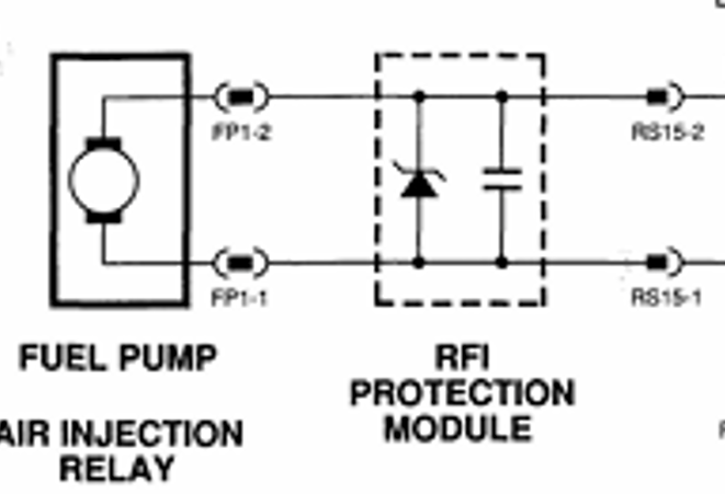

I don't think this is a immobilizer issue but maybe I'm wrong? I don't have any red security lights and most of my research points to the US market not having immobilizers. After getting a new coil on there I am getting spark! So now my attention has turned to fuel, not getting 12v at the pump.
Old Dec 6, 2024 | 10:41 PM
MoonBackMotors's Avatar
Joined: Dec 2024
Posts: 6
From: Fayetteville GA
Applying the R815 plug to the 12v test plug in the trunk yields no prime from the fuel pump. So I believe I have tracked my issue to the "unreachable" areas. Guessing the fuel tank has got to come out to access the protection module and pump?
