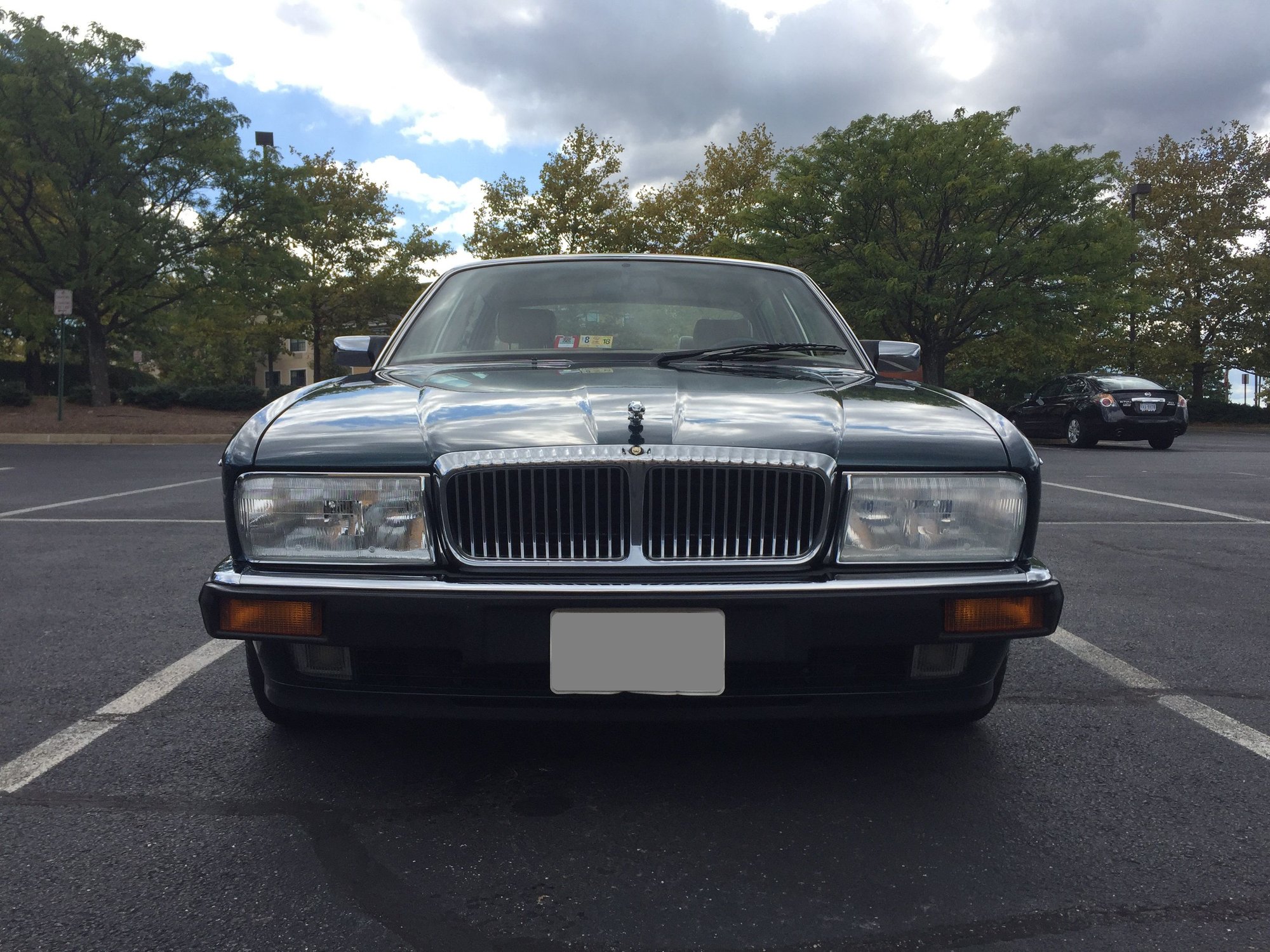

Hoping to join the Jaguar family, so here is my first post about a 1994 XJ6 with 100K miles that I am considering:
Pros:
  • All electrical seems to work
  • Super straight body
  • Old lady driver most of its life
  • Garaged, paint in great shape
  • All cosmetics quite decent
  • Clean CARFAX
Here are the areas of attention:
  • AC barely cold
  • Spongy brakes like air in line
  • Steering on-center play
  • Some bushings in the front carriage should be replaced, the symptom only shows when backing up and breaking hard, your hear a faint thunk in the front
  • Puff of smoke on startup after at least 1.5 hour of sitting
  • One door handle just a tad stiff
  • A bit of oil evidenced behind rear differential on body
  • A bit of rust at bottom of trunk, surface type
  • Only repaint is hood and a fender due to a parking incident
I am pretty competent DIY, but I do want to enjoy the car, do you guys see any "show stoppers" here, and thanks.

A/c can be topped up especially if it still works a little. Brakes could become expensive. Could be M/C needing rebuilt or replaced, could be a leak in a line or caliper (although the reservoir looks full). How does the fluid look? If the bushings at front are a known problem, that could "play" into the steering looseness. Puff of smoke could be valve seals- or not a huge problem,,, the rest? A little PBlaster or WD40 and off you go.
I really like that color. Car looks good from my house.....

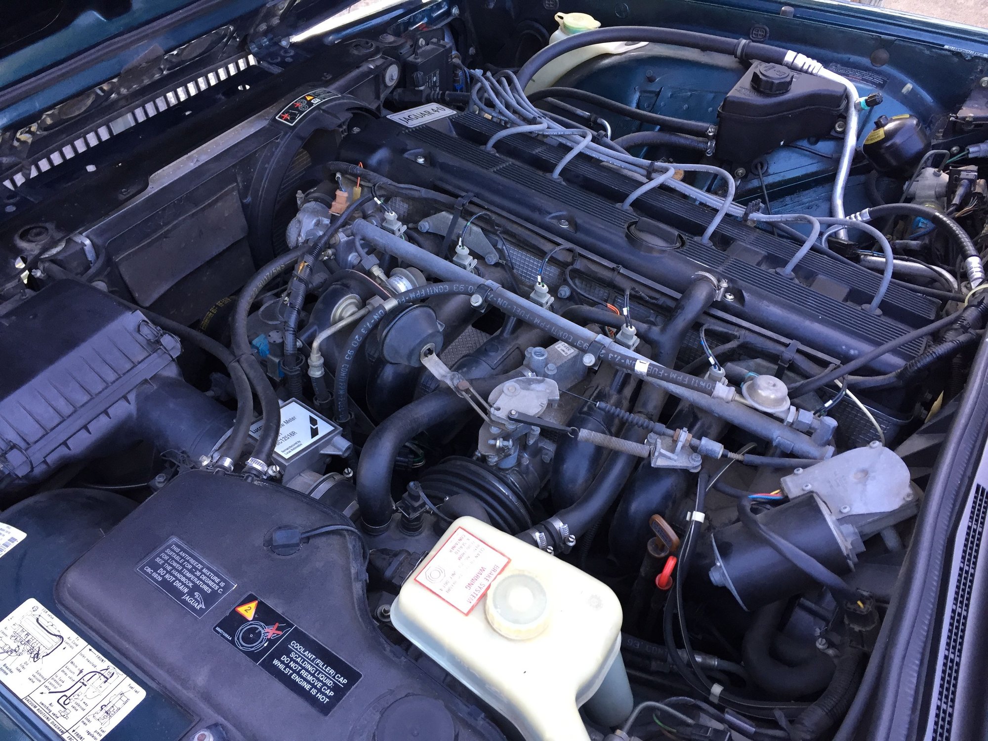

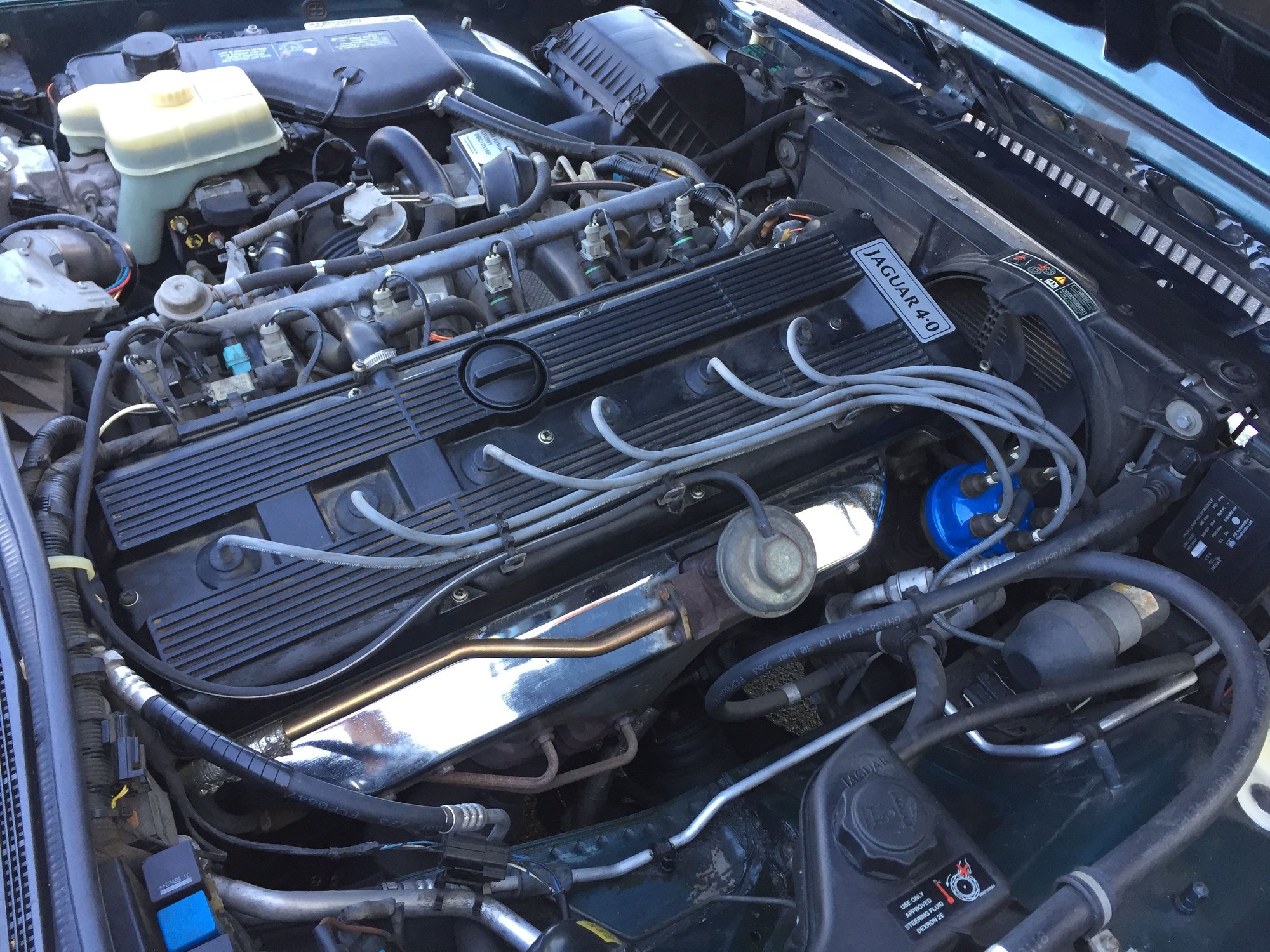

Judging by the appearance of the engine bay, that looks like a very clean XJ40!
