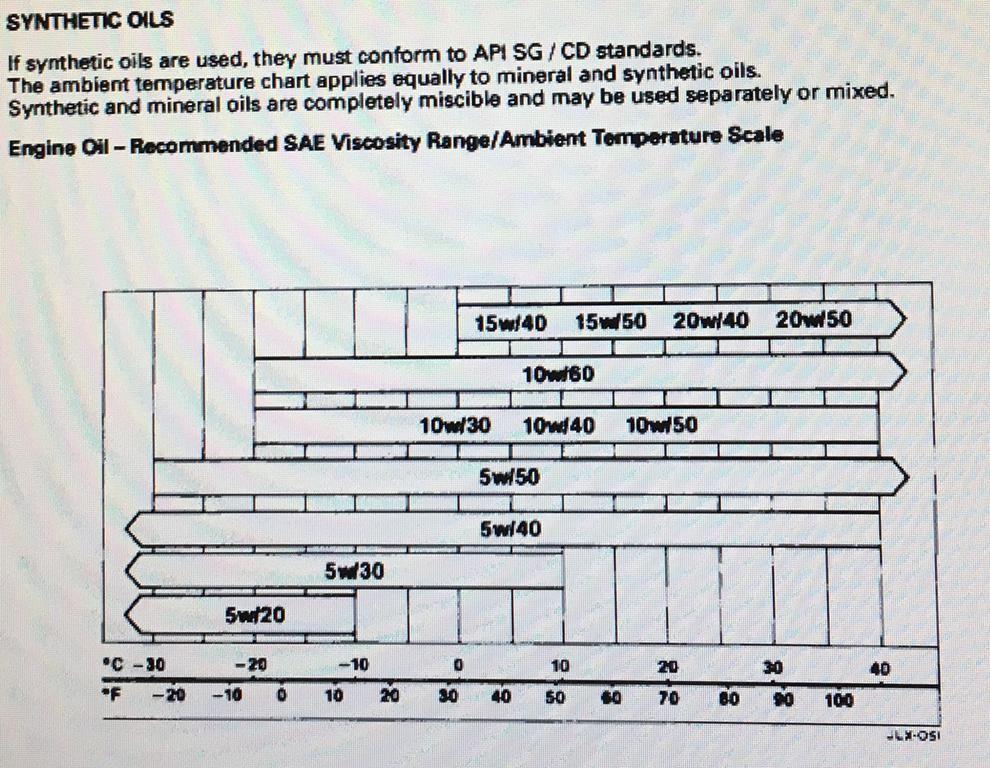

That's what the workshop manual says:
I am personally using 10W/40 (HC-synthetic) but I don't operate it in winter.
