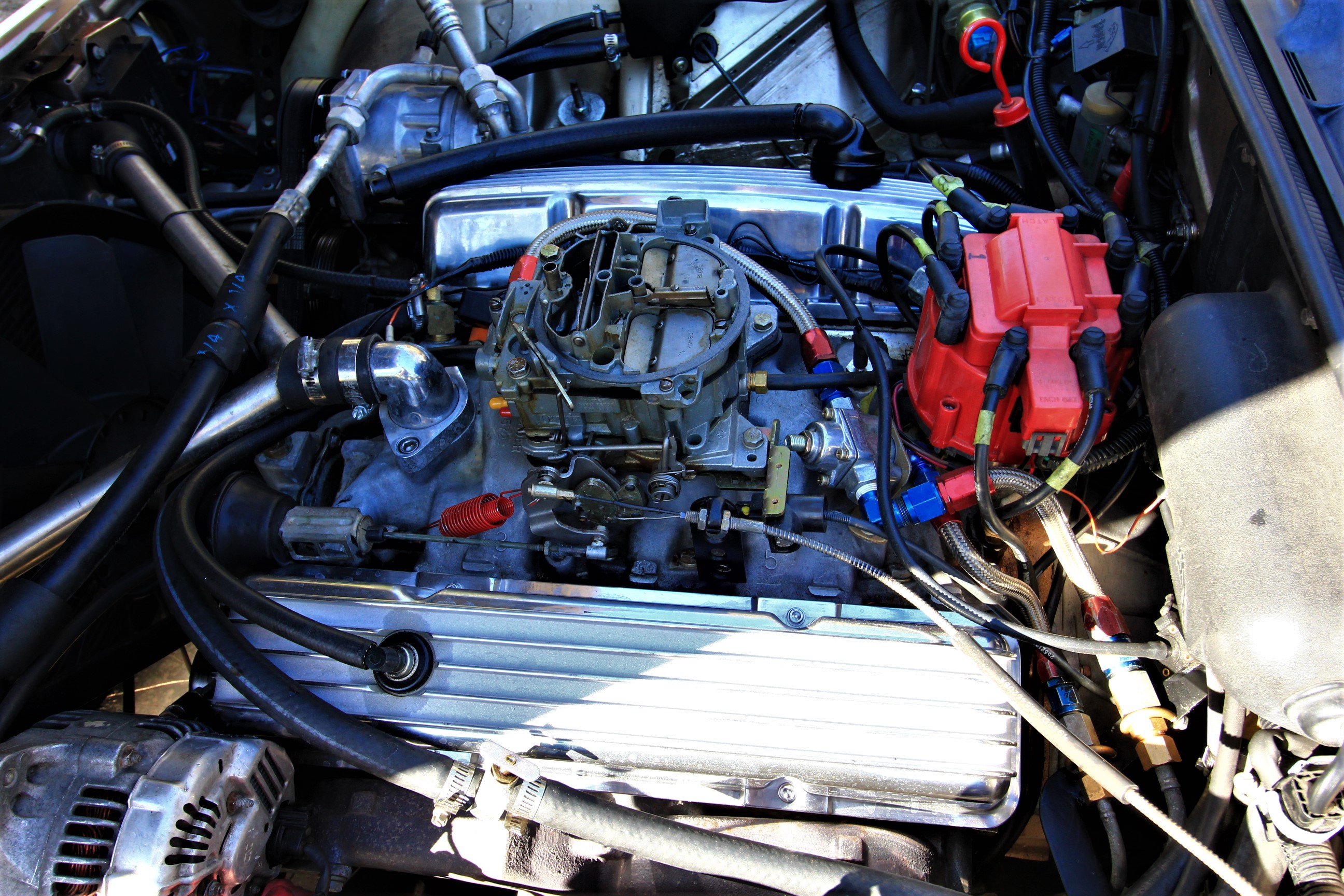

Greets from Florida, I just bought a '94 XJ12 Chevy 383 conversion, and I'm looking to put 18" wheels on it. Stock height and suspension, not lowered or anything,at least not yet. Looks like the stock 16" 20 spoke rims have a bore of 74mm, offset 33. Will 18" 8" wide 40mm offset require spacers to not rub? Tire size recommendations?
Here's a few pics of my ride.
i also have a 2001 XJ8.
Attached Thumbnails Custom wheels on a 94 XJ81-img_8188.jpg   Custom wheels on a 94 XJ81-img_8190.jpg
