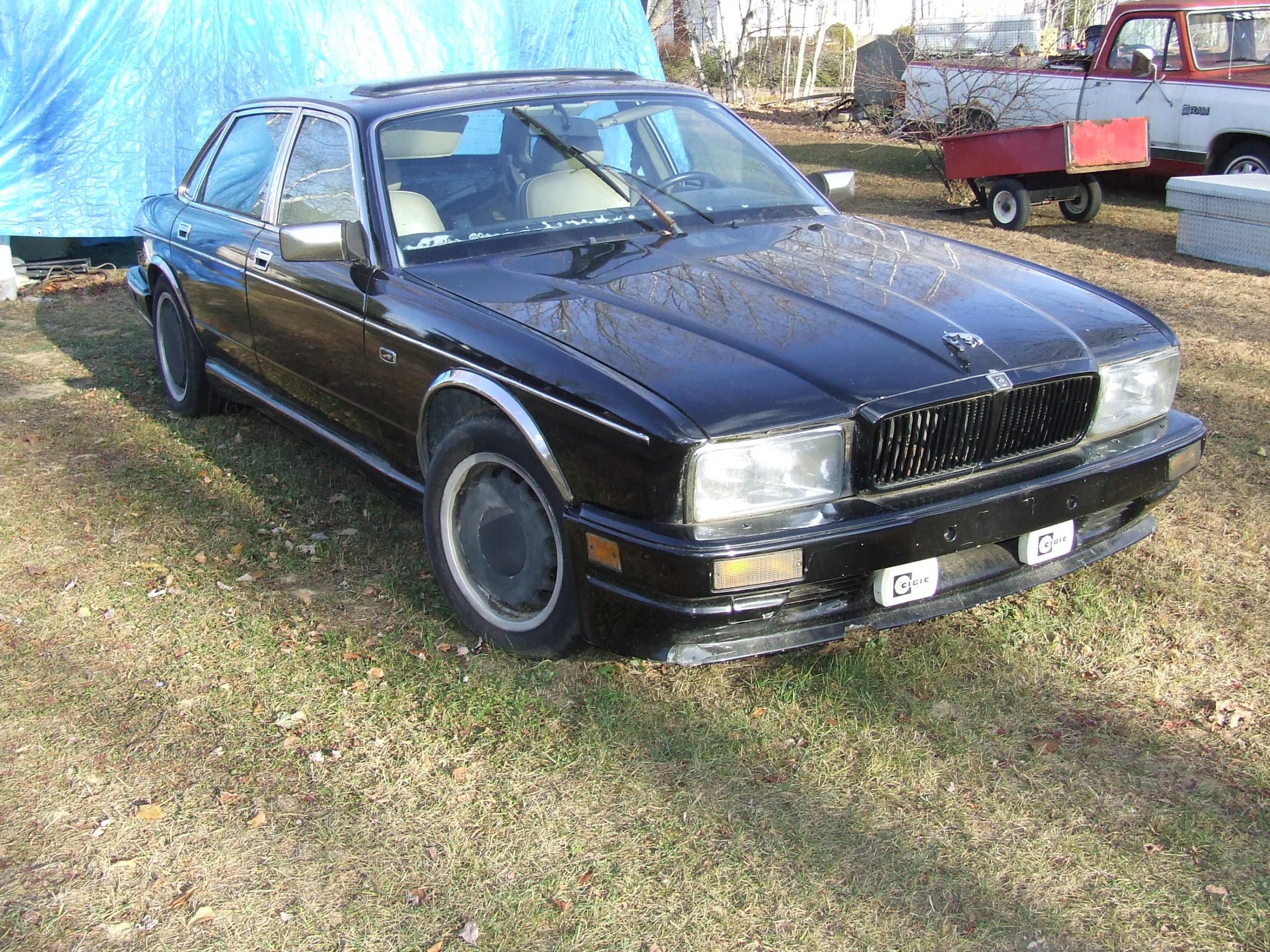

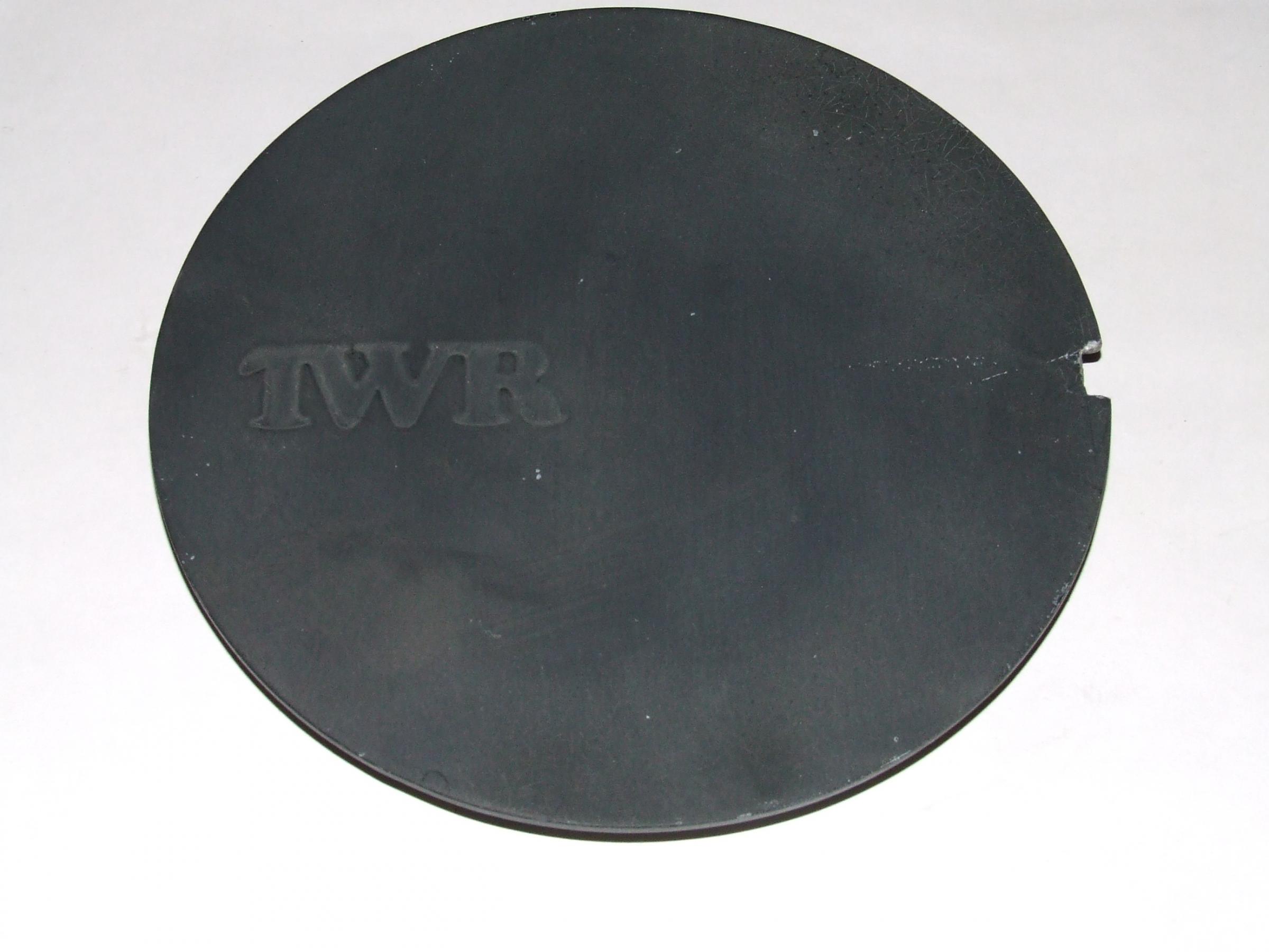

This is a picture of the center hub caps on my 1988 Jaguar, the wheels came with the car when bought. Does it means it is a TWR or could the dealer bought the wheels from Jaguar Sport and installed them on the car just for the look ?

I'm no expert on the TWR enhancements, but it does appear that your car has a front air dam and side body moldings similar to those on the car shown at the link below:
Historics at Brooklands - Specialist Classic and Sports Car Auctioneers - 1990 Jaguar XJR TWR 4 0 Sport
I'll be interested to hear what others have to say.

The picture of the engine is needed. If it is the genuine TWR it should have a special cam cover and intake manifold.

The engine seems to be the normal one, so the car should be the normal XJ40 with the TWR spoiler/wheel set.
