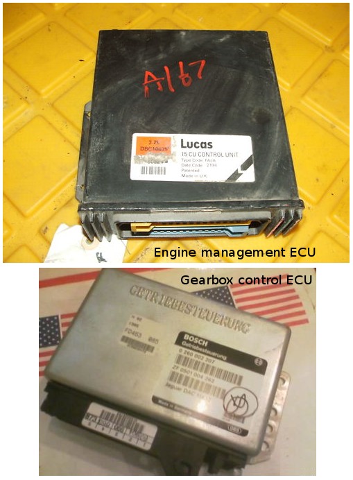

Hi: Where precisely in a 94 US model XJ40 are the auto trans control module and the main ECM for the engine fuel, emissions and ignition management? I suspect a wet water condition across the terminals and need to find them and dry them and reseat them. Thank you. --Tom

Hmmm ... getting that much moisture in AZ?
I believe they are both located behind the passenger side dash liner.
WARNING: To prevent accidental deployment (and avoid getting hurt) you should disable the airbag system before doing any work on the instrument panel!
You are going to have to:
  1. disconnect the battery negative cable
  2. remove the lower instrument panel on the passenger side under the glove box
  3. remove the glove compartment from the passenger compartment
  4. remove the screws from the ECU bracket
  5. lower the ECU and unplug the electrical connectors
You are looking for something similar to these:

They are both below the RH blower motor above the passenger's feet. They have been known to get damp a time or two! ECM has two connectors, the TCM has one big one.
Cheers,
