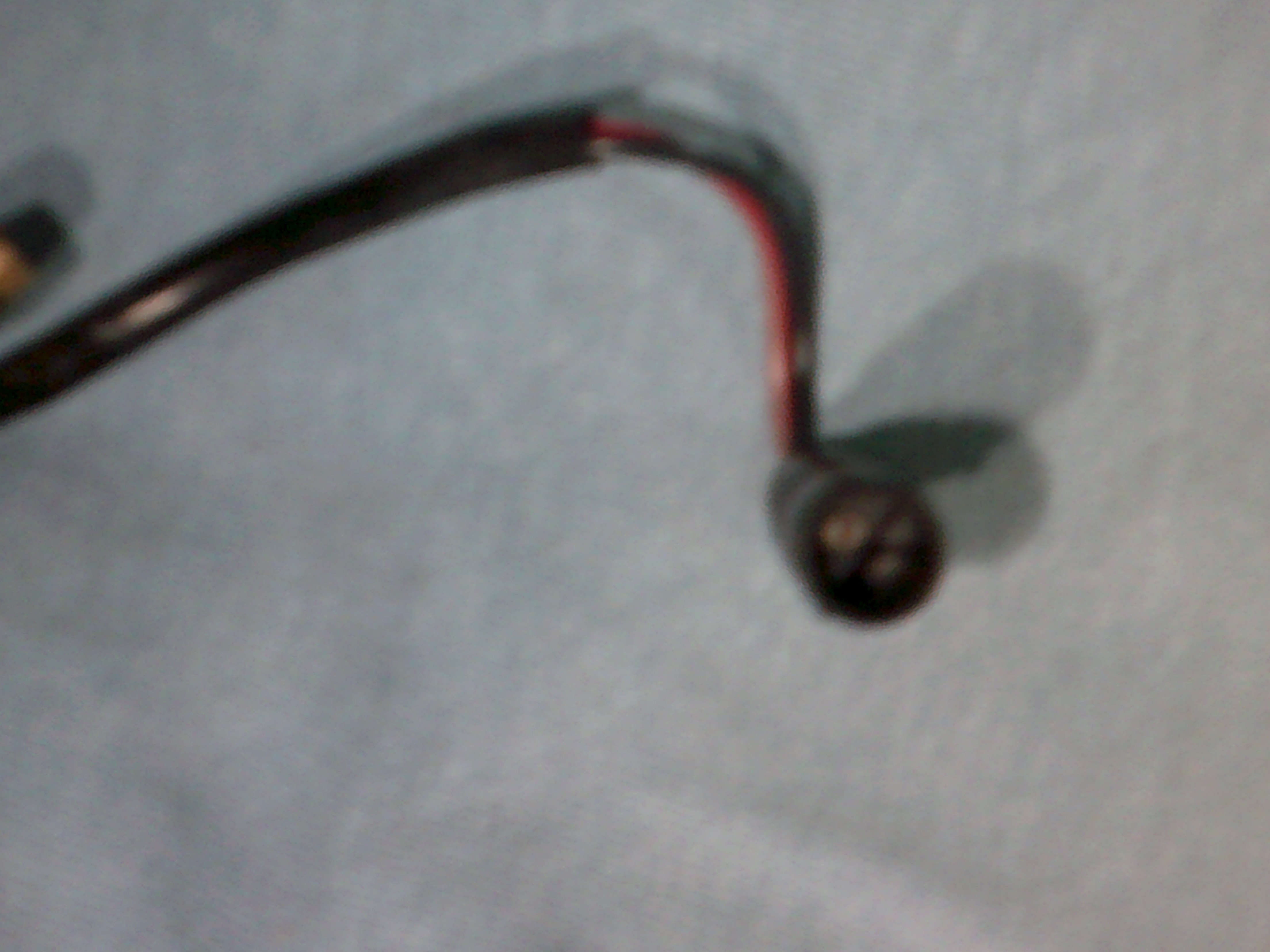

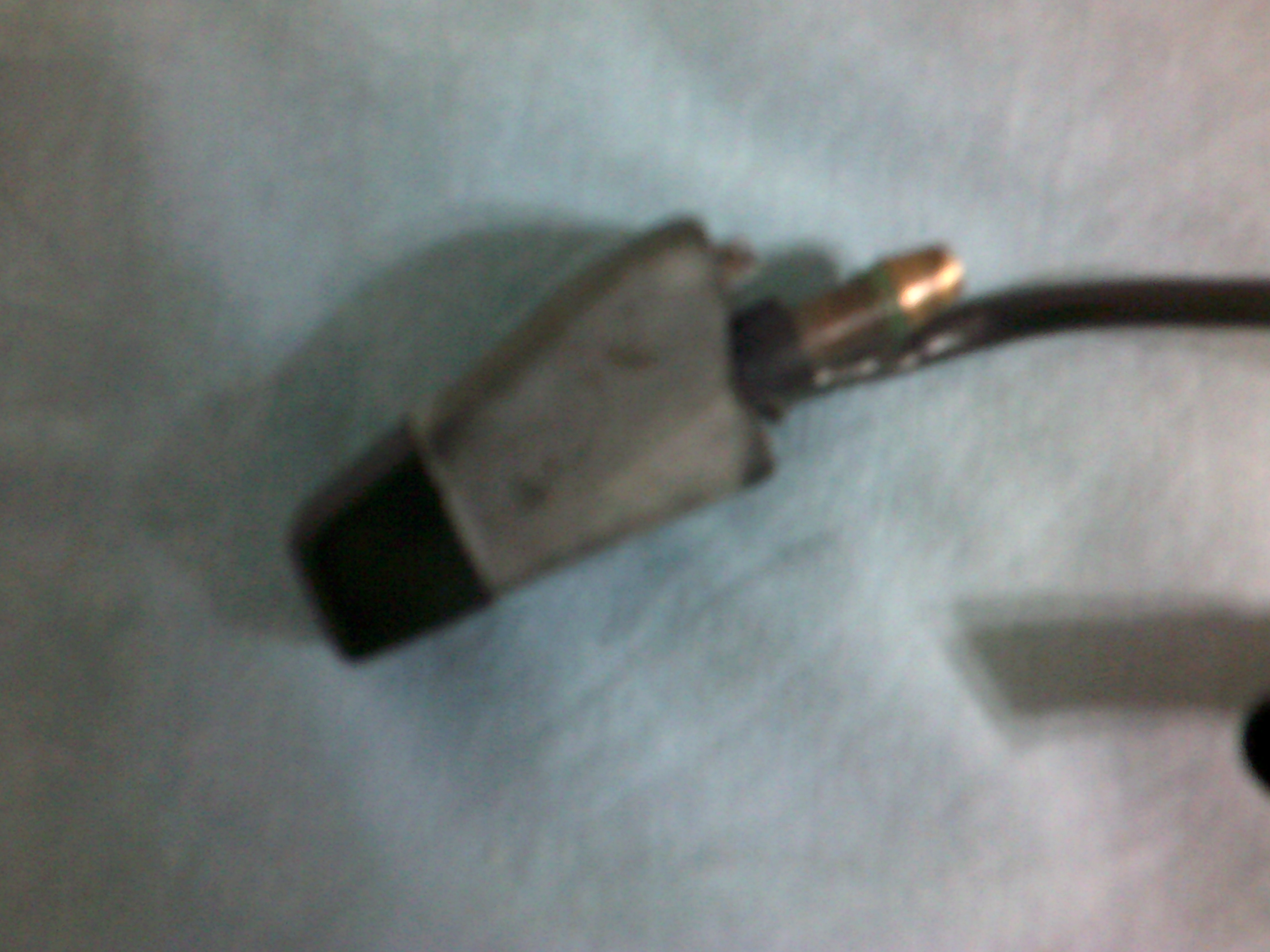

I seem to be having an issue with one of my windshield washer nozzles not working. I get nothing from it. I swapped nozzles and the other nozzle works fine in both locations. Has anyone had a washer nozzle go bad? I'm assuming there's some sort of solenoid built within the nozzle itself. I'm looking for a replacement nozzle but there seems to be many different styles that were used on XJ40 models. I have an '88 VDP and mine is like the picture but I've also come across another '88 in my local salvage yard with a round style nozzle. It seems the more I dig into this car the more I've been finding that the XJ40 models built from 88-94 have different parts used with no consistency (headlights,taillights,chrome trim,etc). It seems like Jaguar pulled whatever parts they had laying around when assemblFaulty Wiper Washer Nozzle-dscf0110.jpg

Faulty Wiper Washer Nozzle-dscf0113.jpging these cars with no particular year or model definative. I may be wrong and it may be that previous owners have changed things over time but I've noticed it on many cars. Does anyone have this style nozzle that I need?

I don't believe there is a solenoid in the nozzle; the electrical connector is for the heater that melts ice in cold weather. The nozzle may just be clogged. You might try to carefully clear the orifice with a fine but stiff wire, like a section of guitar string. You don't want to enlarge the orifice or the spray pattern and velocity necessary to wet the upper parts of the windshield/screen may be adversely affected.

According to jaguarclassicparts.com, the website of the Jaguar Daimler Heritage Trust, there were four different nozzles used for the U.S. market:
To VIN 556850 (through June '88): part number DBC3068
VIN 556851 to 594575 (July 1988 to September '89, last 3.6L engines): DBC4997
VIN 594576 to 672879 (September '89, first 4.0L engines, to sometime between Nov '92 and Jan '93): DBC5157
VIN 672880 to 708757 (from sometime between Nov '92 and Jan '93 to the last XJ40 built in Sept '94): DBC10827
I am attaching a chart published by the JDHT that helps correlate VINs to manufacture dates.
