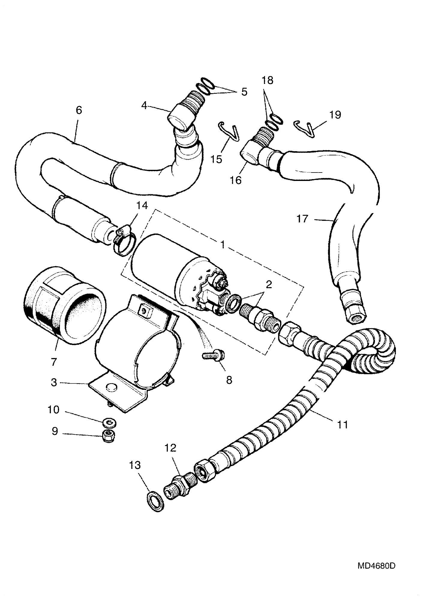

The fuel check valve or non-return valve works in conjunction with the FPR to maintain pressure in the rail. On your '88, the check valve is in the fuel line just after the fuel pump. It's Part 2 in this diagram:
