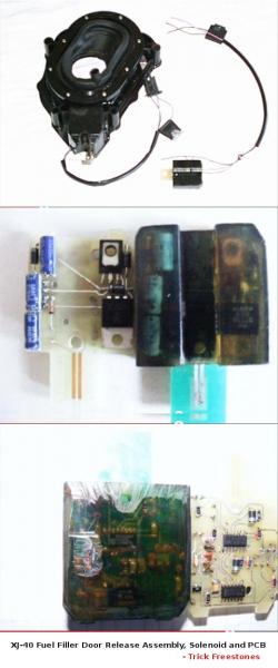

You may find yours is like mine - a solenoid operates the spring loaded flap.
The solenoid is fused. When it goes south, the door can be manually opened after opening the boot as mtr previously wrote.
XJ40 Fuel Filler Door Release Assembly
th_XJ-40FuelFillerDoorRelease.jpg?t=1315880428(clickable thumbnail)
I pulled the above stills from a youTUbe video posted by davidwatson74.

Attached Thumbnails Gas Filler Lid Won't Pop Open-xj-40-fuel-filler-door-release.jpg
