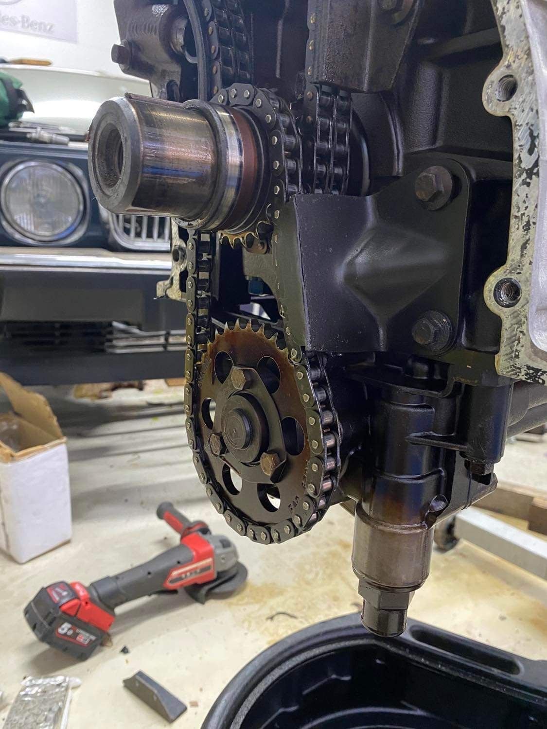

Hey guys! We're so close. But having trouble finding a replacement for this oil pump chain guide (pictured). Our pack didn't come with it and this one is very grooved so wanting to replace while I've got the car's undies off. Anyone know where I can pick it up? 1989 3.6l

I think its shown at parts.jaguarlandrover,com, under the correct car listing, in the engine listing, and then the oil pump and carrier section of that, #13 in the pic. Part #EBC3823, chain tensioner blade. A stiff 125 pounds from Jaguar. Try searching just the part number (you probably know that) and see what is available.

I likely have a used guide. Obviously new is better, but I don’t know if they are available. If you get stuck let me know and I should be able to sort one out for you.
