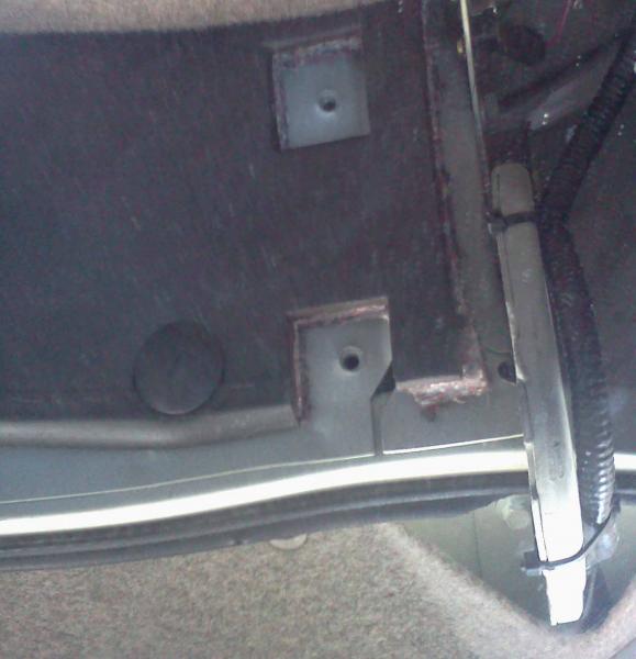

Hello Gents,

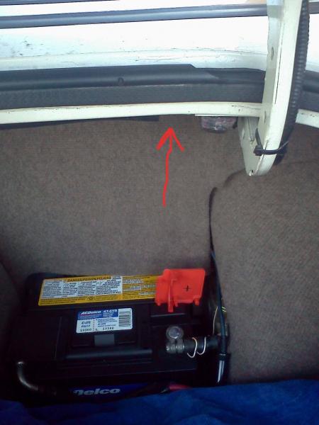

Does anyone know what size thread these holes are in my 1994 XJ40 4.0 base model. I'd like to use them to mount an amp in the boot.
In this model, the battery is on the right side in the boot. The pics show the location of the holes.
Thanks in advance,
David

I don't know for certain but I'd put money on them being either M6 or M8. Push a 7mm drill bit in the hole to check.

malibudav.... My '94 xj6 base model doesn't have any threaded holes for a CD changer or such, only an insulated pad. There's no consistency on the Jaguars it seems. I took a CD changer from a '95 to put in my car, and the changer in the '95 was just attached w/ sheetmetal screws to the underside of the trunk panel. Didn't see any threaded holes in that car either. The '94 was pre-wired to accept a CD changer, but no apparent mounting place or bracket. (The "new" CD changer works fine). David.

I went to Home Depot yesterday and the clerks let me take a few sizes out to my car and the M6 bolt fit perfectly.
I'm not sure why the threaded holes are there but I'm going to try to build some kind of bracket and hang an amp just above the battery.
