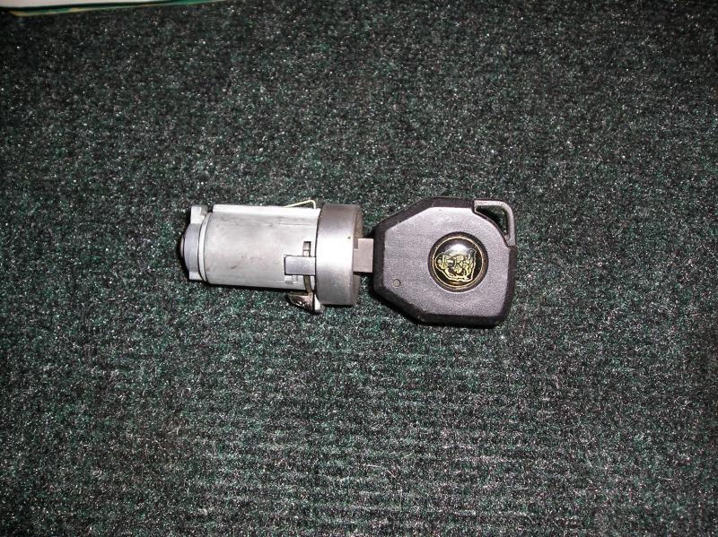

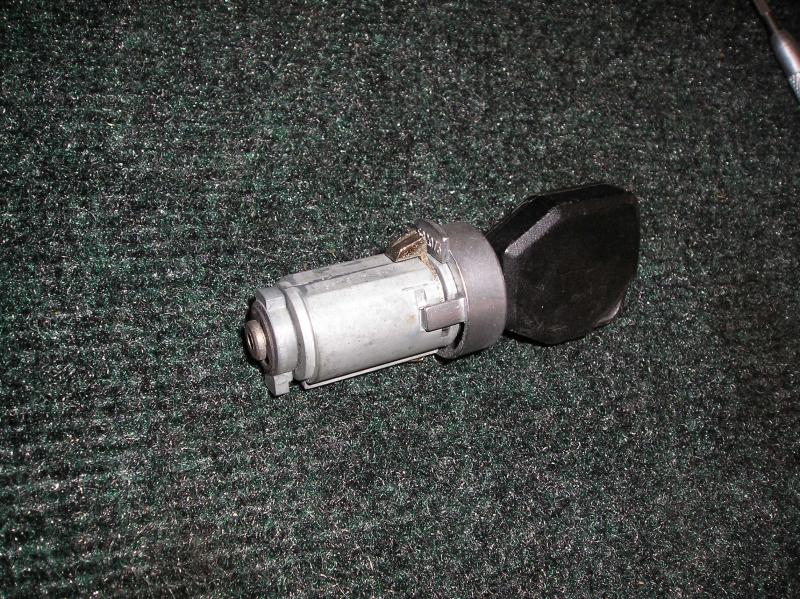

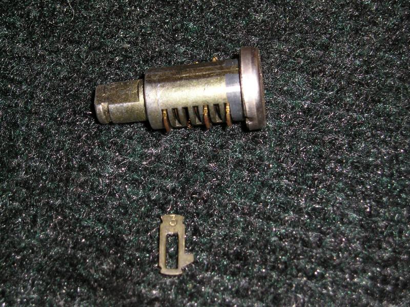

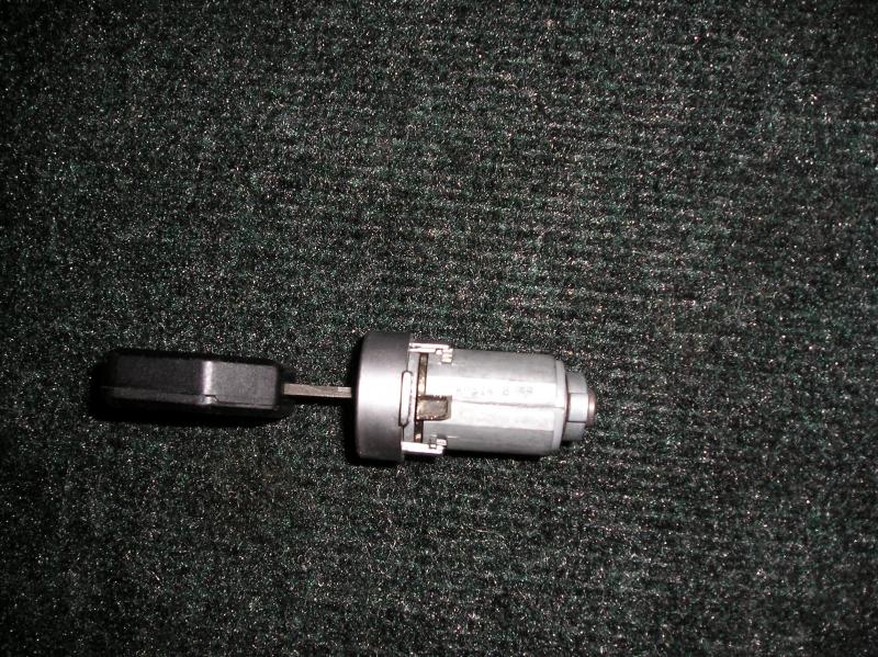

Ok Rob,
Here are some pics of the ignition barrel from an early XJ40. The shell around the key side of the barrel is extremely hard, and therefore brittle. I had a locksmith try a couple, years ago; those tabs look like they should flex outward and release the cap, but it turns out any attempt to flex them, just breaks them, because they are so hard.
That's why I just resorted to re-keying the doors to match a new ignition key. Much easier that way.
Hope that helps!
