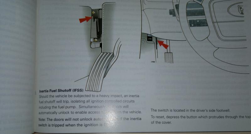

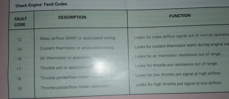

Hey, quick update
I looked at the manual and saw a topic on inertia switch . I am uploading an image so that you can see a resetting procedure for it .
I found check engine code that corresponds 12 and here is why you get it , it is from MAF according to what I found
Hopefully these will work for you

You should get a copy of the Haynes manual for this car. It is by no means the Bible, but can be helpful in troubleshooting. Page 6-7 outlines how to go about checking the MAF sensor. It may need to be replaced.
The inertia switch, if tripped, would completely immobile your car. I don't think it's related.
