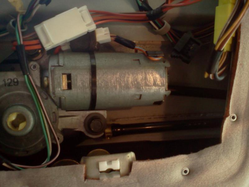

Where is the Sunroof Motor ?? It's not behind the overhead console, which does have the switch. The manual actuator is behind a small access panel in the roof lining of the rear passenger bay. It's all nothing like what's shown in the Haynes manual.
Any ideas ? Peter, Adelaide, South Australia

Mine are up under the overhead console where the switches are. The whole console needs to come out. The motor is inside towards the windshield.

I recently replaced mine.
Here is a pic of the motor before removal, overhead console already removed. The hand crank fits into the motor.
Hope this helps.
David
