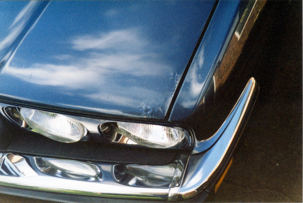

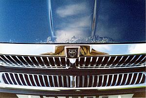

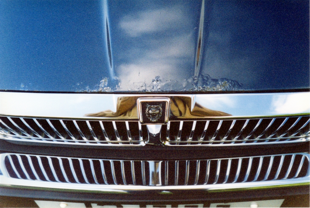

Welcome to the forum Drazen,
The problem with XJ40's in Northern Europe is RUST. Here is the bonnet of my XJ40 twenty years ago when it was eight years old:
Jaguar xj40 1991-01a-bonnet-front.jpg Jaguar xj40 1991-02a-bonnet-ns-edge.jpg
It had to be replaced as did the boot lid.
If body parts are rotted, finding replacements will be difficult so you need to be certain they are repairable.
