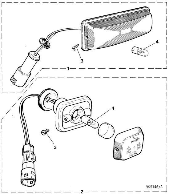

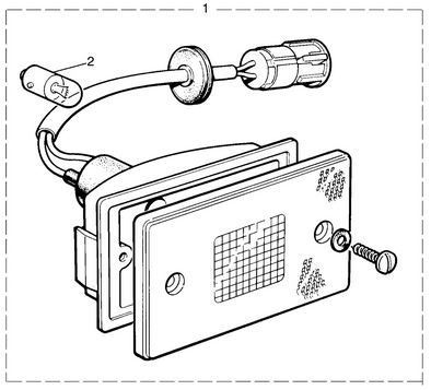

If you're asking about the side indicator lamps that fit into the side bumper extensions, the lens attaches with two screws. There is also a rubber gasket that tends to glue itself to both the lens and lamp housing, so you typically have to gently pry the lens out with a flat-tip screwdriver, plastic pry tool, etc.
If in your region XJ40s were equipped with a different style of sidemarker lamp, it may look like this:
Note the small toe screw in the side of the lamp. There may also be double-sided tape that helps support the lens connection to the body. If so, use a short section of Nylon fishing line like a cheese cutter to saw back and forth through the double sided tape until the lamp is free.
