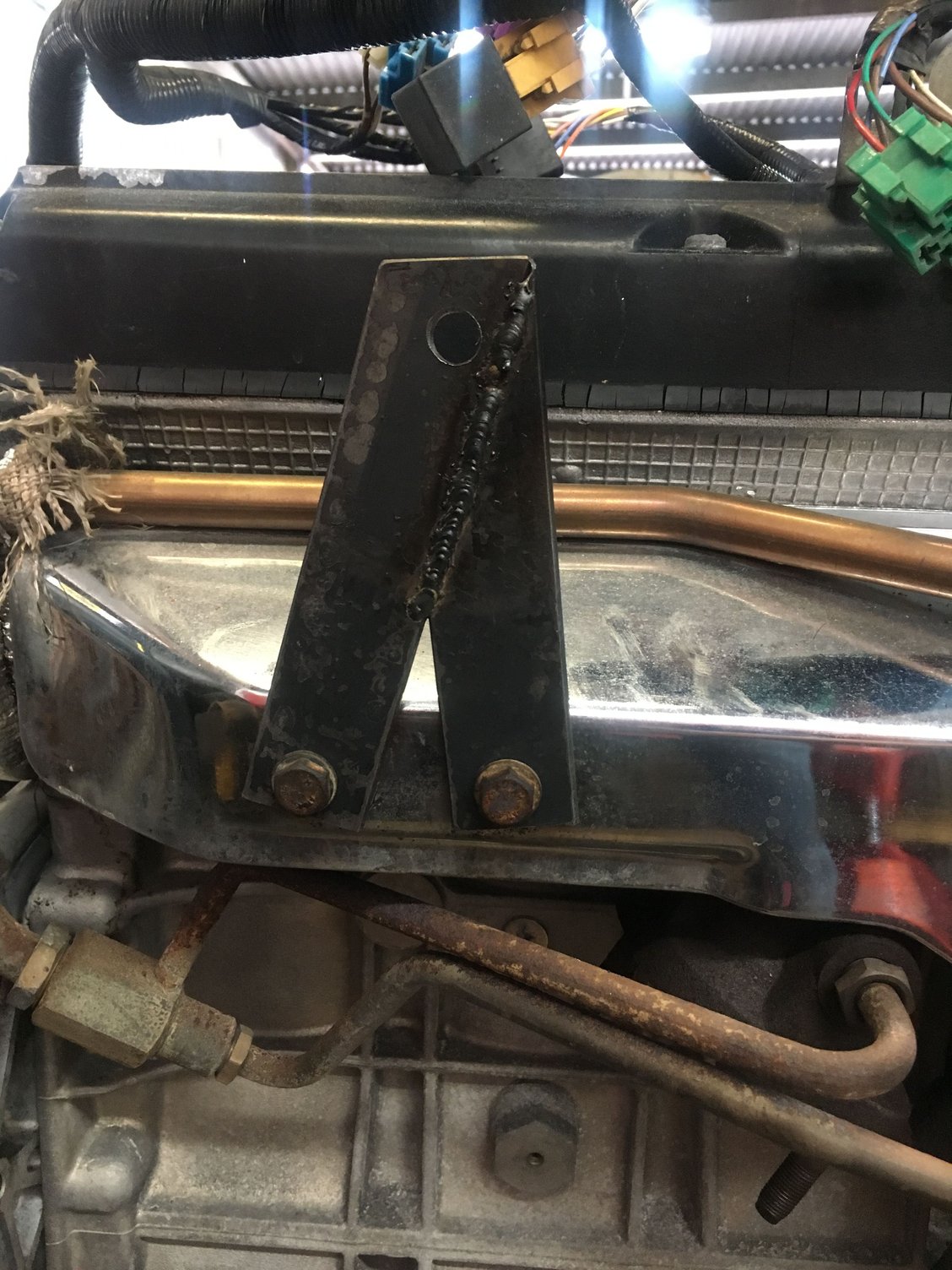

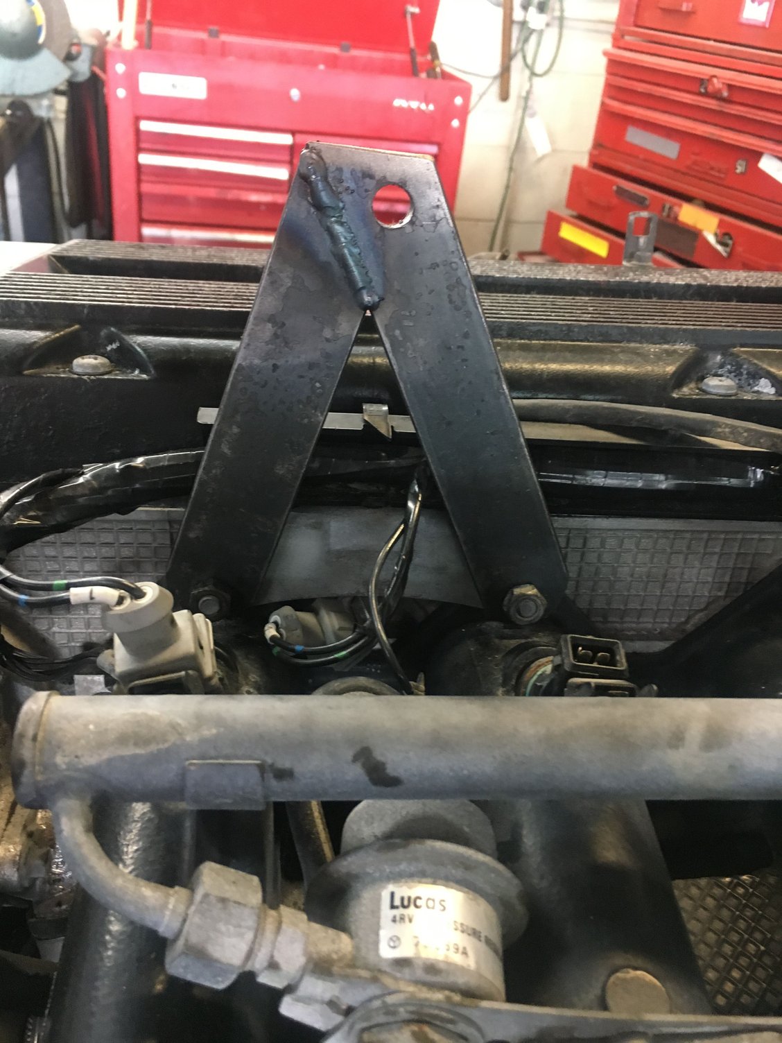

Some steel plate with a few holes drilled can be bolted to the intake studs under the fastener nuts. A bolt hole and chain can be fitted to the steel plates and the engine will hang.

Still waiting for rear seal, but made the brackets out of 1/4” weld flat. The bolts I am using on the exhaust-side bracket are longer than the ones in the picture. Feeling much more confident about this. Thanks motorcarman!
So far have installed front main seal, motor mounts, valve gasket, hose-o-rings lots of cleaning and painted a few things.

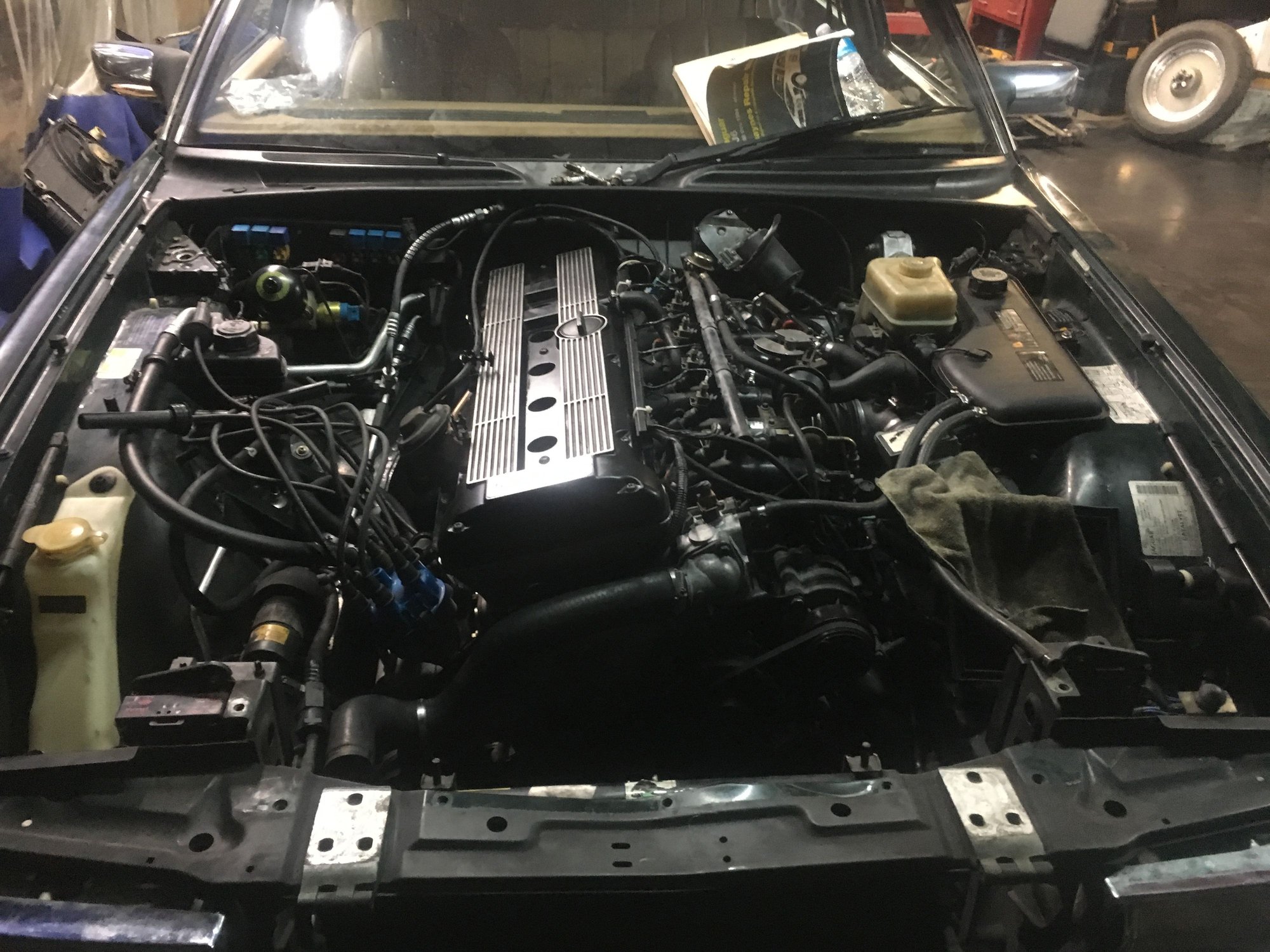

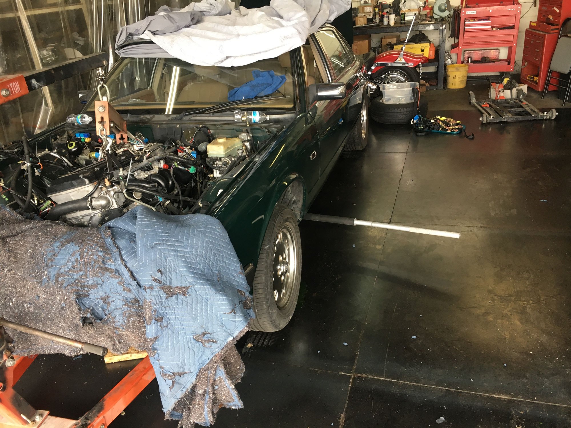

So I got the engine in... I wouldn't suggest doing it this way. Took a jack on the tranny, loosening the rack and a long 2x4 on the front of the engine to get it in position. My engine lifts, arm wasn’t long enough, but close enough to try to get it in anyway.
I’m sure if I had an A frame or a way to do this from the ceiling it would be more doable. Next time I’d do engine first and then trans. It really would have been easier.
Angle gets pretty crazy going in. Didn’t like all the weight on the chain that came with the leveler. Borrowed a beefier one to put it in
Had to use a jack on the tranny.
Got it in and mostly hooked up. Few more hours more to go.
