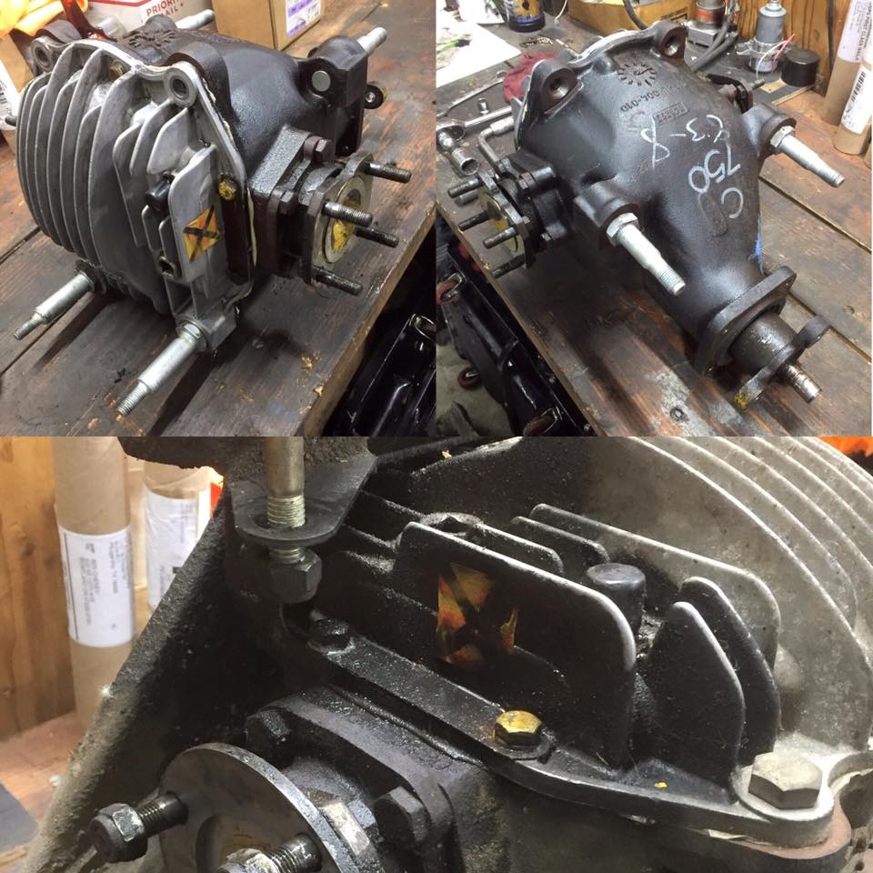

For those who want to check their car or a donor car; look for this sticker. The significance is the black X for Power-Lok, the colors designate the gear ratio (3.58 in this case).
