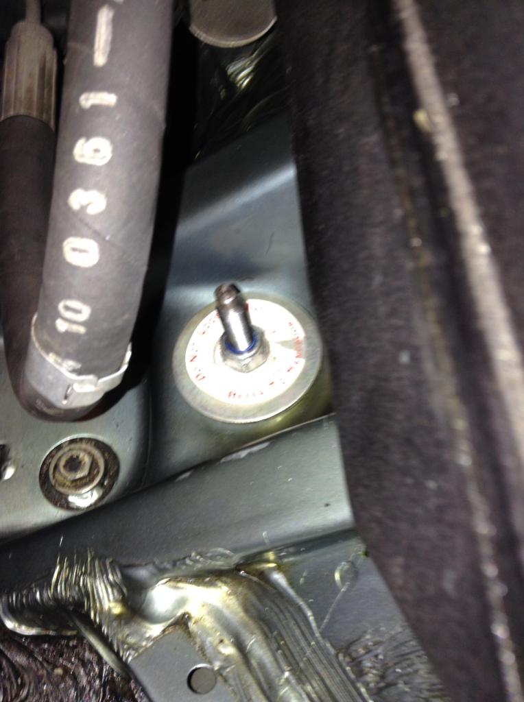

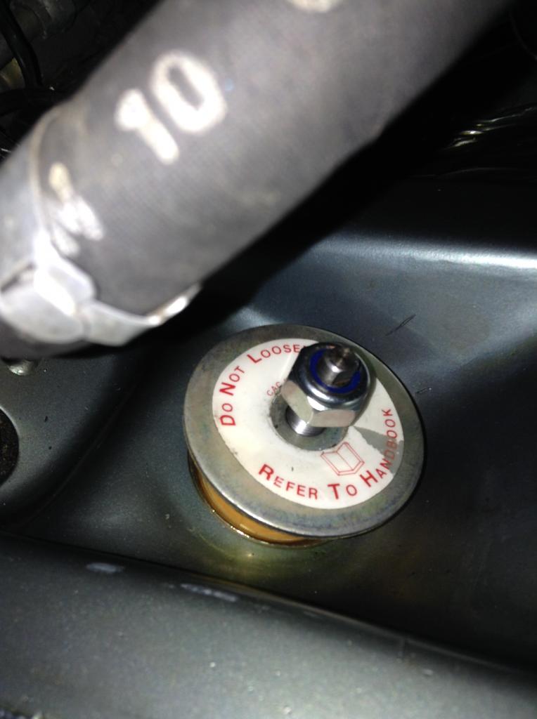

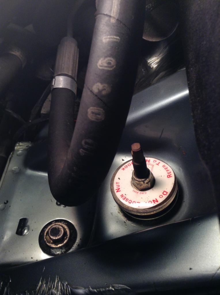

Remove the shock upper mounting nut. You may need to remove items to gain access, depending on your model year, and which side of the car you are working on. My 1992 required removing the nut securing the coolant expansion tank, which could then be rotated away to gain access to the nut.

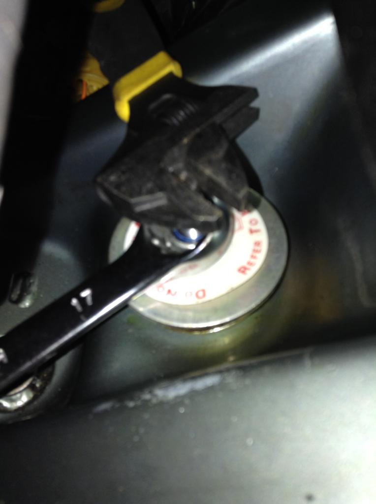

Using an adjustable wrench, or similar tool, grasp the flats on the top of the strut rod to keep it from rotating while you loosen the securing nut. On my vehicle, I was able to use a deep socket to get the nut loosened about a third of the way. If you jack up the suspension too much, you’ll take the weight off of the top mount, which will usually make it harder to remove, as everything will want to spin on you.
Remove the nut, washer, buffer (bushing), and cup washer and set aside. Your new shock may or may not come with these parts. My Sachs Super Touring shocks came with all of these parts.

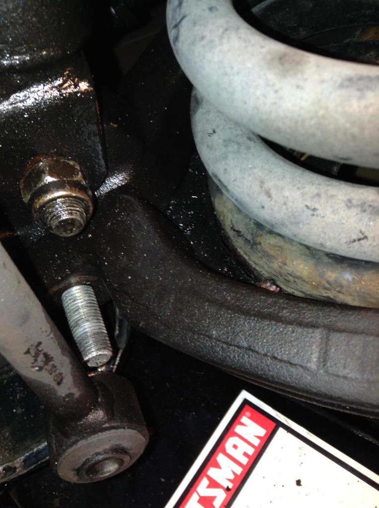

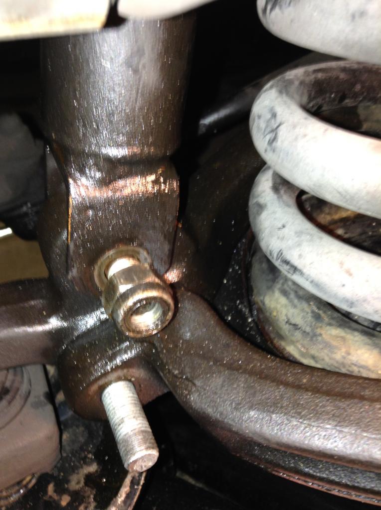

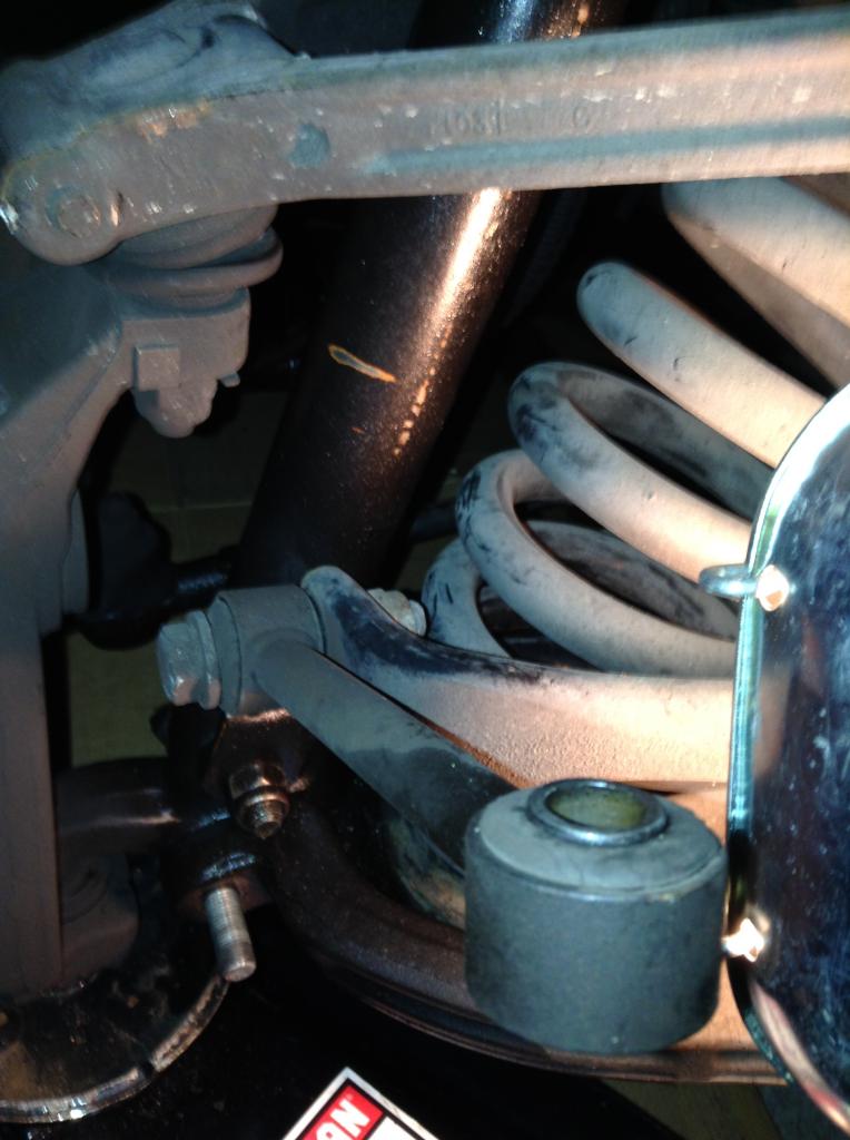

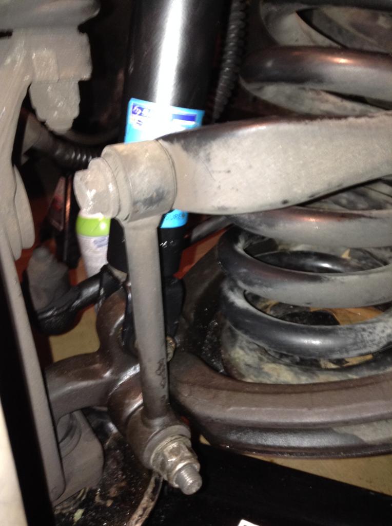

Before you can access the lower shock mount nut and bolt, you’ll have to remove the sway bar end link nut, and swing the link out of the way. On my car, I loosened the nut almost the end of the bolt, and tapped the nut with a hammer to slide the bolt back through its hole. I then removed the nut and pried the bottom of the link towards the end of the bolt to free it. The link can then rotate up and out of the way. You don’t need to remove the bolt.

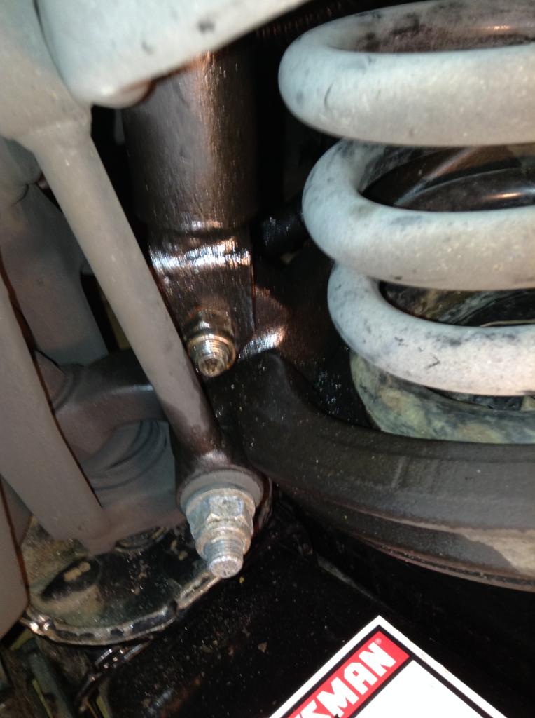

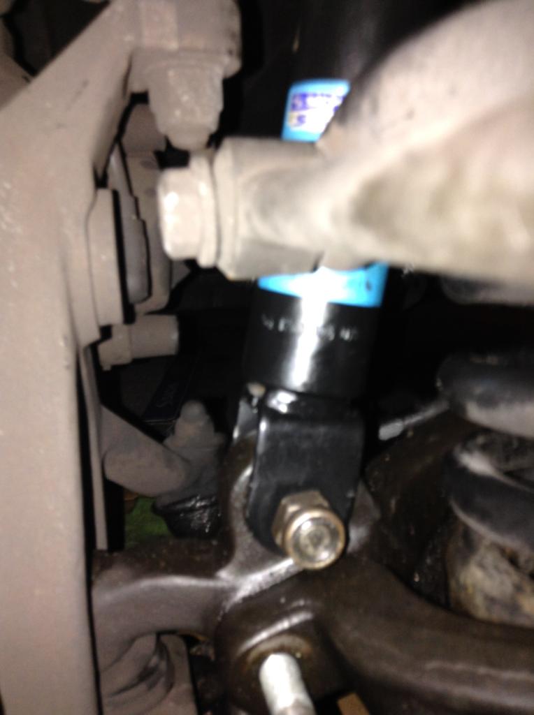

Now you can access the lower shock mount bolt. Remove the nut and bolt.

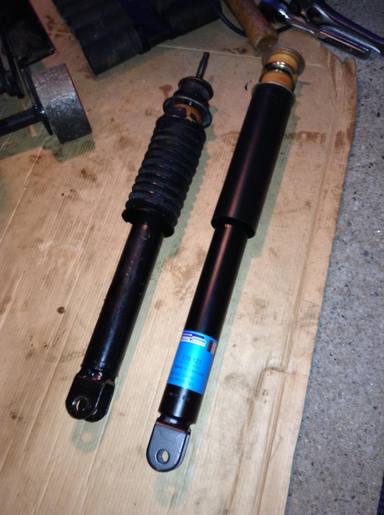

Manually compress the shock down, and remove it from the vehicle. This is easier said than done if your shocks are pretty healthy like mine were. If your shocks are shot, they probably are begging to come out, and will take a while to extend back (if they can even extend on their own anymore…)
Once the shock is out, be sure to keep the washers if you need them.
You can take the time to clean up the road grime and/or shock oil that gets sprayed everywhere (as you can see in the pictures of my car) and check the condition of the bushing on the lower mounting area, as well as the mounting surface at the top.
Get your hardware together on your new shock, if it doesn’t already come with it.

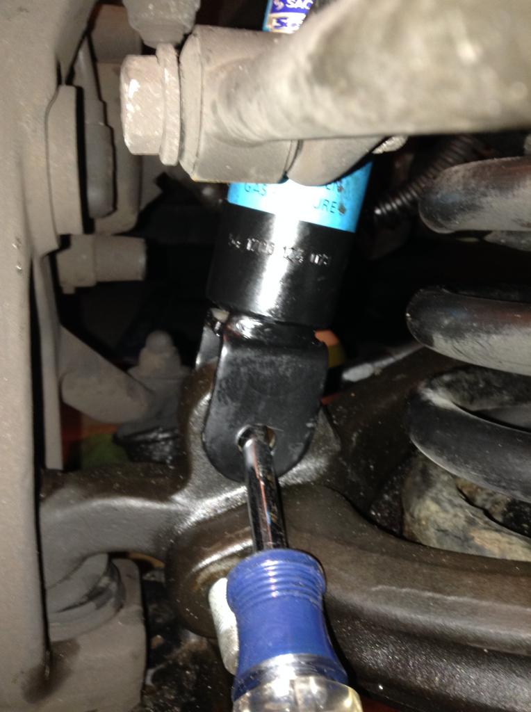

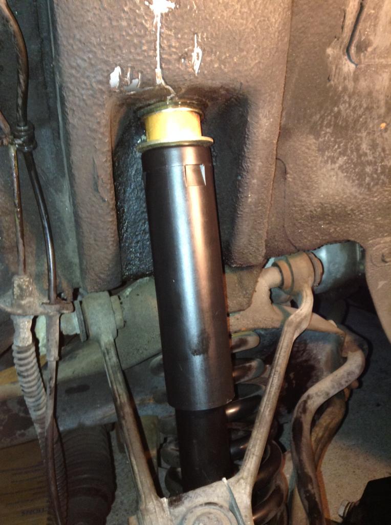

It might be a fight getting the new units in. I compressed mine on the floor and held it compressed while inserting the shock between the upper wishbone, and down into position over the bottom mount. I had to compress it down again to get the strut rod through the hole in the body.

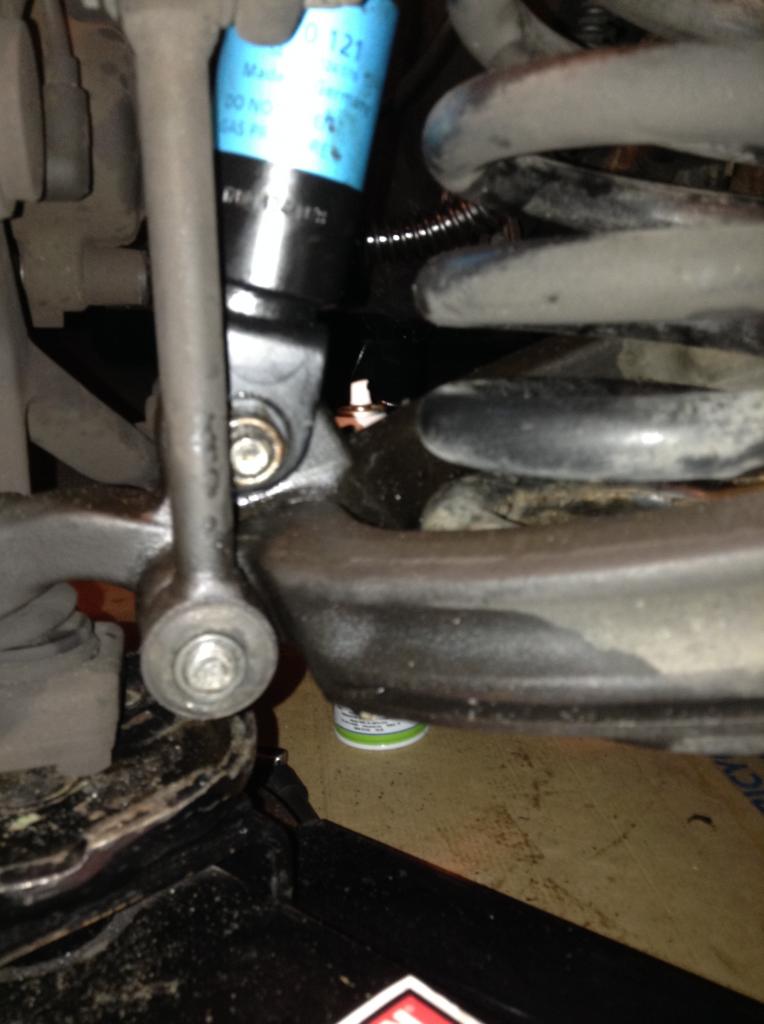

Install the lower mount nut and bolt. I found that using a screwdriver to pry inside the opposite end of the bushing helped to align things when inserting the bolt. Tighten the nut to 50 foot pounds.
You can swing the sway bar end link back down onto the bolt. I lightly used a hammer to tap it back on while pulling down on the sway bar to get the end link aligned. Install the washer and nut, and tighten to 44 foot pounds.

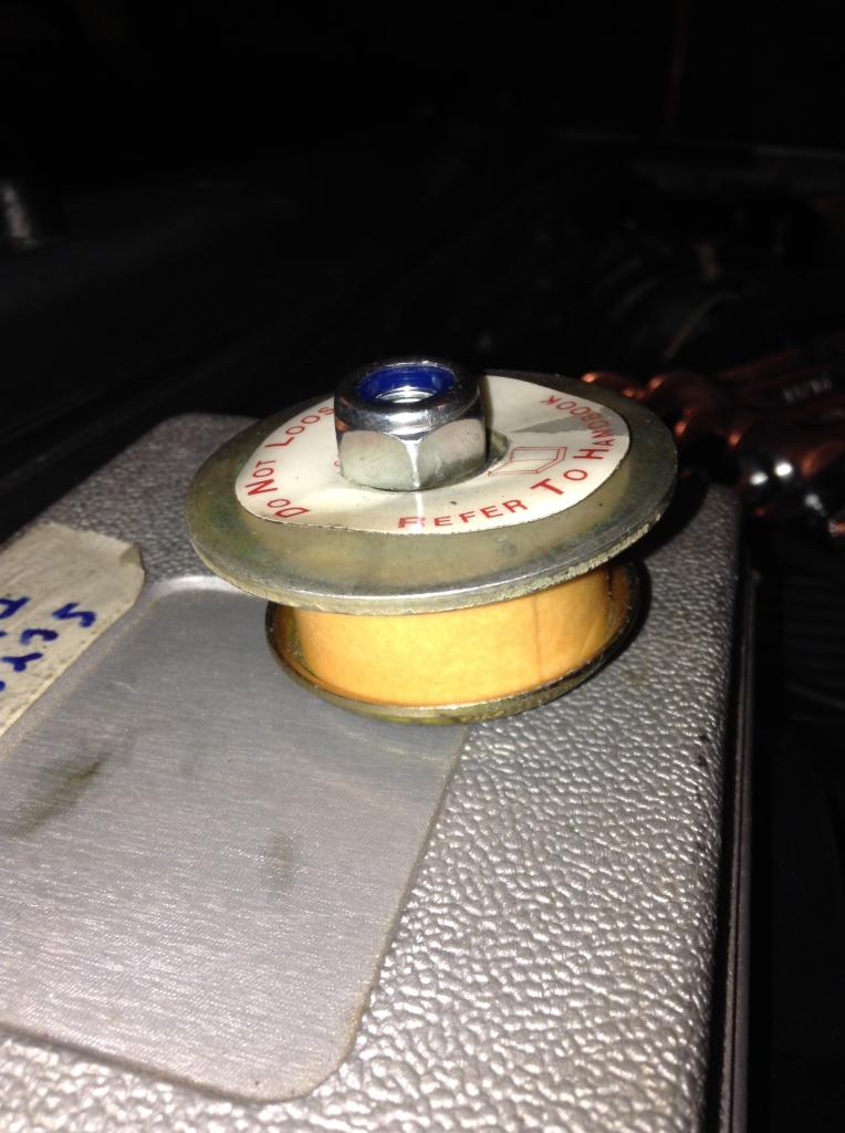

Install the top mount hardware (cup washer, buffer, flat washer, and nut) using and adjustable wrench to keep the shaft from rotation while you tighten. This is probably the most time consuming step in the whole process. A ratcheting wrench would be very useful here. Make sure these are completely tightened. With the bottom of the suspension only being supported by the jack, there should be no space between the bottom set of hardware (cup washer and buffer) and the body when looking through the wheel well. Make sure the top nut is tightened to 30 foot pounds. This may be difficult to measure unless you have a torque spanner.
