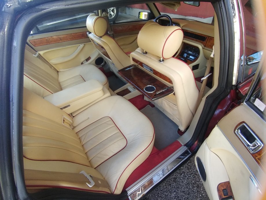

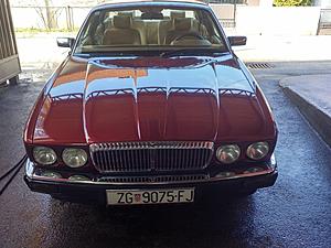

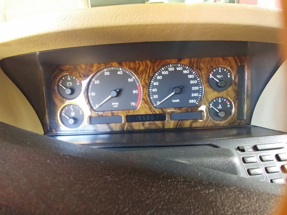

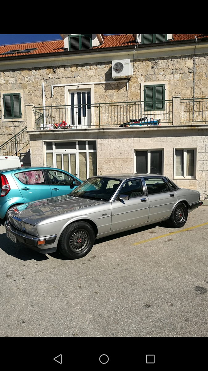

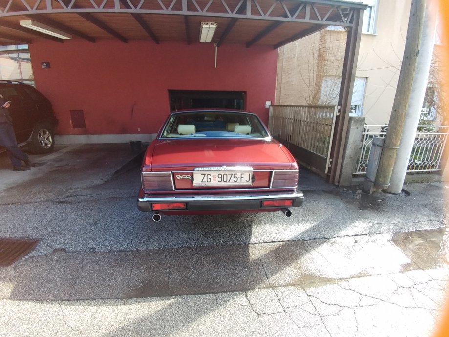

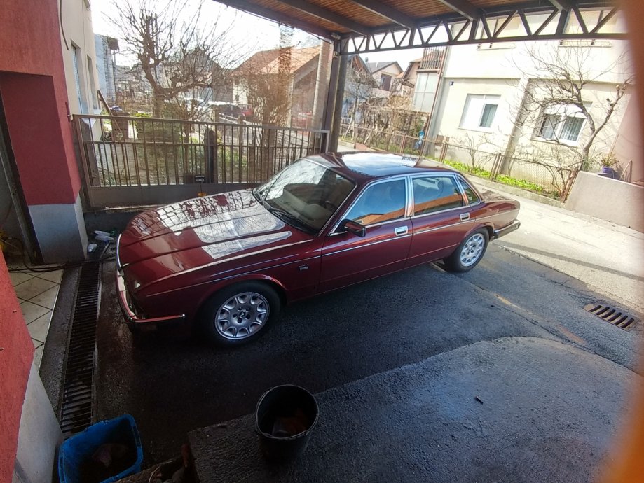

Hello everyone, I'm planning to buy my 1st Jaguar.
Here are my two candidates, both XJ40's. One is red burgundy(not sure if that's official name), and other one is silver. Both have similar milage (silver has 187 000 km's, red has 25 000 km less), and similar price (red is 500€ more expensive).
Red one is listed as "XJ 40 Diamler 4.0 automatic" and silver "XJ40 Sovereign 4.0 automatic". I just need few advices before going to see cars in person. What to expect at that milage regarding engine,transmission and suspension, I'm aware of rust problem.
As well, which one is "better" deal..
Pictures 1-5 are from red car, and 6-10 from silver.
Thank you very much.
Best regards.
Attached Thumbnails Need quick buying tip-1.jpg   Need quick buying tip-3.jpg   Need quick buying tip-4.jpg   Need quick buying tip-5.jpg   Need quick buying tip-6.jpg

Hi JanL17,
The Daimler will have higher-quality leather that is softer (when properly conditioned), but also more fragile and more time-consuming to redye due to the contrasting piping. The wood veneer trim may also be of higher quality, with contrasting boxwood "matchstick" inlays. The Daimler grill and boot/trunk chrome finishers are fluted. The wheels on the red one are from an X308 (XJ8 sold from 1997-2003); the wheels on the silver one may be original but appear to have been painted black or rubberized. Otherwise, the cars are essentially identical mechanically.
Aside from rust in the wheel arches, below the rear windscreen/backlight, on the suspension crossbeams/subframes and anywhere else, other things to look out for are:
Worn or perished suspension bushings that can cause imprecise steering, knocks going over bumps, uneven tire wear, etc.
Failing wheel bearings (especially fronts);
Failing differential output shaft bearings (look for leaking oil on the sides of the differential and listen for howling sounds from the rear end);
Failing differential pinion bearings (listen for a jet-engine whine when you let off the accelerator pedal and coast);
Sagging headliner;
Oil leaks, notably on the right rear corner of the camshaft cover and right front corner above the distributor (head gasket), and on the left side of the engine at the oil pressure sender, oil filter housing and cooler hoses/bypass pipe, the oil filler tube and dipstick tube gaskets;
Check the steering rack boots/gaiters for signs of leaking fluid that may indicate the need for a rebuild or new rack;
Check the instrument cluster to confirm that when the key is turned to position II (ON/RUN), all the warning lamps illuminate briefly, then start the engine and confirm that all the warning lamps extinguish within a few seconds (the BRAKE and/or ANTI-LOCK lamps may take a little longer to extinguish).
Check the Vehicle Condition Monitor (VCM) for any stored diagnostic trouble codes (DTCs): turn the key to position II (ON/RUN) but do not start the engine; press and release the VCM button on the trip computer next to the steering wheel; watch the small display window below the speedometer where the odometer/mileage indicator normally appears; DTCs will be in the form of FF or Fuel Fault and a two-digit number (the earlier 3.6L/2.9L cars used one-digit numbers). Look up any codes that appear in the Haynes Repair Manual, which you can download here:
Haynes Jaguar XJ40 Repair Manual
Check that all the power door lock actuators are locking and unlocking and that all the door handles are unbroken. The top edge of the handle should be parallel with the outer frame. If it dips at one end, it is probably broken.
Test the brakes and watch the instrument cluster for the BRAKE or ANTI-LOCK lamps to illuminate - if they do, there is a problem with the hydraulic power boost system.
The Jag-Lovers Forum XJ40 eBook will give you an idea of a lot of things that can go wrong and how to repair them:
Jag-Lovers XJ40 eBook
Read the section in the eBook on Self-Leveling Suspension. Most cars have, by now, had the original rear SLS suspension replaced with conventional shock absorbers and revised springs, but if that hasn't been done on one of the cars you are considering, the SLS was known for leaks and failing rear shocks.
Hopefully others will chime in with things I've forgotten to mention.

Daimler with VDP trim - Even though the trim is noted as being VDP, the VDP designation isn't used in Europe, they are all called Daimlers over there.
Jaguar couldn't use the Daimler name in N America as that brand was owned by Daimer/Chrysler (AFAIK)
As this chart is an up 1992 code translator and the red car is a 93 maybe some details are changed, e.g. Daimler is one of the the highest trim levels certainly not a "base" car!
BTW the Daimlers and VDP's had every bell and whistle Jag offered at the time.

Congratulations on your new Jaguar! She's beautiful!
The article at Wikipedia gives some of the details about the Majestic:
https://en.wikipedia.org/wiki/Jaguar_XJ_(XJ40)
If I recall correctly, the piping in the Majestic seats was "Mulberry," or a shade of red. If the piping in your seats is a light brown, it is probably the same combination we had in our 1993, which was called "Coffee and Cream," a very handsome combination.
P.S. Did you have the wheels changed already? The ones in your original photos are the X308 Starburst pattern, but in your most recent photos the wheels are the XJ40 Lattice pattern.

Neither car has done a huge mileage, and the €500 extra for the Daimler may be well worth it if the car has been well looked after as the interior trim of the Daimler is to a very high standard as you'll see when you look at the car. However even if the car is immaculate, do make sure to check for evidence of regular servicing and maintenance with service records and invoices. When a car gets to this age, this is what counts the most. The Daimler does look to be a very nice car, frankly. 18 years with one guy means it is likely to have been looked after.
What prices are the sellers asking ? Not too much, I hope !

Interesting info on the wiki link. That confirmed the M designation for Majestic in the USA.
I see now that the pictures of the Daimler show seats with brown trim. When I saw the red carpet my mind saw red seat trim which reminded me of the Majestic for sale in my area.
So the Daimler for sale is not a Majestic, but it sure is desirable! Wiki said that in 1993 only 121 Majestics were made and they were specially stretched to become long wheelbase models.
Let us know what the car is like JanL. Hope it all works out and you become a classic Jag owner.
