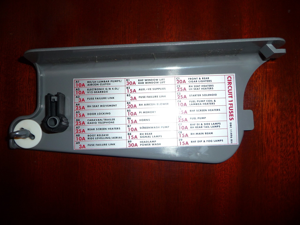

That's a very nice looking car you've found. The brake warning light could be a damaged brake wear sensor which is triggering even though the pads are fine.
Hopefully this is the correct side fuse box!
David

Thanks for the pic and sorry for late response. That is not the correct side. My fault, I assumed Circuit 1 was drivers side. I need Circuit 2 or the drivers side box. This is going to be a hard one to pinpoint as it is not a blown fuse it is a short somewhere else (intermitent fuse light).
Thanks
