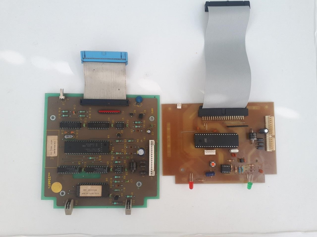

Regarding the CD caddy, I actually have both old and new! I had seen that you have been producing the boards for the later ATAPI CD ROMs, and before I got hold of a PDU I had always planned that, if I did get one, I would send you a message to see if I could purchase one of the new boards from you (assuming any system I acquired had the older board). However, when I got my system it clearly had a newer CD ROM installed, and when opening the box I found it has some "other" updated board which someone has obviously home-made at some point. This was a bit of a surprise, as the only aftermarket board I was aware of was yours.
My old and "new" boards:
No real markings on the new board except "FDS 2000 ATAPI DRIVER" and "SFC 02-2010", making me think it was made in Feb of 2010 by SFC, whoever they are!
I can confirm that it works anyway. As well as the old board, my system came with a very tatty old Sony CD ROM. I decided for the hell of it to try and recommission the Sony drive using some new Capacitors, following the instructions linked to on this very forum. It does not appear to have worked, unfortunately. But I can't be sure whether the fault is with the old board or still with the Sony drive.

The board on the left is the old circuit board for the Sony drive with caddy, the board on the right is an ancestor of the board I am building. If you buy one from me you will get the same only the circuit board is green coated so you are good!
