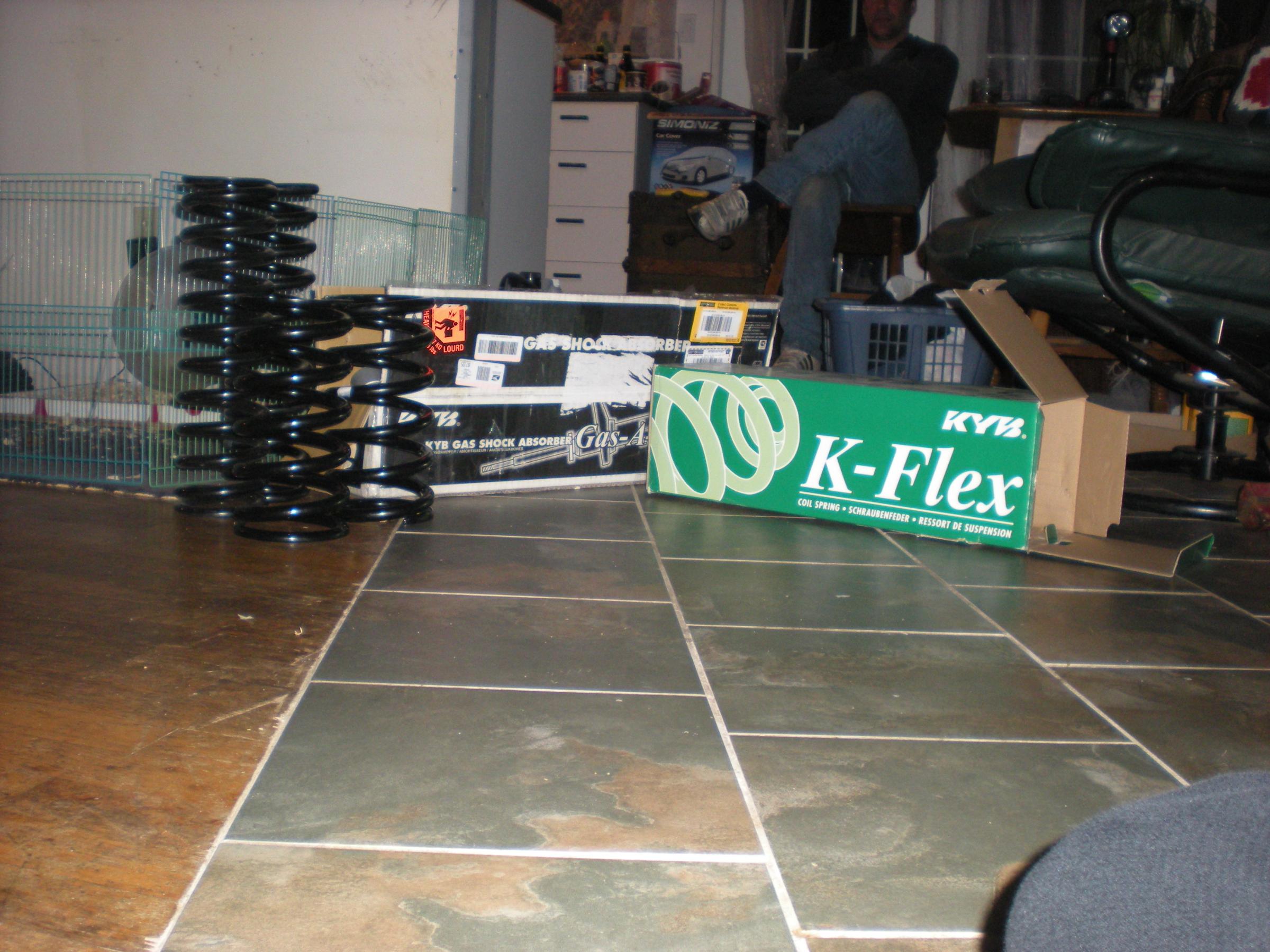

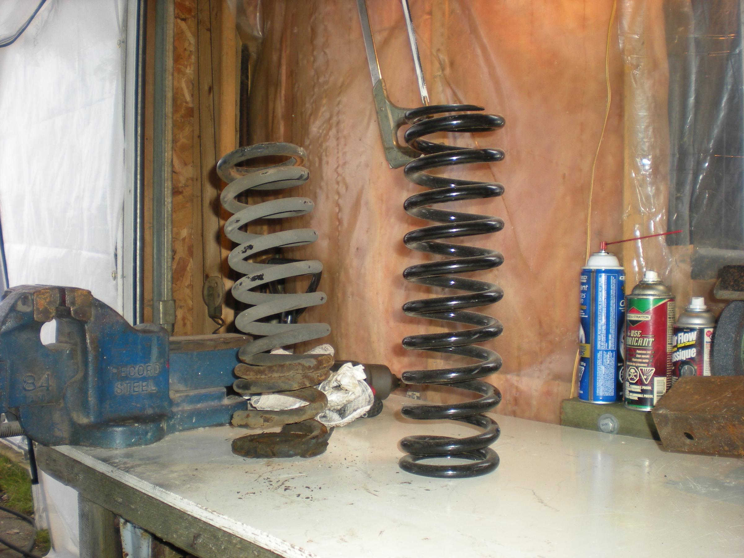

Default new parts are here!
well,some new goodies arrived finally.new kyb springs and shocks all around for our "champ" car.
but how to install,well,redd is parked in front of the cave so I went about making the correct tool to do the job.
I started with a length of HI STRENGTH steel redi-rod in 3/4 dia.N/F thread.
File a small "flat"on one end to receive a center punch mark.You must get this right!
the hole drilled must be centered exactly!
The pin i am using is the shank of a grade 8 bolt sawed off,measuring .2815 diameter.
I found a drill bit measuring .280" diameter,cross drilled and the pin went in as a "gentle tap" fitment.
I just measured the slot on the car to get the length right,1.325".
I filed off the edges of the pin and went for a test fit,seems good.
Now to get the angle for the bottom bit,using a short hunk of pipe,saw off the correct angle and test,again,the washer used is HIGH STRENGTH!
Test fit,seems ok.
Now to weld it up,again,test fit.
Cross drill a hole at the other end of the drawbolt to reference the position of the main pin.
I made the whole assembly 22" long,tried it out,and ten minutes later the spring is out and on the bench!
The final pics are of the pin end after being used,with no ill effects so far.
It does help to add some oil to the "cup" of the assembly to lube the draw nut.
Just for reference the stock spring,and the new KYB are the same length and diameter,so the stocker is going back in the red car with a small modification to the upper and lower spring seats.
Besides,IT'S TOO COLD OUTSIDE! to work on the car for too long...
