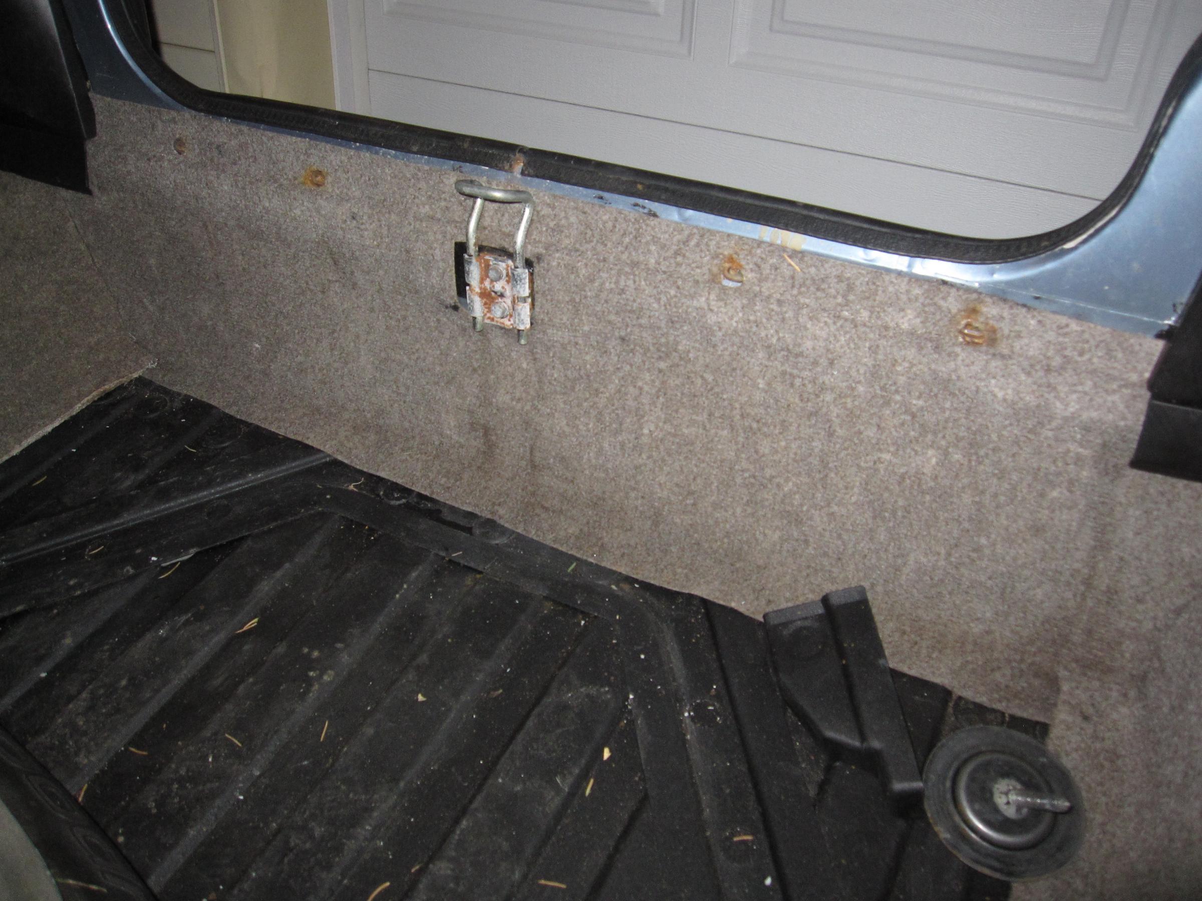

It looks like it may be coming from the plastic grommets that are on the inside of the trunk/boot area, right along the top carpeted edge by the bumper. This one sort of has be baffled: how would water even get in there? Isn't it a boxed section of somesort?

This water is definitely coming from the rear bumper edge of the boot...just not sure if it's coming in directly from those mounting grommets for the rearmost inside trim piece, or if water's just trickling down from the trunklid, and working it's way down there...
