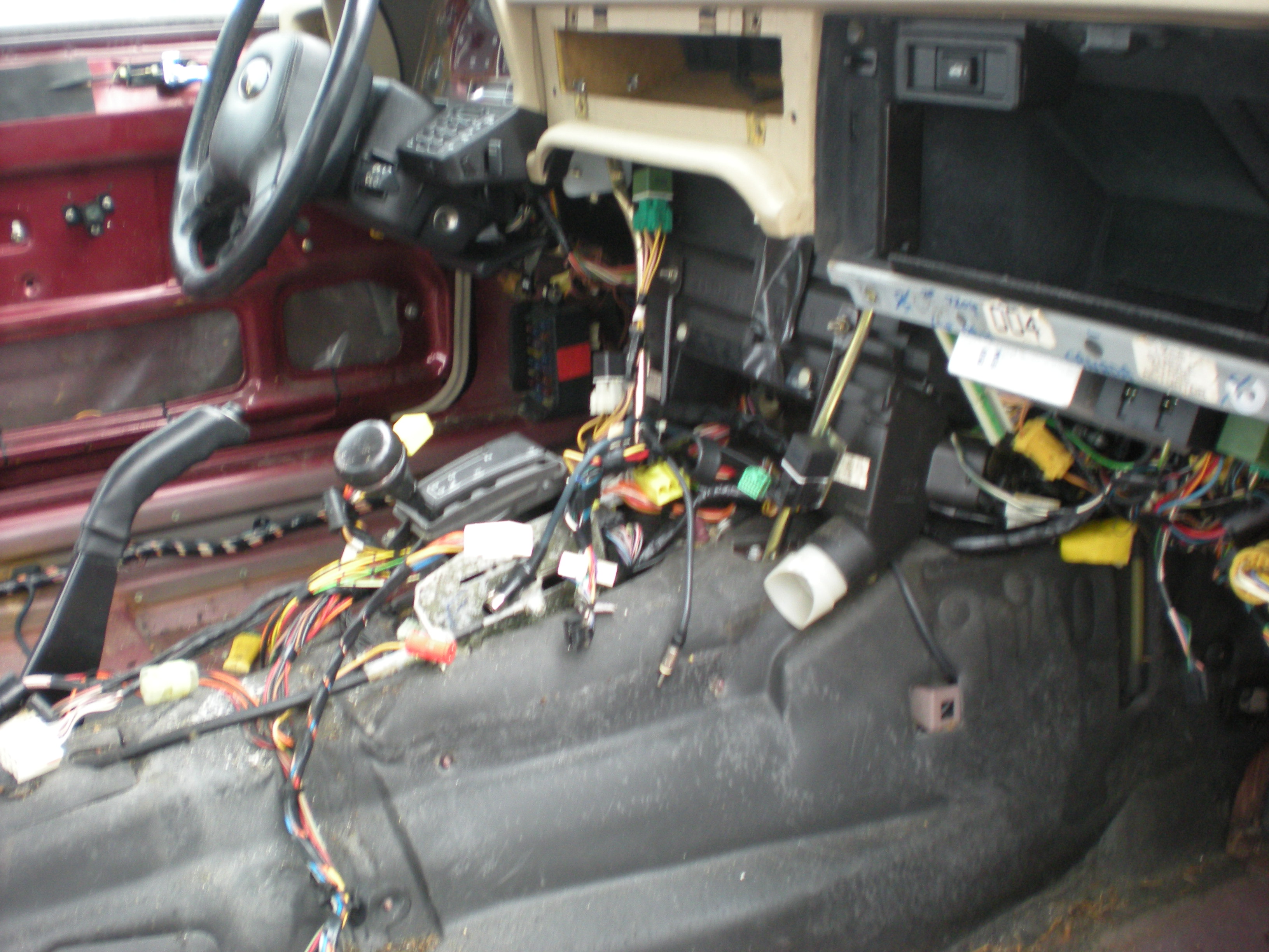

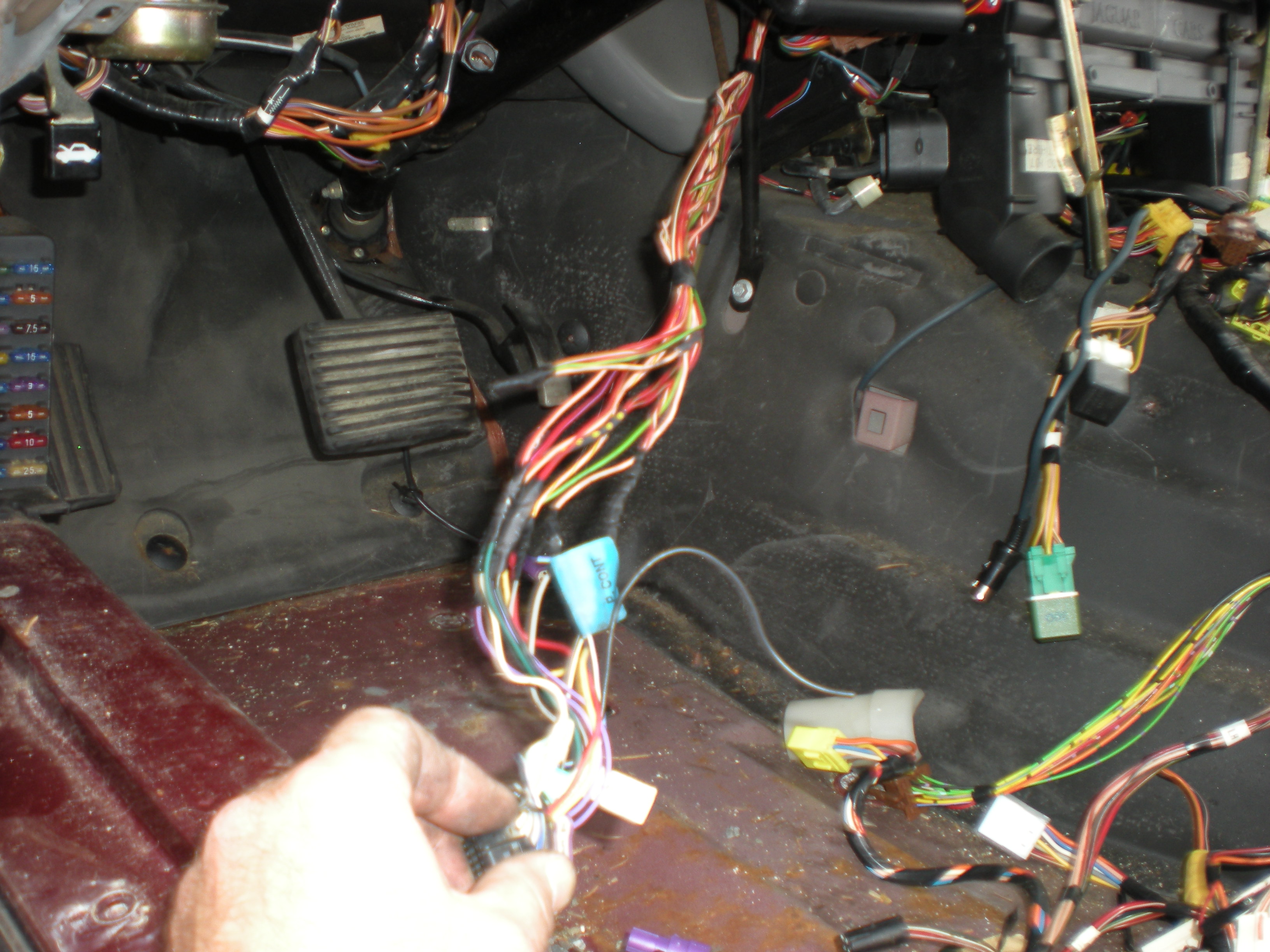

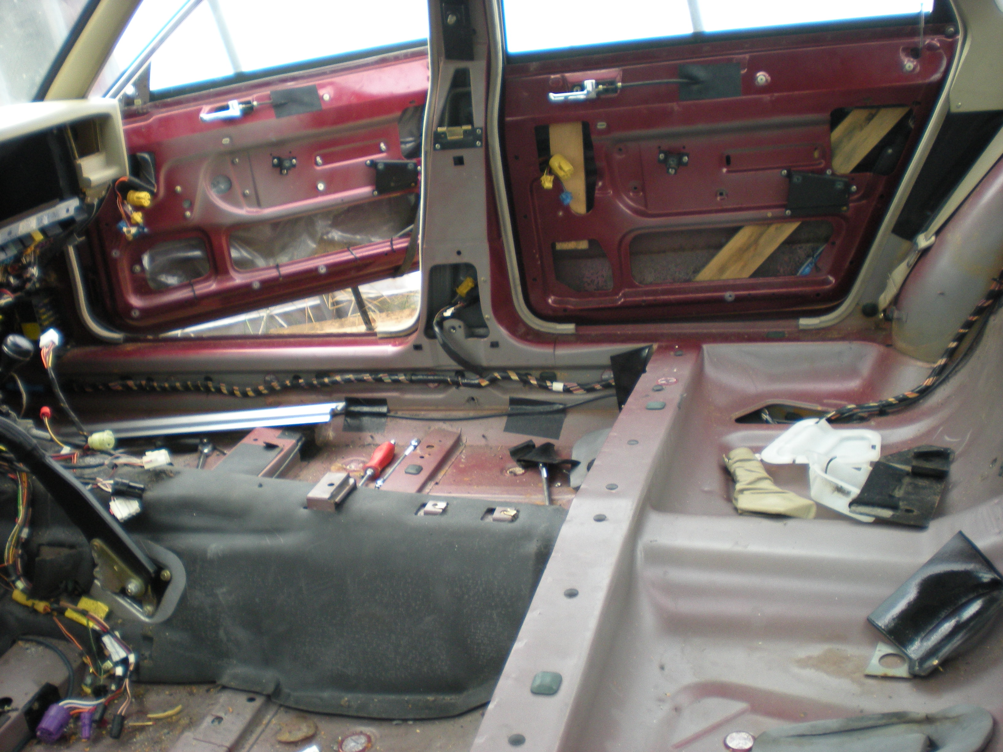

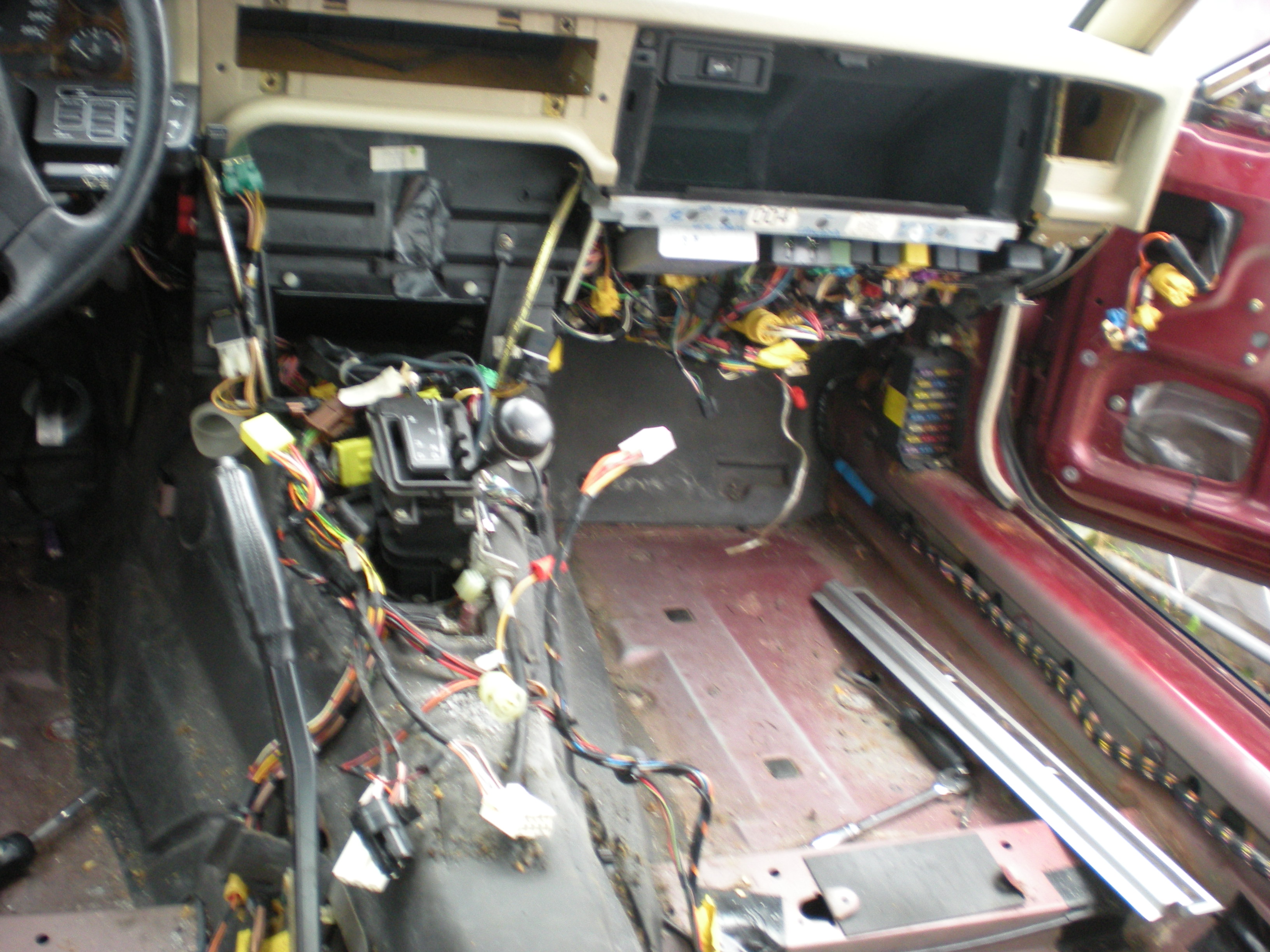

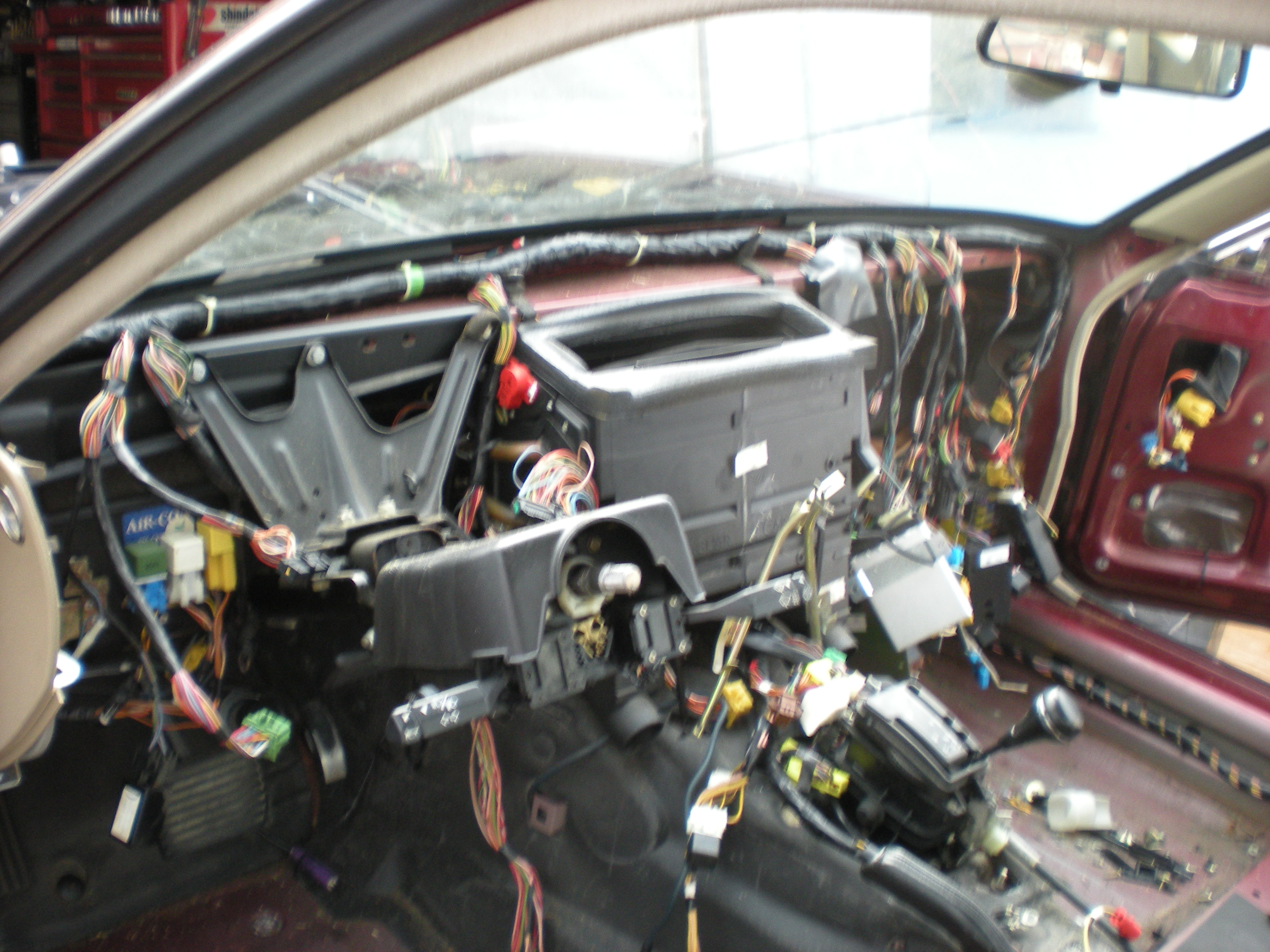

More pics to post,It's been a slow go lately,old man,bad back,yadda-yadda.
Got the interior just about stripped,and now to tackle the wiring under and within the dash.
The pic of my hand shows the wiring for the radio,and where all the wires join up before the radio.
This is the point you have to get to,to re-make the connections for a modern radio unit.
Apologies to those who wait,it IS coming!
Cheers,Jim.

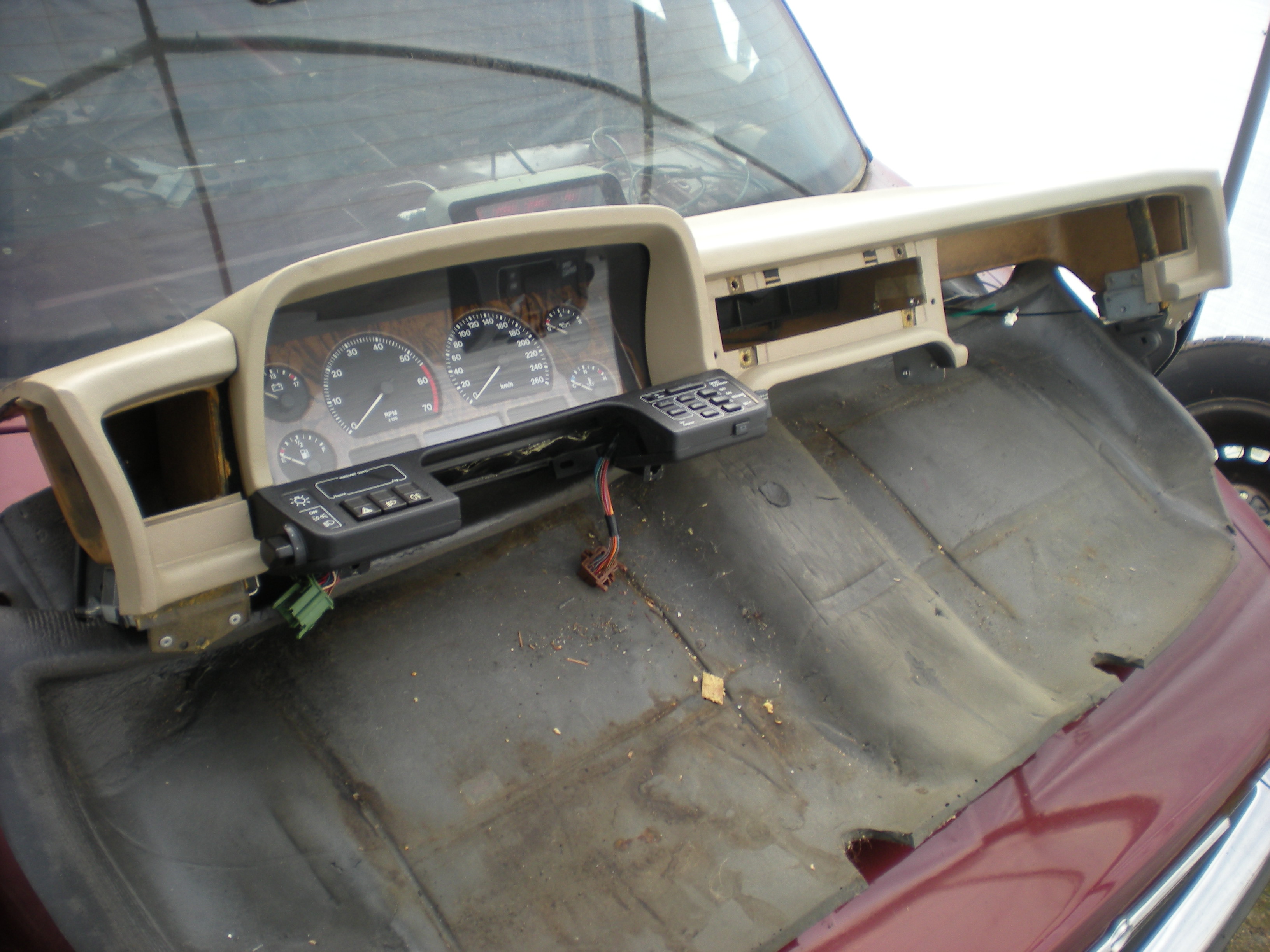

Default Off with it's head!
Dash removal,easy,4 bolts,a few connectors,remove steering wheel,lift clear.
Sooner or later I am gonna be good at this....
Jim.

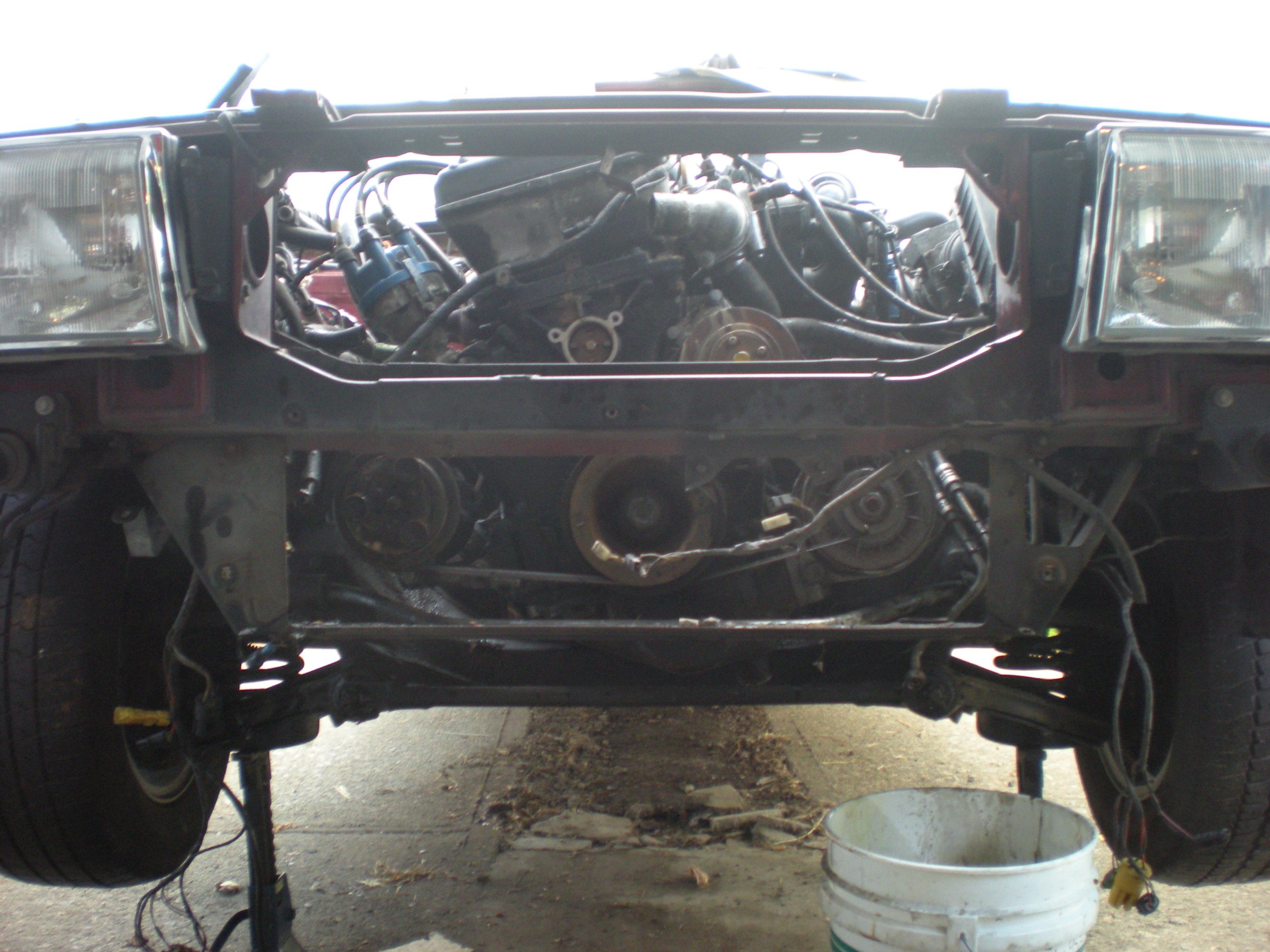

Default Front of the engine

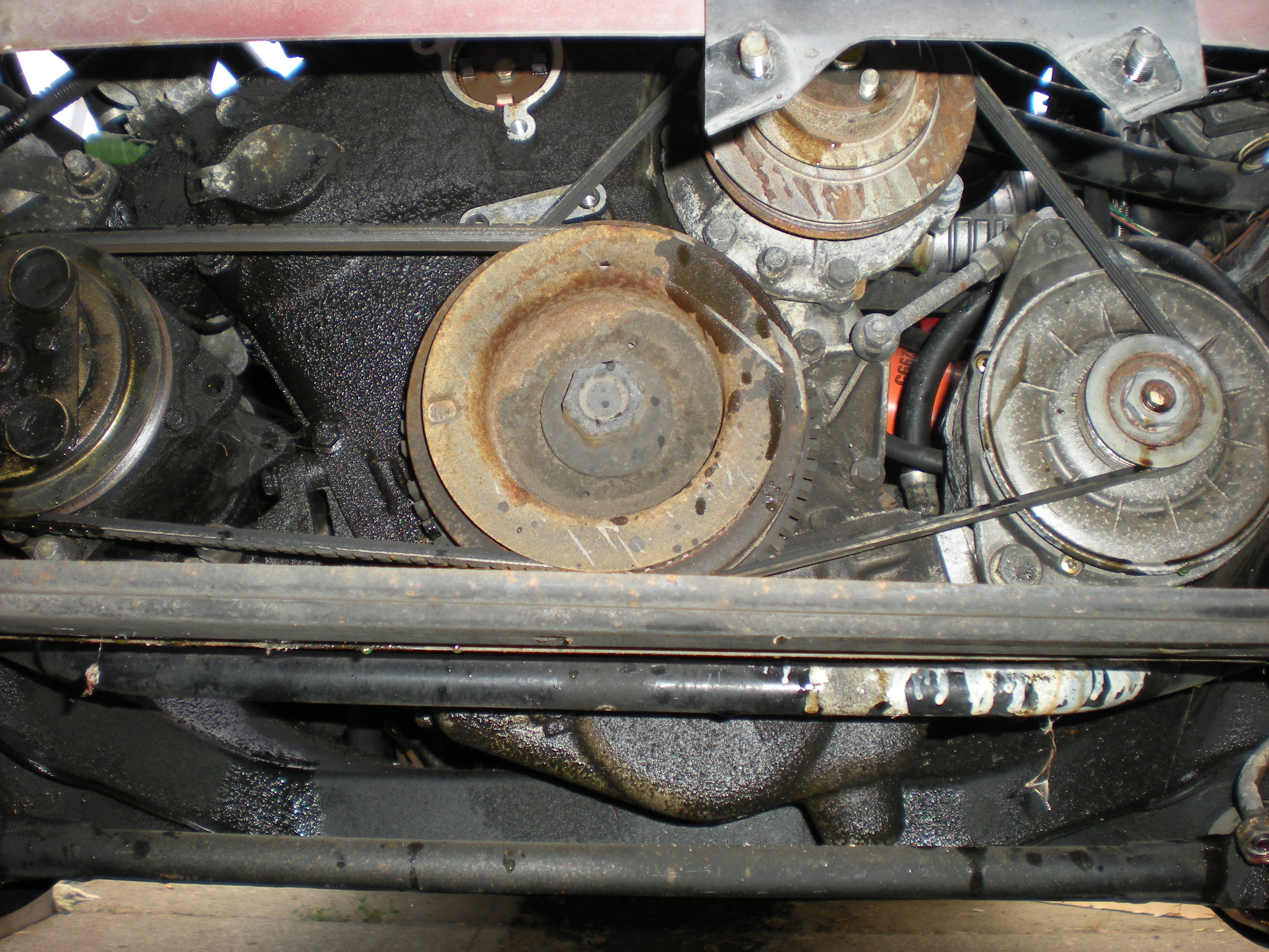

With the sun coming out,it's time to turn attention to front of car.
Pull the fan,rad,condensor,oil cooler,hydraulic pump,CPS,to gain easy access to the harmonic pulley.
Lunch time,more to follow,lots of nifty parts here.
Cheers all,Jim.

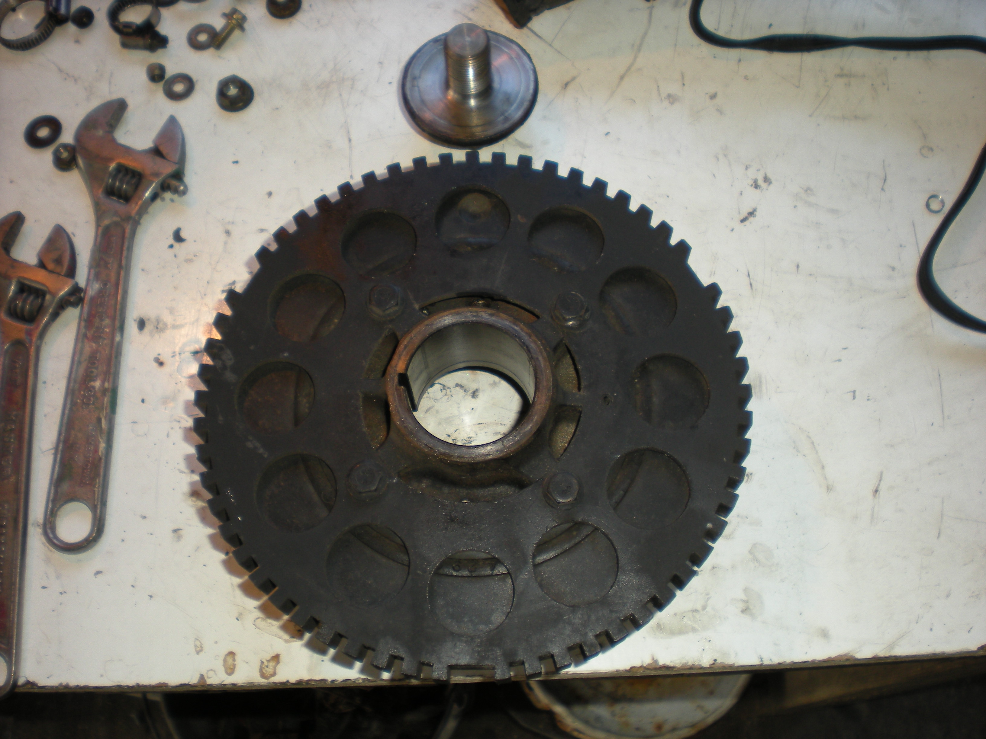

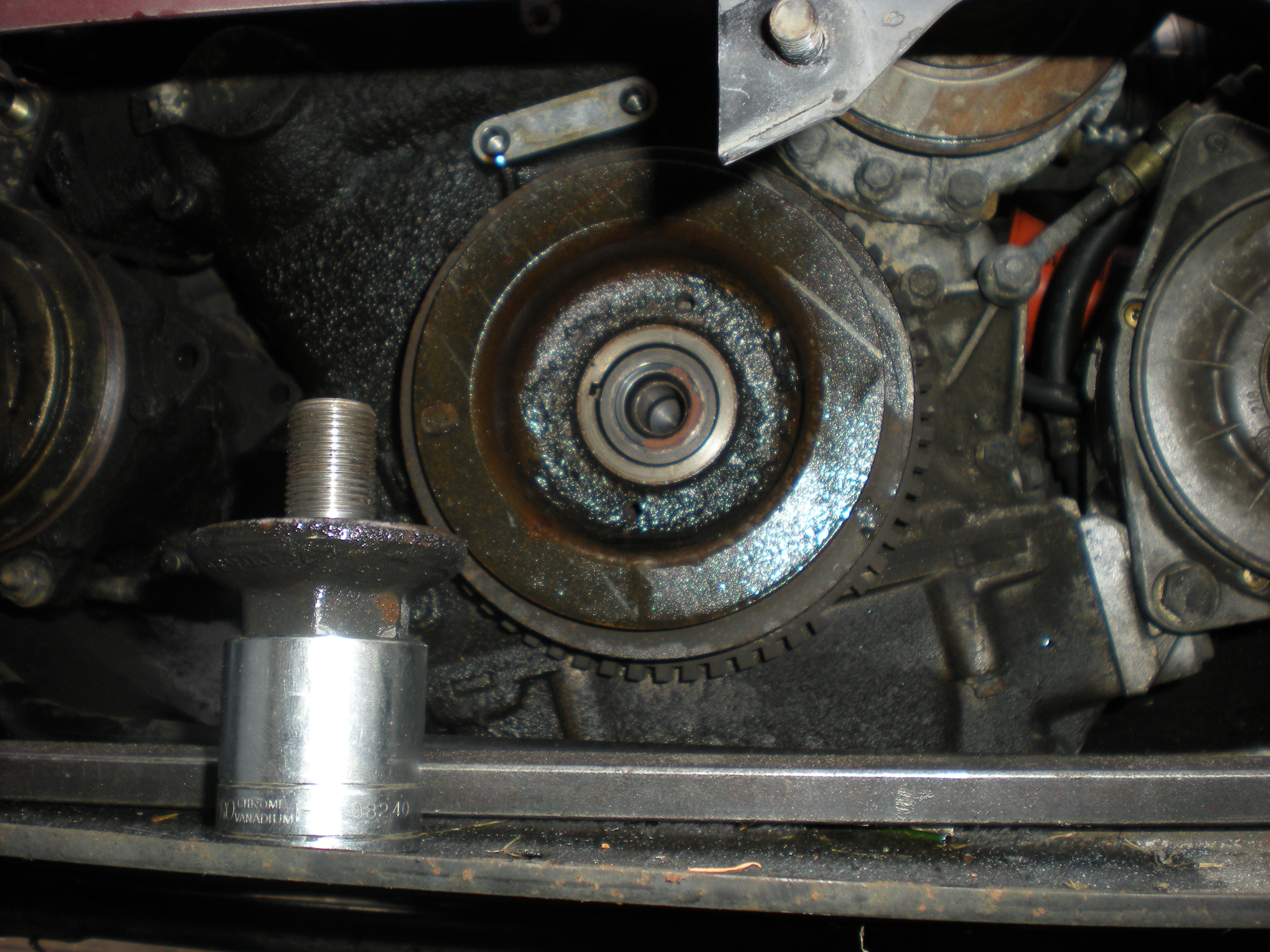

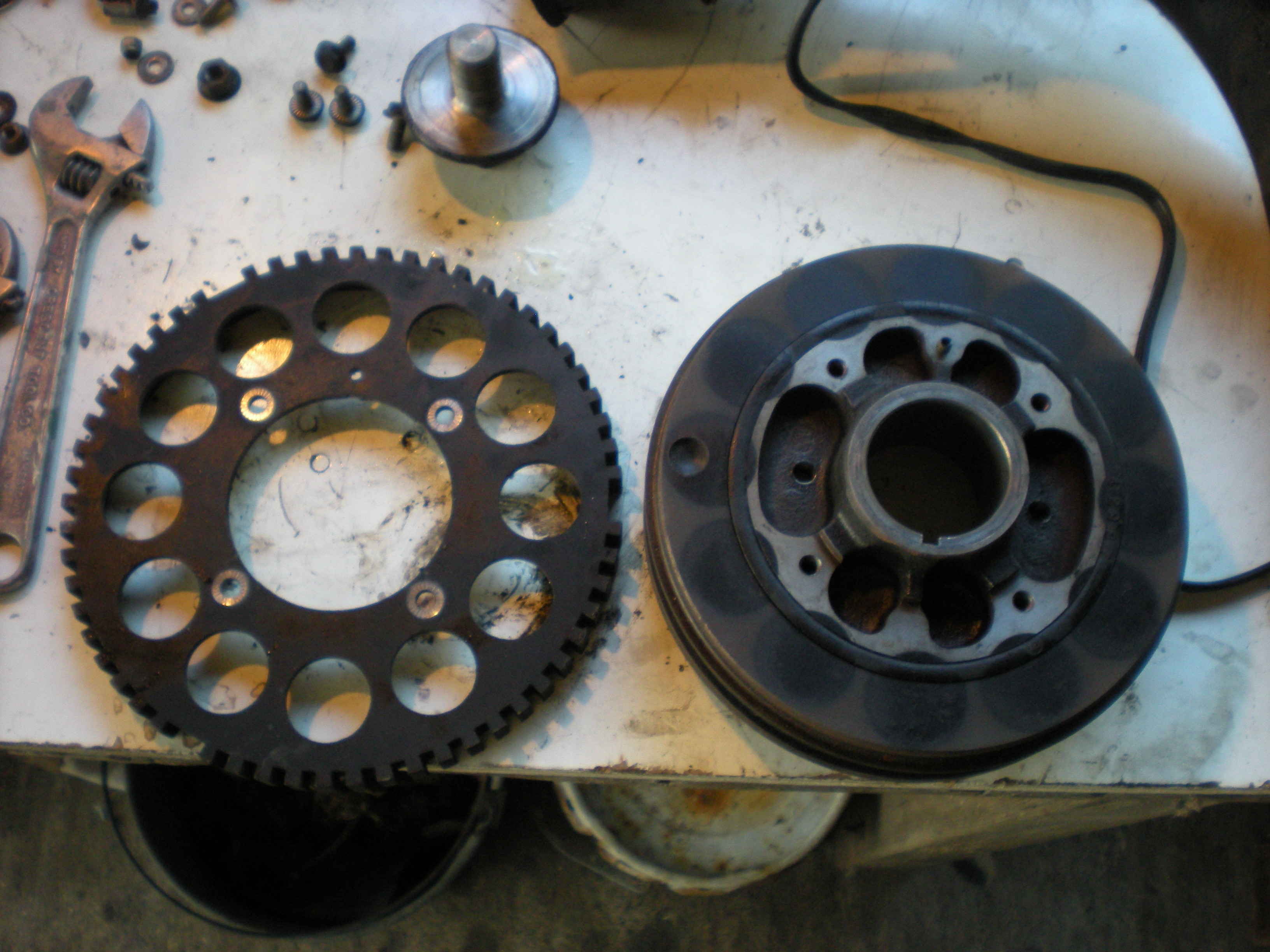

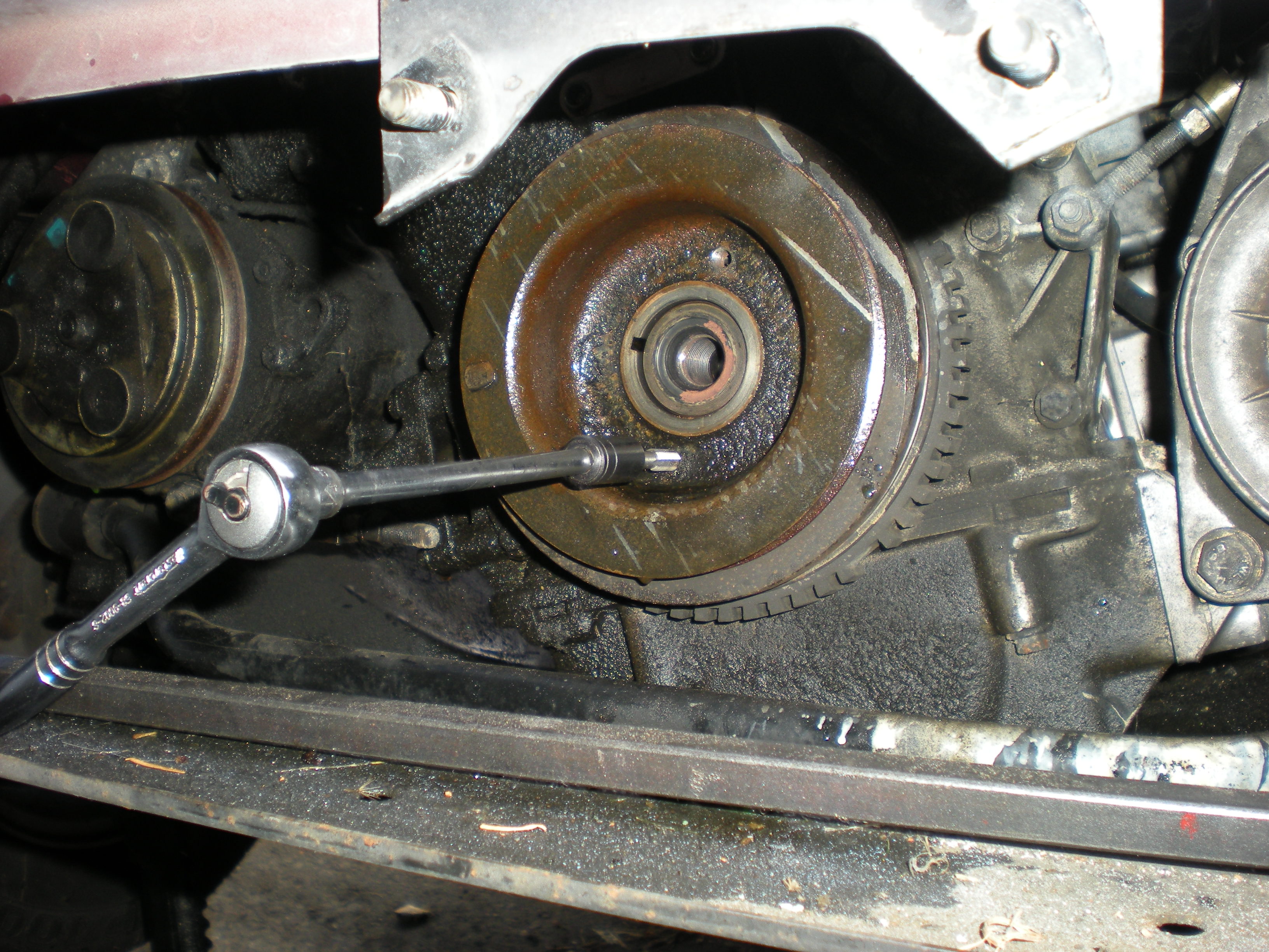

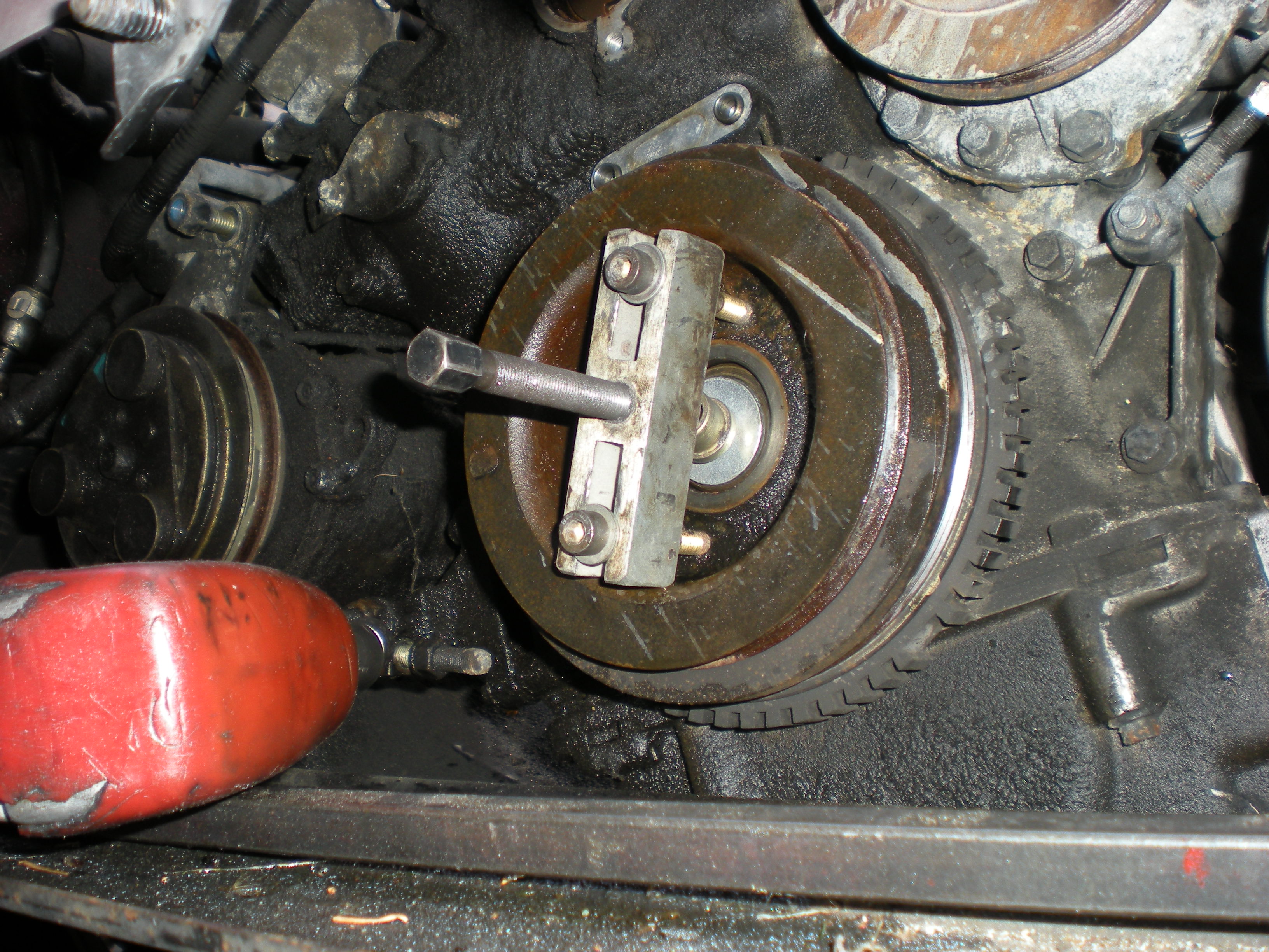

Will do Larry,and as a byline,if a fellow(or gal)were doin some thinkin,the easy way to get a little more timing out of the ign. arrangement,when you have this thing off,is to pull the locator pin on the reluctor ring,and re-drill the holes!
Tee-Heee Heee!
Getting this thing off was not too tough.1 1/4 socket will just tap on to the big screw,bang,she's off.
Tap 8mmx 1.25 pitch,to clean out the puller holes,apply puller,slow and smooth and she's off.
Beer time now.....
Cheers all,Jim.
