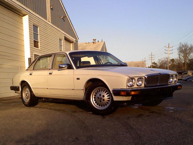

Once I get the car back to the house, I will take full shots. Before and after of the headliner, before and after I detail, etc. I just wanted to get all the mechanicals done before I do the cosmetics. I also have access to XJS mesh wheels that I might just have to install. Again, those are for the future and still need to get the car reliable first.
Oh I do have a question though. When I put the A/C on, I can hear the fan blowing but nothing is coming out of the vents, defroster, or floor. Is there some kind of diverter I need to see if its stuck?
