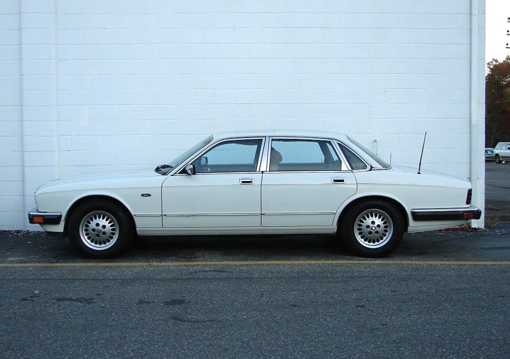

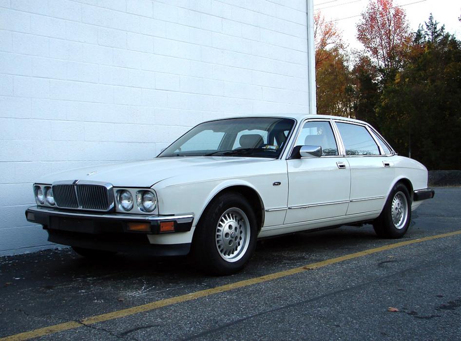

You are correct, I do want to get this car back on the road. I hate to see a car of this stature go to garbage because if owners lack on care. Also should I decide to sell it, I really want the car to be in good order so the next person has something decent. If I didn't then all I am doing it passing it from one bad owner to the next backyard mechanic that will ruin it.
Hopefully this will not cost me an arm and a leg. At $98.00 an hour, I told him to evaluate the car and let me know what it immediately needs and what can be put off or maybe something I can take care of myself. At least I know what I have.
Here are a coupe pics
Attached Thumbnails Ready to throw in the towel-1989jagxj6_dsf.jpg   Ready to throw in the towel-1989jagxj6_dside.jpg   Ready to throw in the towel-1989jagxj6_int.jpg   Ready to throw in the towel-1989jagxj6_bs.jpg
